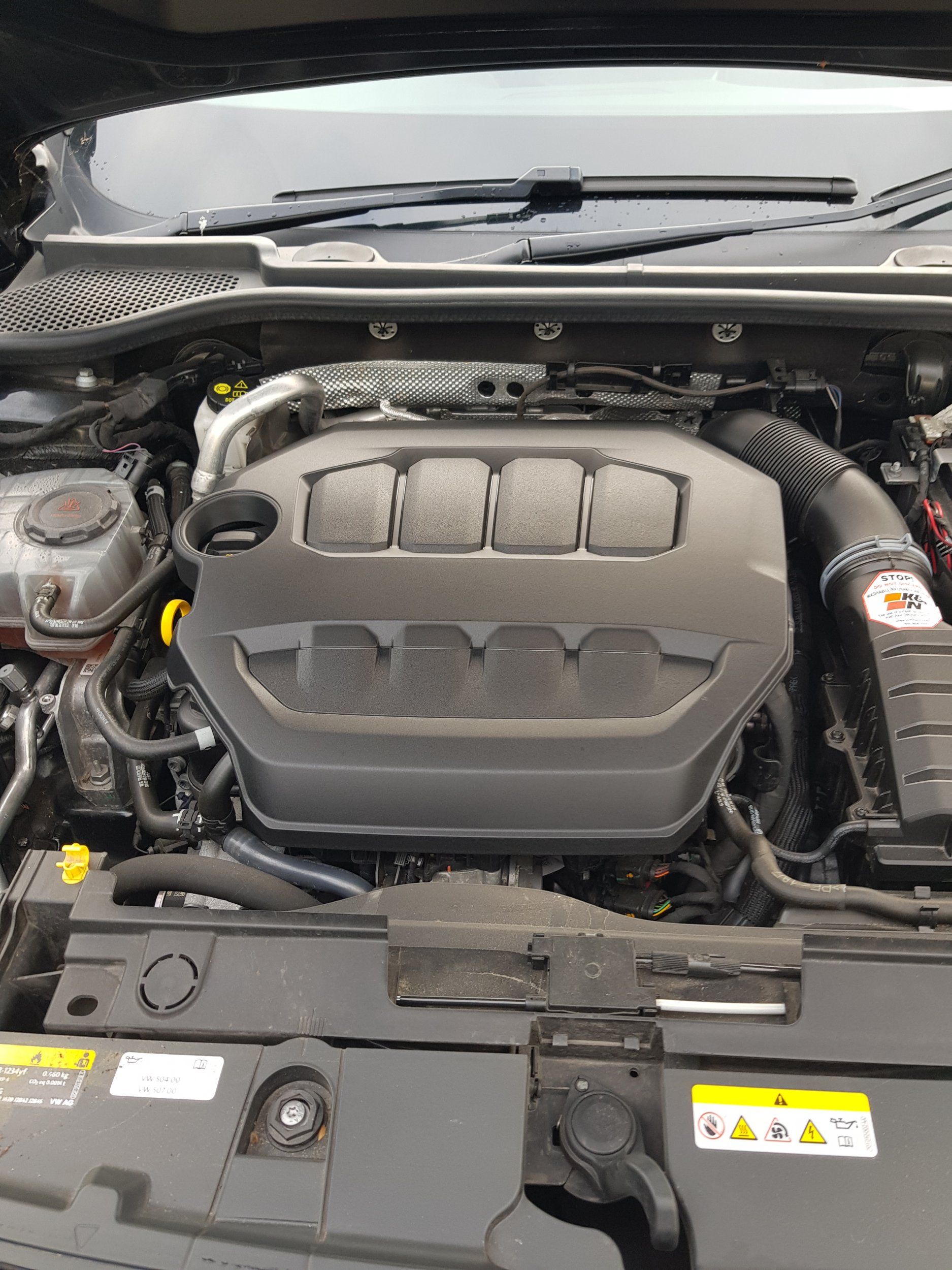

I was met initially with a "nope, haven't heard of it" so I gently guided the very helpful service chap through the history...
Cupra campaign to order engine covers to be removed in case they come loose and get set on fire by the turbo.
Ffwd to now 5996 engine covers in stock - Cupra Campaign to put revised engine covers back on.
  • part number 06Q103925L (for engines with power output less than 180kw) is a foam type cover with reinforced mounting points
  • part number 06Q103925N (for engines with power output 180kw or more) is a hard plastic cover.
Ask for a second opinion from another dealer.
And Hey Presto - Your engine bay could look like mine 😁 in a week or two 😉

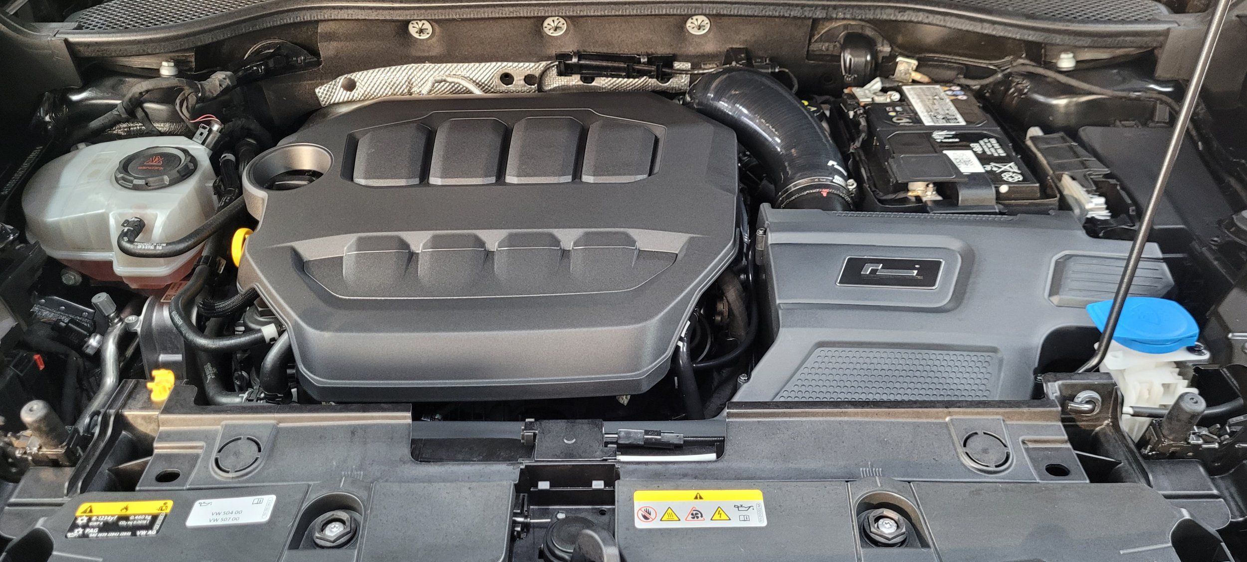

I got my engine cover fitted today. No paperwork needed only had to return the old cover which I had removed. The part number for my year 2021 VZ3 310 is 06Q103925N. Now the engine bay looks proper.

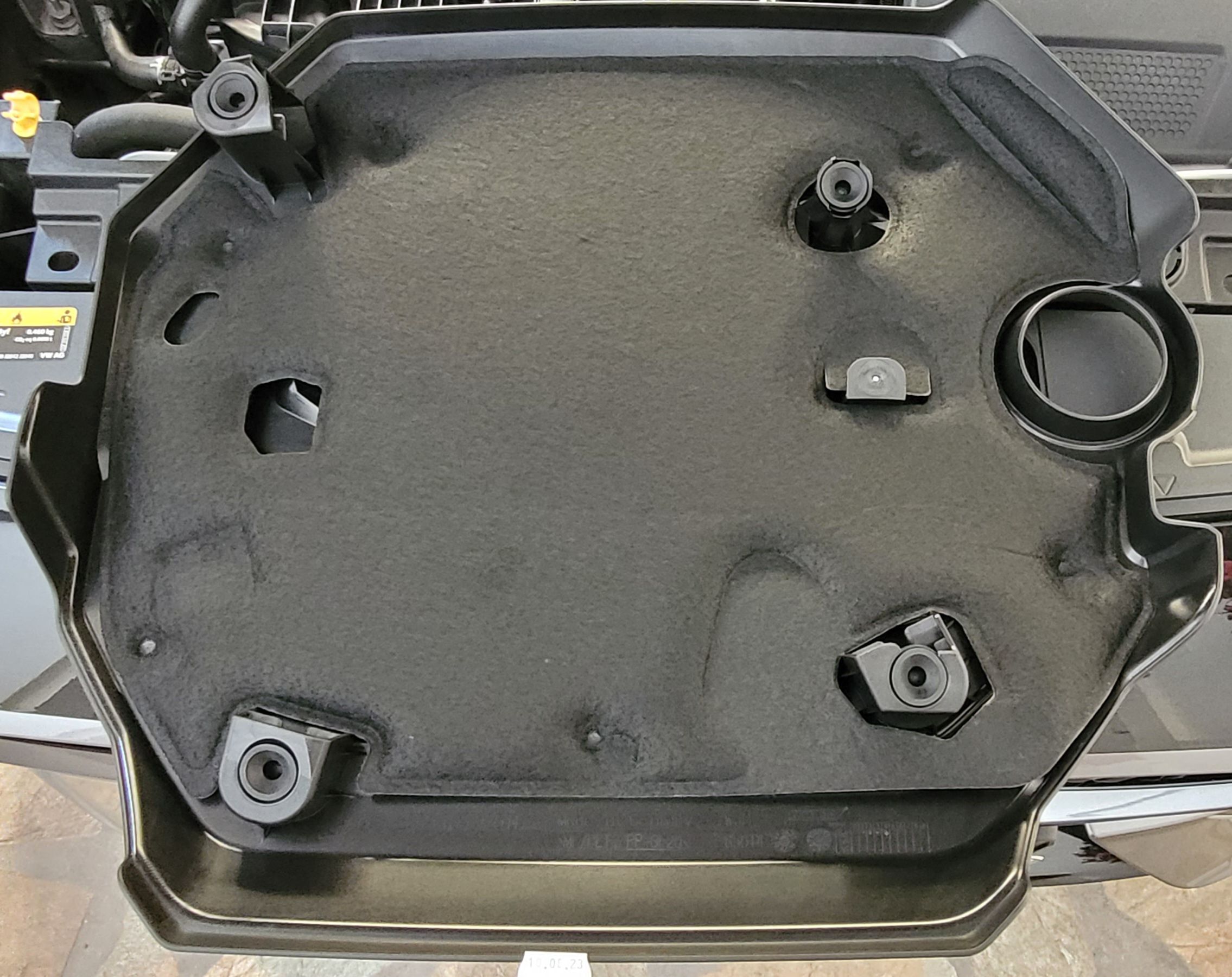

Yes, the cover just clicks on. It is a matter of seconds. The whole process took 40 minutes in my case which involved their bureaucracy and, happy to say, a dealer approved engine wash at no extra cost.
The new cover for the VZ310 is hard plastic with soft insulation material underneath; looks exactly the same with the old one but is is not; material and connection points are totally different.
