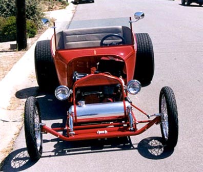

i'm sticking a v8 Merc/Bmw (whatever i find first) in one of these
so ANYthing is possible

:-o You crazy :censored: ! - that looks like a gokart i used to own when i was 8... only lighter!
Car heavier than engine = minimum of intensive care
been there done that :) and still have the wristband with my name and blood type :whistle:
just to add considering costs of cossie bits nowadays i'd personally rather tune up a vag motor as it makes bolting in and adaptation a lot easier and saves designing/building a chassis (headache alone i can assure you)
not saying not to as it would be great fun but note seriously its no bolt together weekend job thats for sure and if you can list 101 different problems and situations to get round keep a spare sheet as it will double for sure by the end
