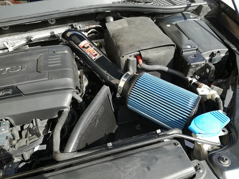

Injen ram air open intake installed. Efect is almoust like BOV, turbo spooling, whoosh...it makes me giggle like a 5 year old girl... :D The filter is quite huge, install took me about half an hour. Most difficult part was the access the OEM clamp bolt on turbo side.

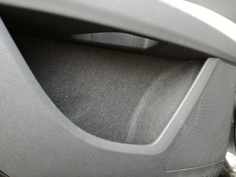

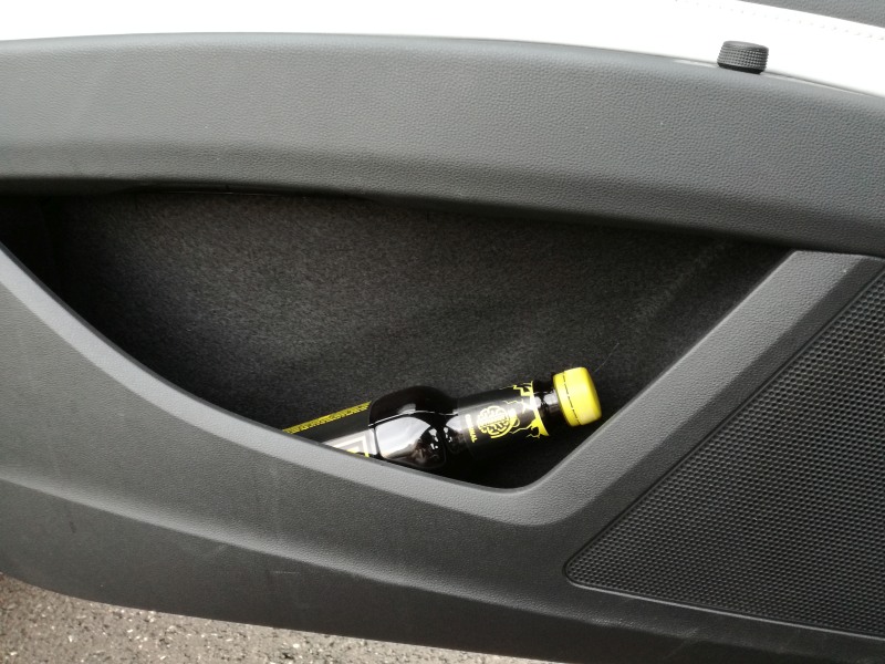

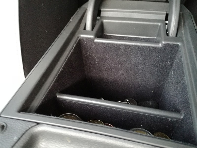

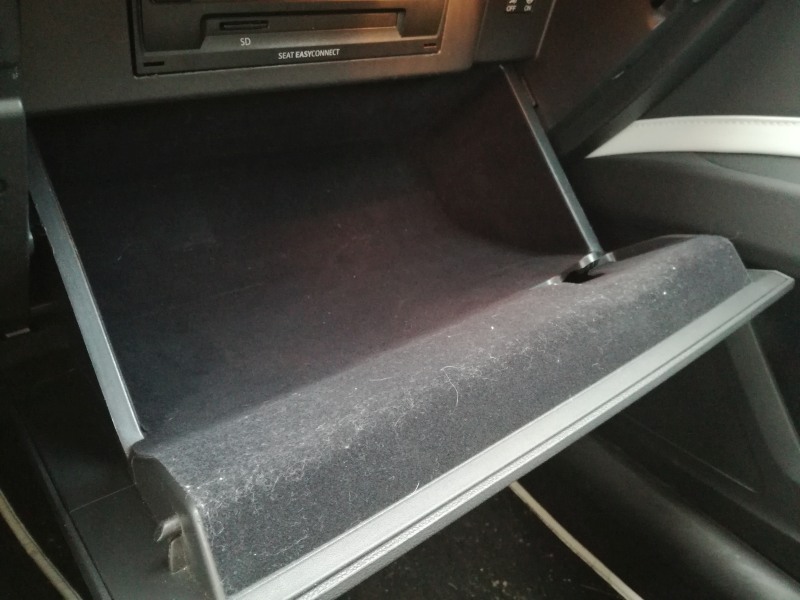

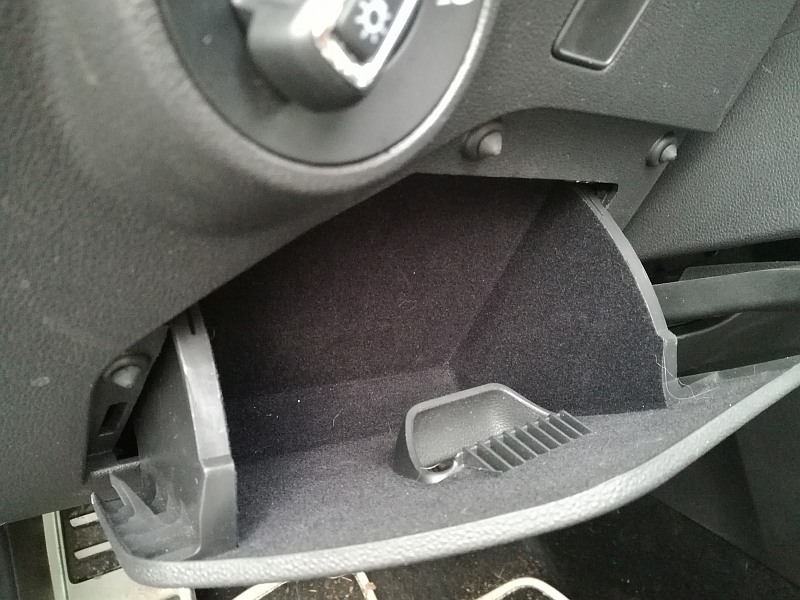

Few weeks ago the compartments padding kit arrived from Turkey ([email protected]). A friend found them on the Instagram. Padding kit costs 40€ (shipping included), frond and rear doors (thicker material), glove compartment, arm rest pockets, some small things in cup holders and small compartment under the left side light switch. The material is something like velvet, with adhesive. Stick it wrong, then can remove it and replace the same part. Precut pieces with some visual manuals + instructional videos on the net. Some pictures:

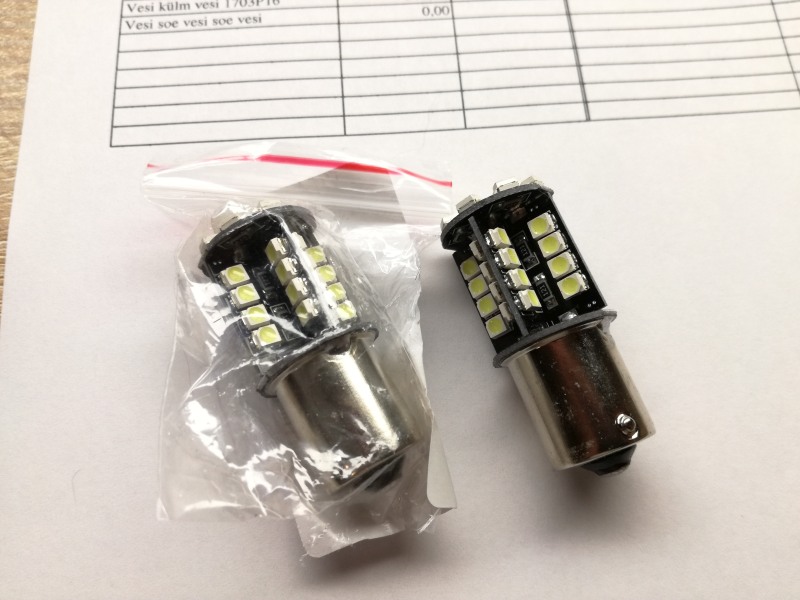

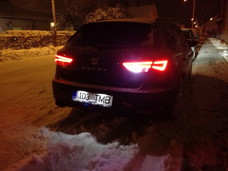

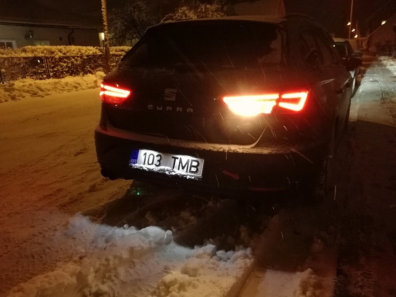

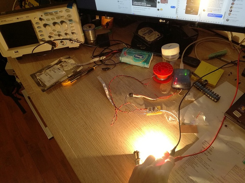

Yesterday replaced reverse light with LED...I really do not know what was I expecting. The original is 21W pulb, replaced by under 2W LED. Light amount is about the same, if not less. Color temperature is whiter, colder, suits better. No canbus error. For color change they are okay, for extra lighting they are useless: https://www.ebay.com/itm/P21W-382-B...var=591055800017&_trksid=p2060353.m2749.l2649
LED's:
Pulb:
LED:
Pulb on desk (~20W)
LED on desk (under 2W)
Probably should try something like that: https://www.ebay.com/itm/Canbus-Err...ash=item25d2d9c426:g:e84AAOSwXYtY2gDG&vxp=mtr
Also thought that maybe remove the other side "rear mist light" orange glass inside and add 2 more powerful LED-s on both side, parallel them and use dual reverse light loosing the "rear mist light" that seems so useless compared to the LED rear led strips in original.

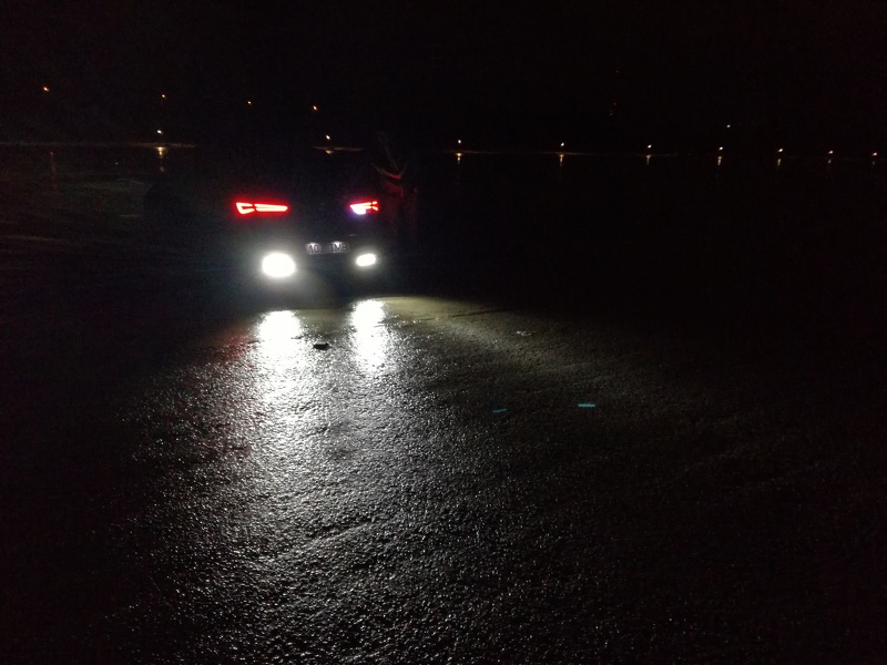

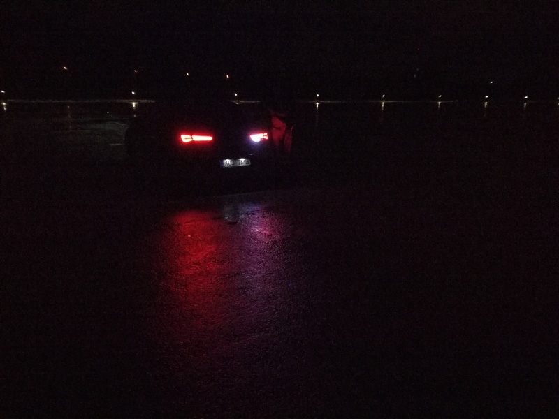

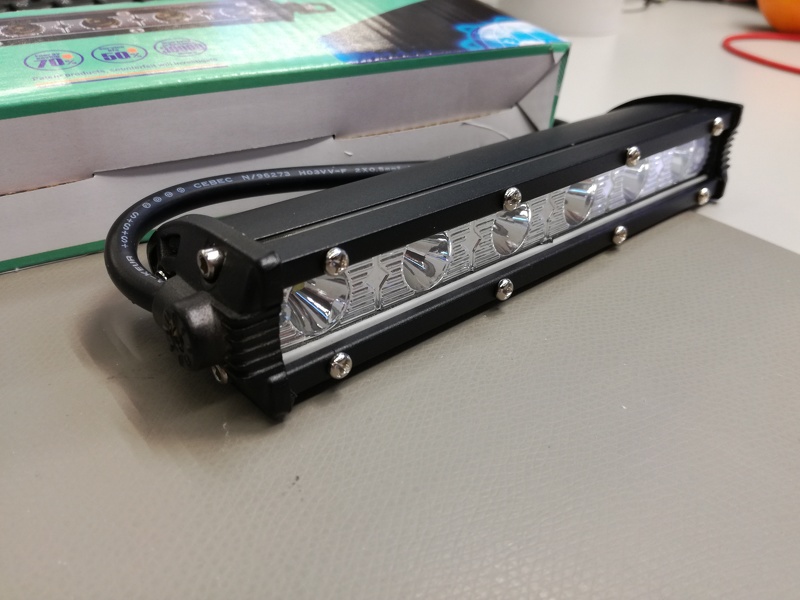

Since we really have here in Estonia dark wintertime then I decided to add some extra reverse lights. Firstly bought the suggested LED light to replace original reverse pulb as previos post. Since it did nothing to help I bought another set of LEDbars. Quite cheap, about 30€ for 2pcs inc. shipping. they seems quite nice. Advertised as 18W, actually about 12W per unit. Here are some pics + light comparison pictures LED in original place VS those LEDbars. They are not fitted yet.
Ebay: https://www.ebay.com/itm/18W-LED-Wo...e=STRK:MEBIDX:IT&_trksid=p2060353.m2749.l2649

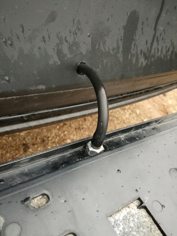

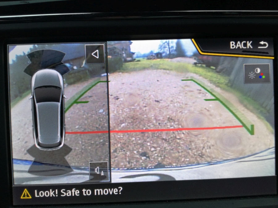

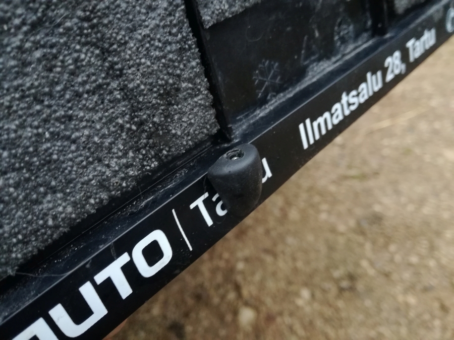

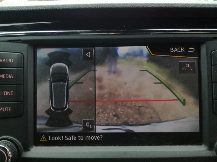

New nice feature installed - reversing camera washing nozzle. Works in parallel with rear washing system, probably will add rear wiper disable function while reverse light on (1 relay or so).
before
after
Cheapest mod I have done so far. Few meters of hose, 1 spray nozzle, 1 3-way plastic divider to take the liquid from the original rear window washer. Few zipties, 2 holes later.. in total some 10-15€.
Nozzle is bolted to the licence plate holder
There were some small angle problems, the nozzle missed the cam about 1-2cm, had to "heat treat" the licence plate plastic.
Video to illustrate the water pressure and working progress: https://www.youtube.com/watch?v=HDSmIyNMJBA

Also have playing with Canny 7 module, learning car CAN bus system. Ordered 360degrees parking camera kit, cameras needs to be installed, but main problem is currently how to tell the MIB II (over canbus) to go into the reverse camera mode on my command to use the camera system driving forward.

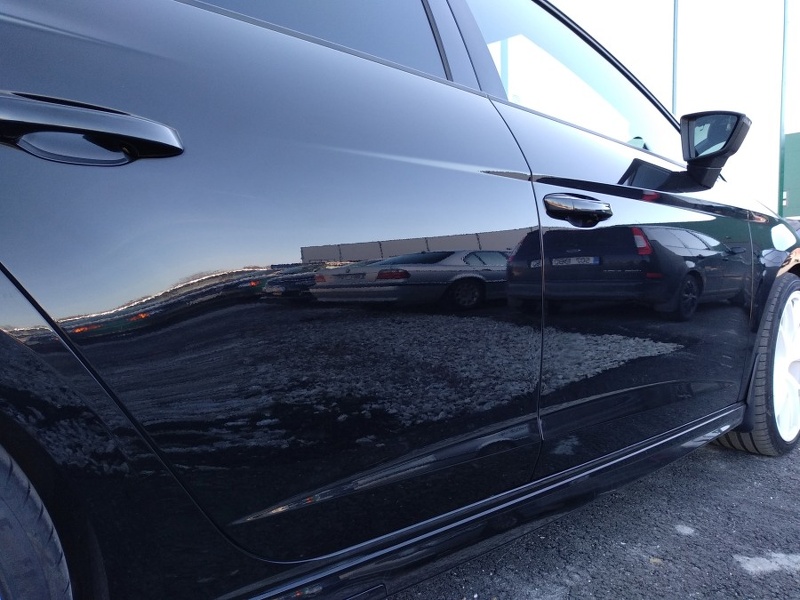

Last week the car got covered wit ceramic paint protector. It looks quite shiney and reflective. Should have done also the polishing, but..yeah... some pics here.

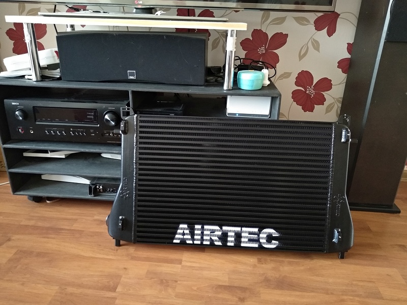

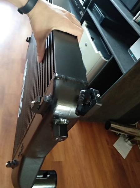

New Airtec intercooler arrived. Let's hope to get it installed soon :p
This will possibly break the 300kW/400hp barrier.
