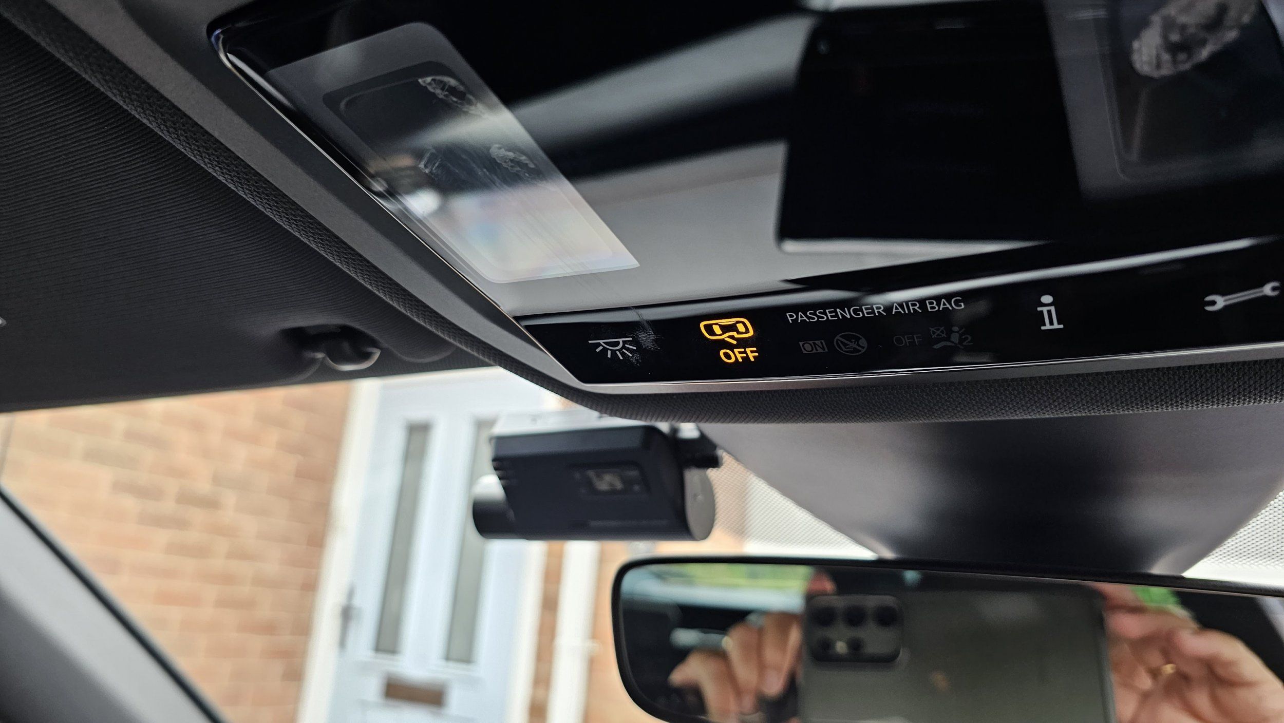

You mean this right?
That means the interior lights have been switched off manually. Press it and if the car door is open the interior lights will come on and the orange car light will go out. Press it again and the interior lights should go out and the orange car and OFF will light up orange.
Yes I know that. I mean that usually after the car is closed, this indicator goes out, but now, when the car is charging, it is constantly on and never turns off.

I've just checked mine and the only light on is the orange triangle in the dash and of course the green charging light next to the charging cable. Interior lights are selected to come on when I open the door though.
So, I've been in the car and switched off the interior lights and locked the doors. Checked back after 10 minutes and yes the orange car light in the roof is on along with the orange triangle symbol. I stopped the charging (as I've set a departure time for tomorrow) and both lights went out.
I guess you must have the interior lights switched off. Strange that it lights up when charging though, but looks like it's normal for these cars.

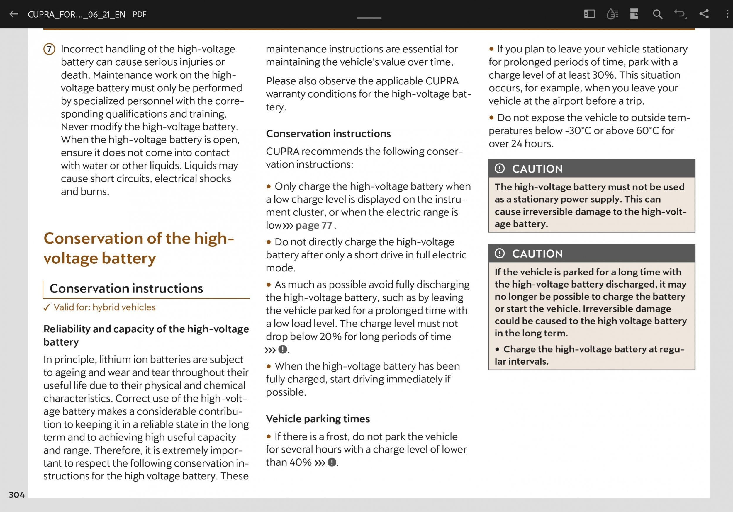

I tend to set departure times and charge just before I go out. The high voltage battery has a good warranty on it but I've heard that leaving it fully charged stresses it. I don't drive it every day so I don't charge it straight away. There is a section in the manual about looking after the HV battery.
