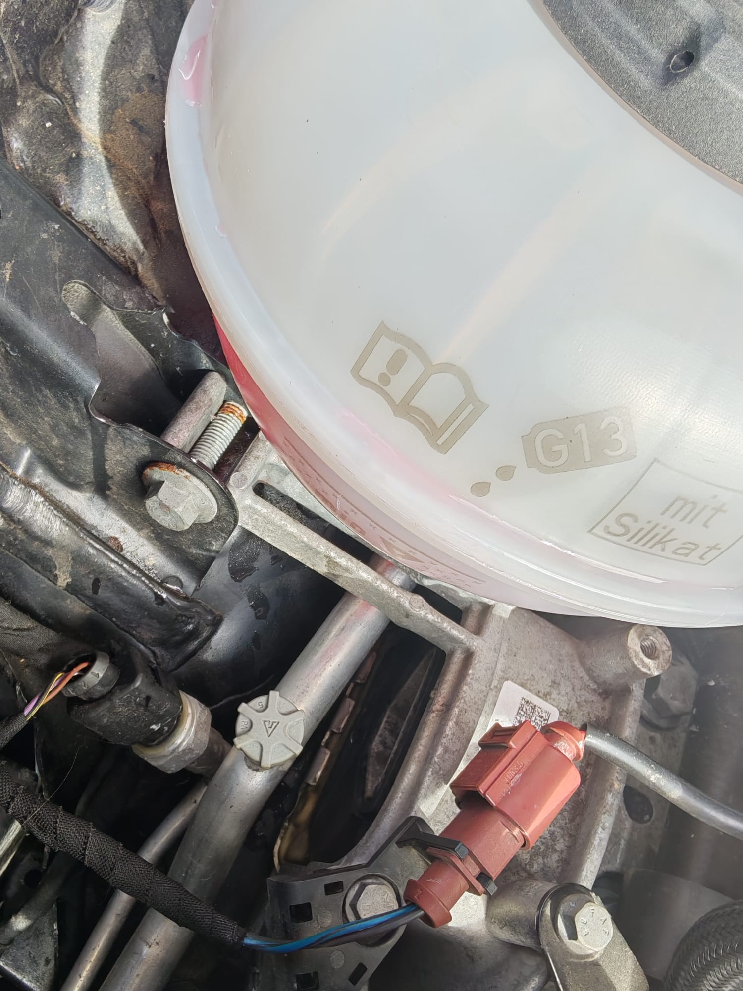

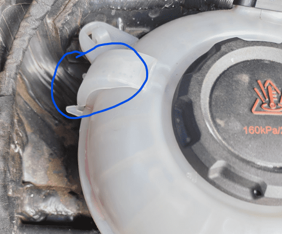

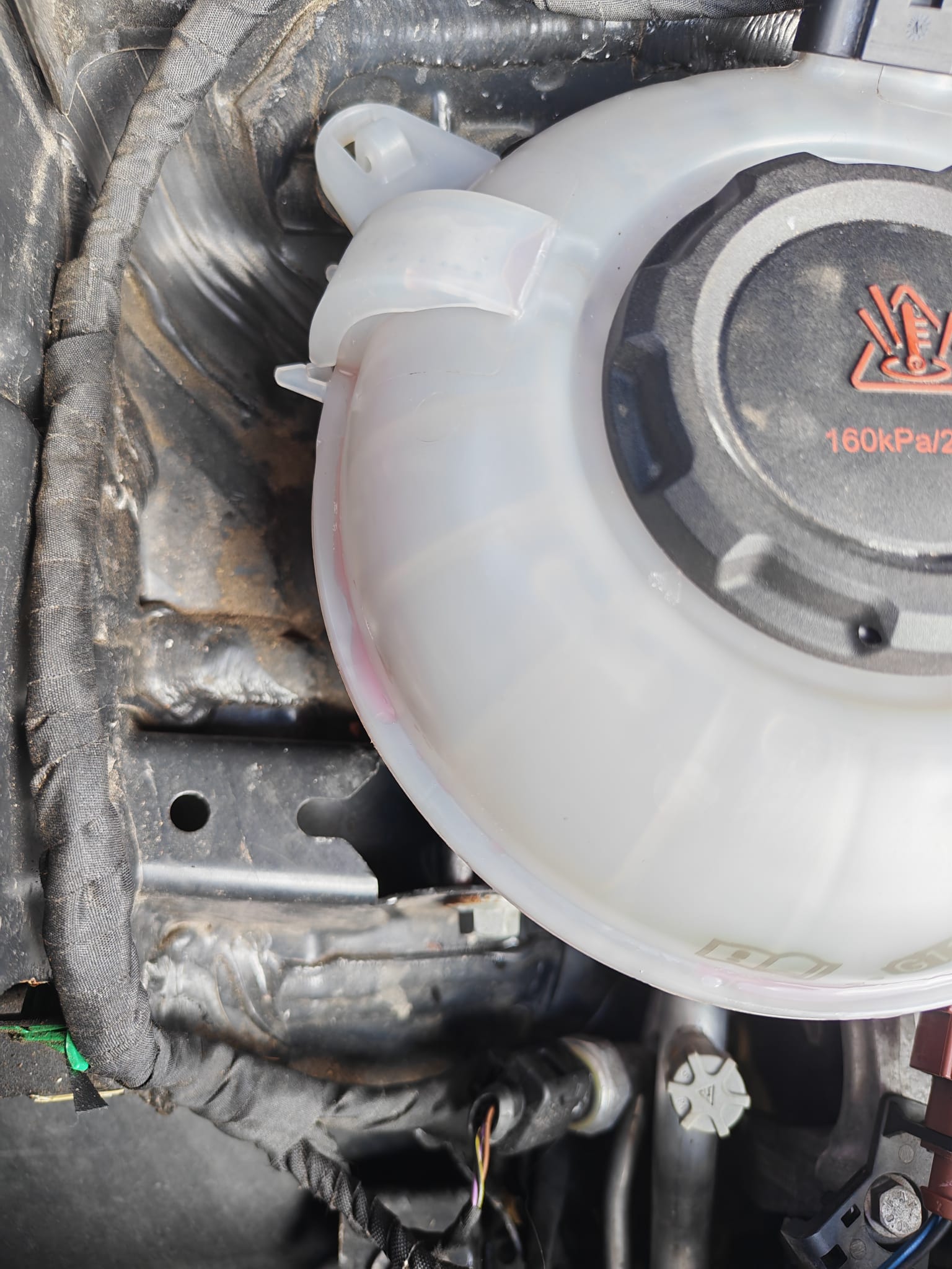

How old is the coolant cap? Replace it with a new one would be my advice. In the end its a mechanical component (spring loaded).
My cap was weak when I tested it, when I was fault finding ultimayle having matrix issues - it leaked at around 10-12psi from memory vs the rated 24psi.
This blue circle is the overflow - If the system over pressurises and the cap vents, any coolant should vent out this spout. I would see a puddle of coolant on the metal work below this spout.
When my matrix was partially blocked - I would only get heating on one side, as the blocked area of the matrix had no coolant flow so no heat flowing. The cabin heating is divided into two areas direcly on top of the matrix which is why you would only get half heating in the cabin if your matrix is partially blocked. You could get the same effect with an air lock - but normally this would resolve its self over seveal weeks.
The heater matrix in on its own mirco cooling circuit with the EGR cooler with its own electric pump, during and after a DPF regen there is a hugh amount of heat dumping into the cooling system - a restriction in the matrix and the mirco circuit causes local boiling and over presurisation which for me would go from full to min on the header tank in one event.
It's not unheard of for the main coolant pump to leak - obviously would be an external leak, you might see dried coolant residue on the underside of the engine on cambelt end.
Don't think of the money you have spent as a waste - it is unfortunatly needed to try to diaganose a complicated issue. Modern cooling systems are very/too complicated!
