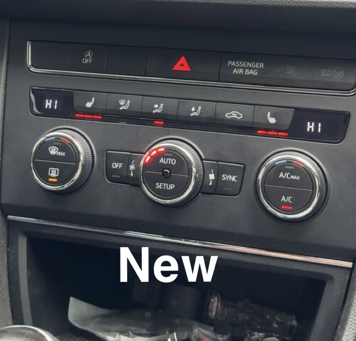

Ok so, managed to do it and from my testing it works!
Still need to test it more but it does direct air where it’s supposed to go. (Floor vents, front vents and windscreen vents), the temp control works great and fan speed is bang on.
However, of course dual zone does not work and that would be an absolute nightmare to get to work as I need to rip the dash apart.
Now I don’t know what coding is required but from what I’ve tested so far everything seems to working as it should, so if anyone has any suggestions on this it would be appreciated!
It’s pretty much plug and play all I had to do was purchase was the climatronic harness which I got from Ali express. (£12)
htt ps://a.aliexpress.com/_Eynv029
Plug that into the stock harness and the other end into the new climate control part.
Now from what I’ve researched you are able to get auto to work, all you need is a two temp sensors and install the pins from that into the same harness. Will update once I get onto that.

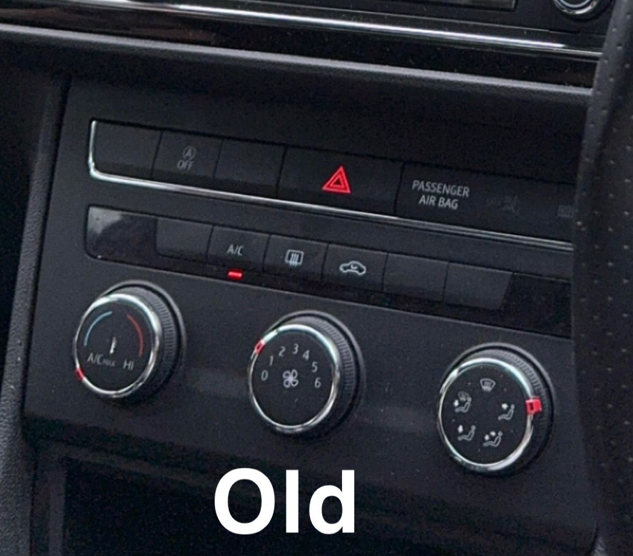

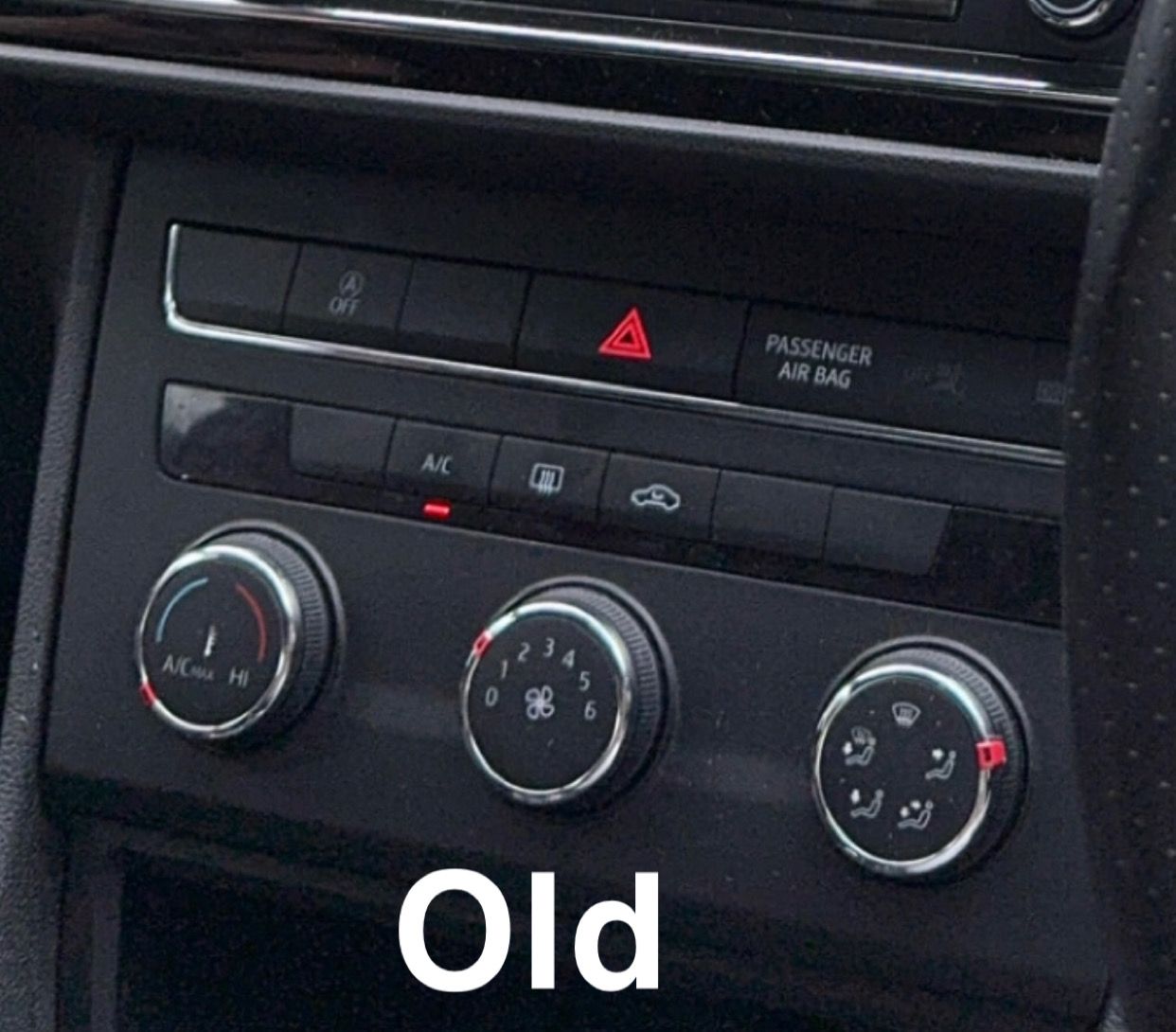

I’ve attached some pictures of the old vs new one. ?
Ignore the heated seats, they obviously don’t work as I don’t have them installed, light turns off after a couple seconds
