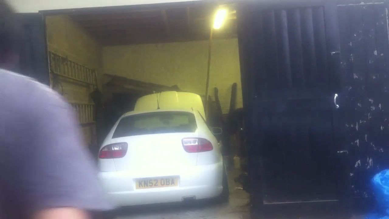

I made a video/sound clip of me putting it in the garage, exciting stuff, but you get a good grasp of how it sounds. Enjoy.
https://www.youtube.com/watch?v=3idxWCyyNgk&list=UUrWRl91I9Li-HwIgWRc2Yjw
EDIT: Video/soundclip of the drive. https://www.youtube.com/watch?v=idnduAgPYlI&list=UUrWRl91I9Li-HwIgWRc2Yjw
