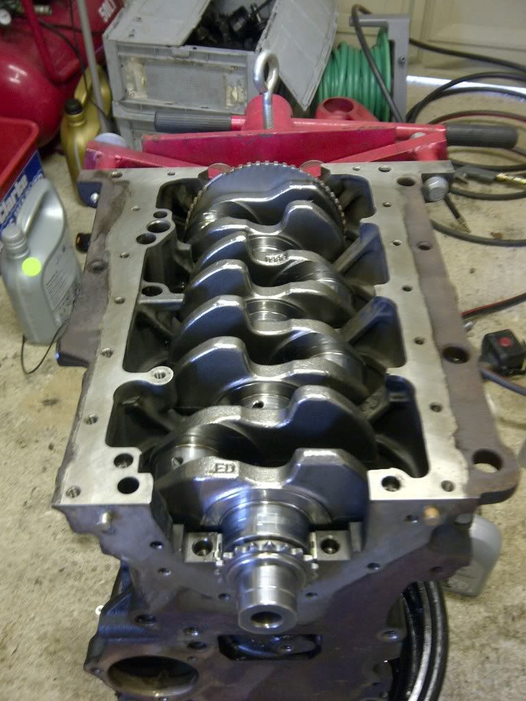

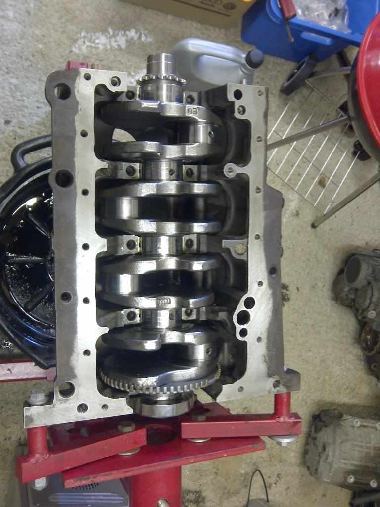

Hello Everbody,
Sorry for the lack of updates, but been mega busy doing other bits and pieces and waiting on parts etc from USA!

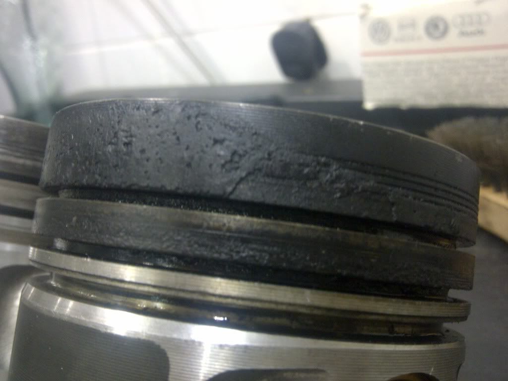

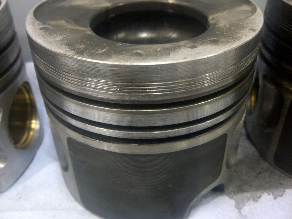

I have prepared the block which consisted of honing the bores and checking ovality, would have been nice to go for a .5mm overbore and fit a set of parallel rods to match but money is tight with racing and all.
So I have stuck with stock pistons which I have cleaned up and fitted new rings. Interesting to find that even on a 60,000 mile old piston the rings were pinched in the ring deck from a build up of carbon, no wonder these engines start to wear bores out quickly as they age; the rings are seized in the pistons and just shave the bore away.
The photos below show a piston before and after cleaning and also the Race Developments finished crankshaft sat in the block on new bearings.
Let me know what you guys think!!

Unfortunately I dont have my pd leon now but when I did have the car I had the head off at 157k and there was no bore wear or ring issue you speak of.
