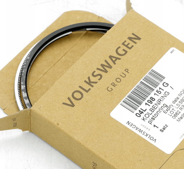

Looking more into this -
I think this might also apply to our engines:
Seems Volvo have acknowledged this and changed the design - but I can't see any new part numbers for us?
Diesel piston ring set 04L198151 ring set:

Did you just have new rings or new pistons as well?
I only had time to have a quick look at the old piston rings when I popped down to the garage to see how the rebuild was coming along. And from what I saw the original rings in the video you posted looked like my originals. And the new rings looked more like the wavy bit of metal sandwiched between to thinner rings.
Giving way bigger holes to allow oil to pass back through the hole in the piston into the sump.
I only had piston rings and valve stem seals replaced. They cleaned up and pistons, had them inspected and measured and were all OK to reuse.
