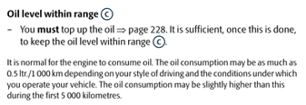

2013 Leon 1.2 TSI - using a lot of oil. I had the car looked at by a specialist who claimed 1 ltr per 600 miles (!don't know what to make of that!) was allowable under the SEAT regs.

That's worse than the 'acceptable' limit from VAG/Seat. (which in my book is not acceptable and still be too much)
They quote 0.5L per 1000km/600 miles.
