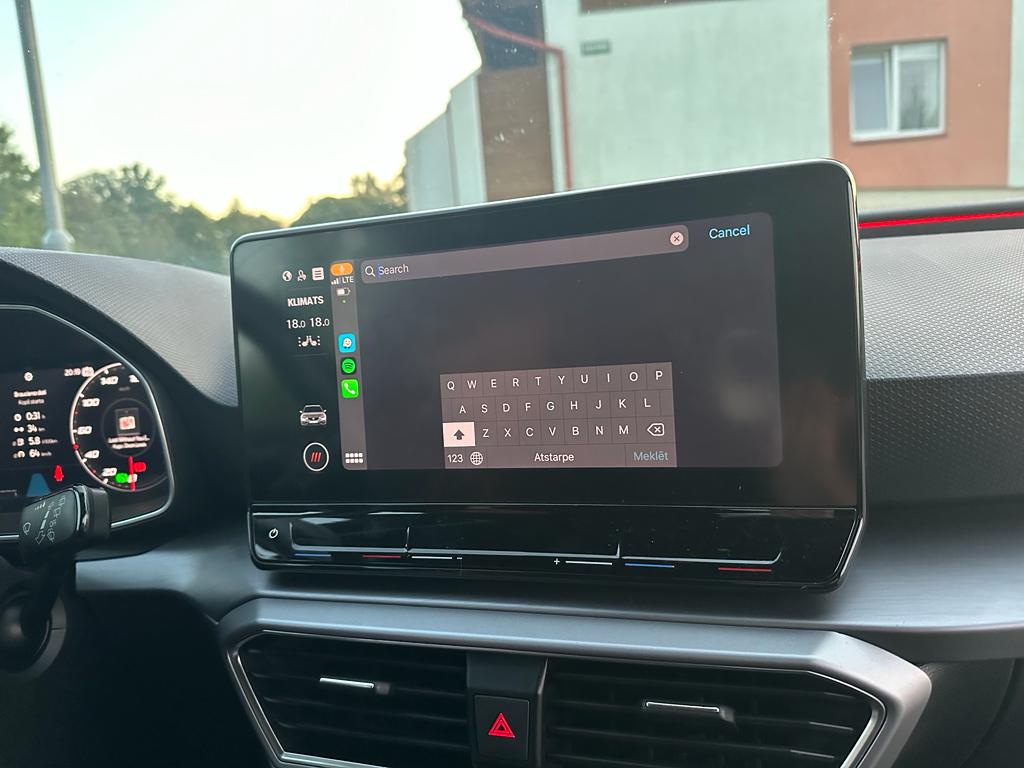

1. After update to 1940
2. before an update
Hey guys. Does anyone else got this weird view for apple carplay after update to 1940? Is there any chance to get it back as it was before in 2nd picture.
Aug 31, 2023
Spain
The update changes the dpi to a higher one, yes, hence everything is scaled down. I am actually very relieved that it is this way now, since it shows more information at it is not all bunched up like before.
Answering your question, I don’t think there is a way to change it back. You might have to get used to it.
