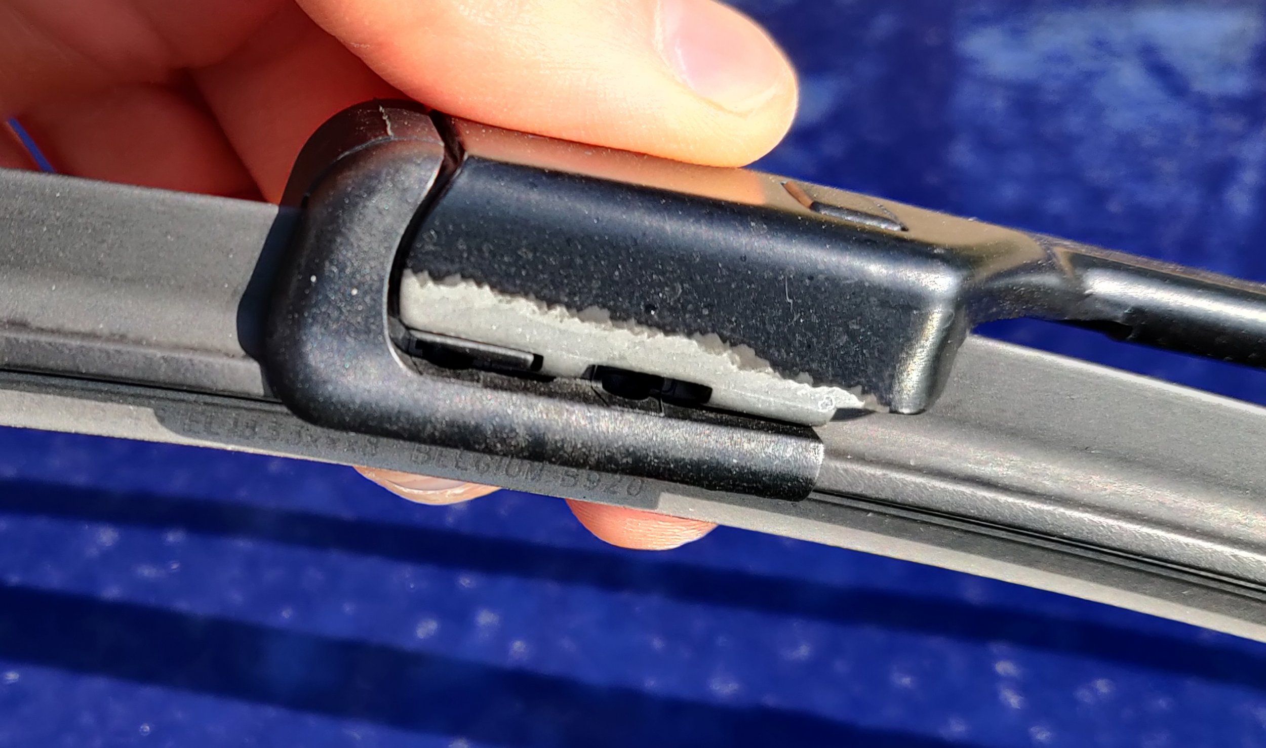

Hi,
Newbie here. I thought this might be the best place to ask for some advice. I got a Leon Cupra 300 last year, love it to bits but I've noticed some of the paint has started peeling off the Wipers on the passenger side. I didn't notice it when I bought it, though I think it must have always been there.
Its not worth the cost of a new wiper arm (Unless scrap yard maybe, not sure of cost) but I was wondering what paint I could/should use just to touch it up a bit. Whilst I know it won't look like a Pro job, it would improve it to how it looks now.
I dont know what kind of paint to use on that metal, any old black paint do? Any advice welcome and I've attached a picture of it so you can see.
Thanks in advance,
Jim

In Sweden we don't have the same brands as you, but I would take any matt black from a brand you know in a spray can. You don't need to spray it, just spray a little on the lid, (let it dry then it will be thicker) and brush on if it feels better.
Don't buy "Dip vinyl colour" since it's more for temporary use.

How about using a Satin Black, Hammerite sell that and just carefully brush paint it using many coats of as little paint as you can - or just buy a spray can version of any Satin Black, most of these black painted parts have a satin finish and not gloss - in my mind gloss would make it look a bit nasty.

The same issue on our 2018 ST. I've got a rattlecan of satin black in the garage; just not had a chance to do it. For a proper job the wiper arms need to come off.

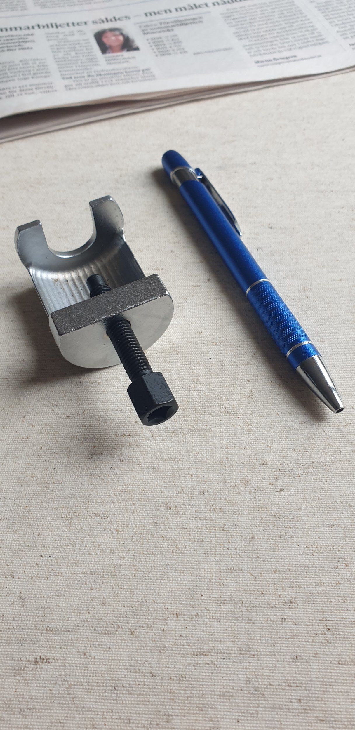

Probably best to get your self a small puller if you don't already have one - wiper arms can often need a bit of help pulling them off.
Something like this:

It's not hard - if you have one of the small cheap pullers mentioned above.
There is no where sturdy to lever using screwdrivers if it won't pull off by hand - you could take the nut off and give it a wiggle to see it it will come off? if not get the puller.
They are on a splined shaft and can be a little tight with years of corrosion.
Getting it back on is easy as the nut pulls it down - just need to make sure its aligned correctly.
