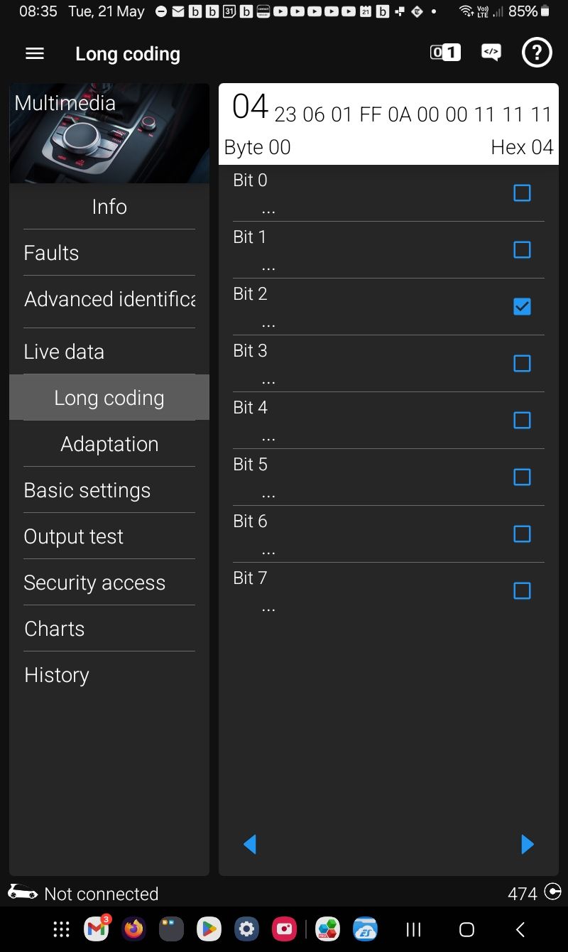

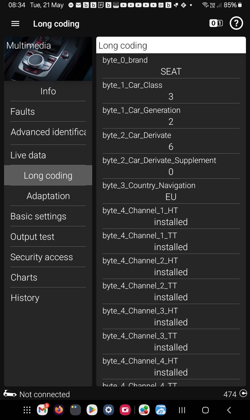

The secret is in the long string of the 5f unit. I think that is what we are talking about. So you get someone elses long string and compare with yours. Obdeleven Pro parses that long string by toggling 0-1. You may get text on it. Then look at the differences. Some may be specific to your car others may not be. The long string is the representation of what you are coding. Each unit has one.
Those long strings are published on the Spanish site but you will find them else. The address map or admap. If it isn't in the long string then Adaptations. They are the common ones. I believe the results of those get dumped into the long string.
There is a Leon 3 Obdeleven I think coding thread on this board or ask / check the general one. It's a question of lining up your string against a similar one and checking the differences and looking at the parsed text 0-1 in Obdeleven. You can do that offline.
Recommend you ask someone with the same car to see their long string or you hunt it down on the net then study it. If it isn't the 5f long string it will be in one of the other units. Depends whether anything got changed in any of those or needs to be.

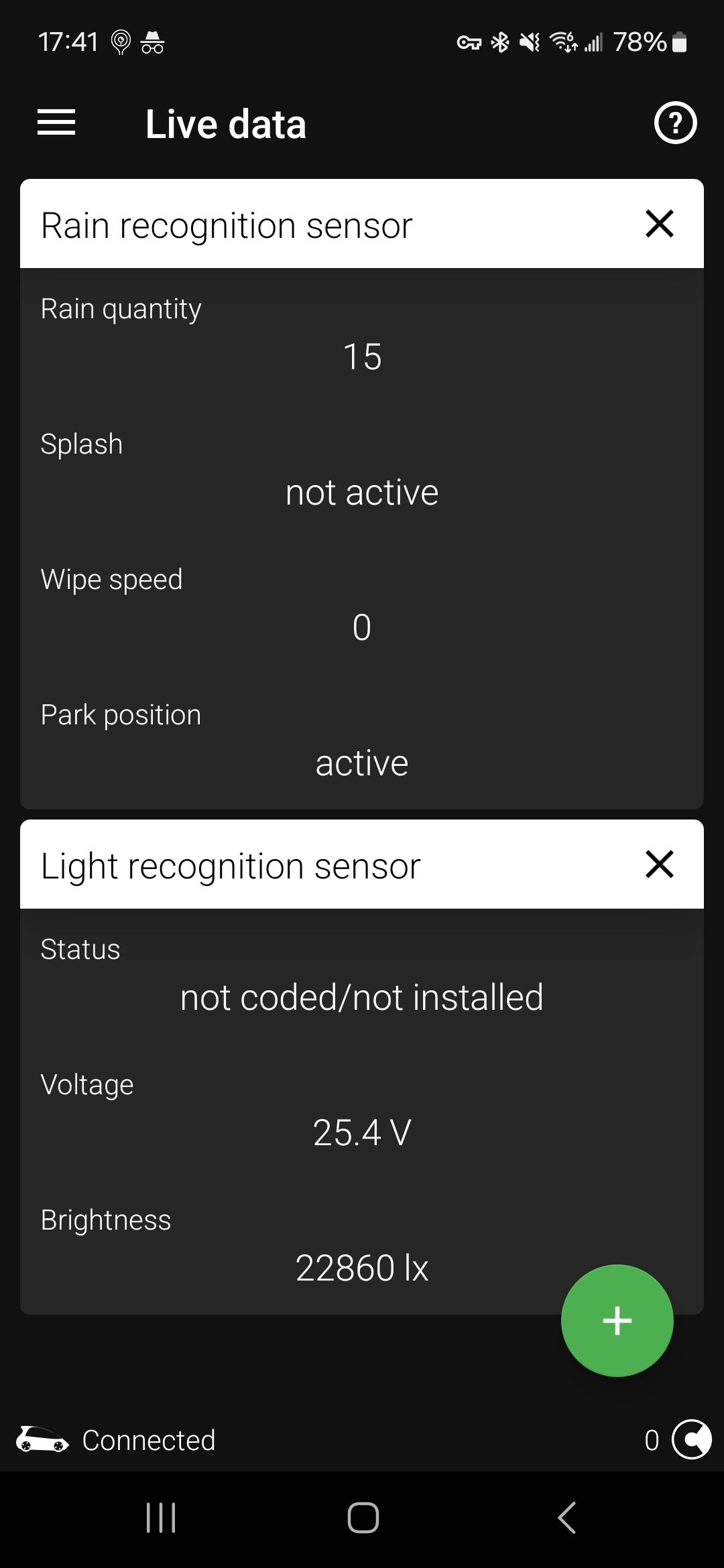

Just tried the live data and its showing this... although maybe im looking at the wrong thing as my auto lights work fine.
