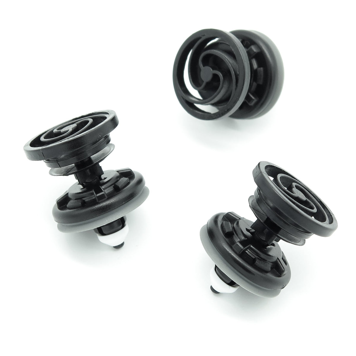

I will never remove a VW/SEAT/AUDI/SKODA door card without a pack of new clips in my tool box.
At £6.29 for 20 - it is not worth risking how many will get broken in the process
Those must be the only trim clips I do not have! Why are there so many kinds? Wouldn't a couple of different ones done the job?
And none of the Youtube videos that I watched mentioned needing to buy them!
