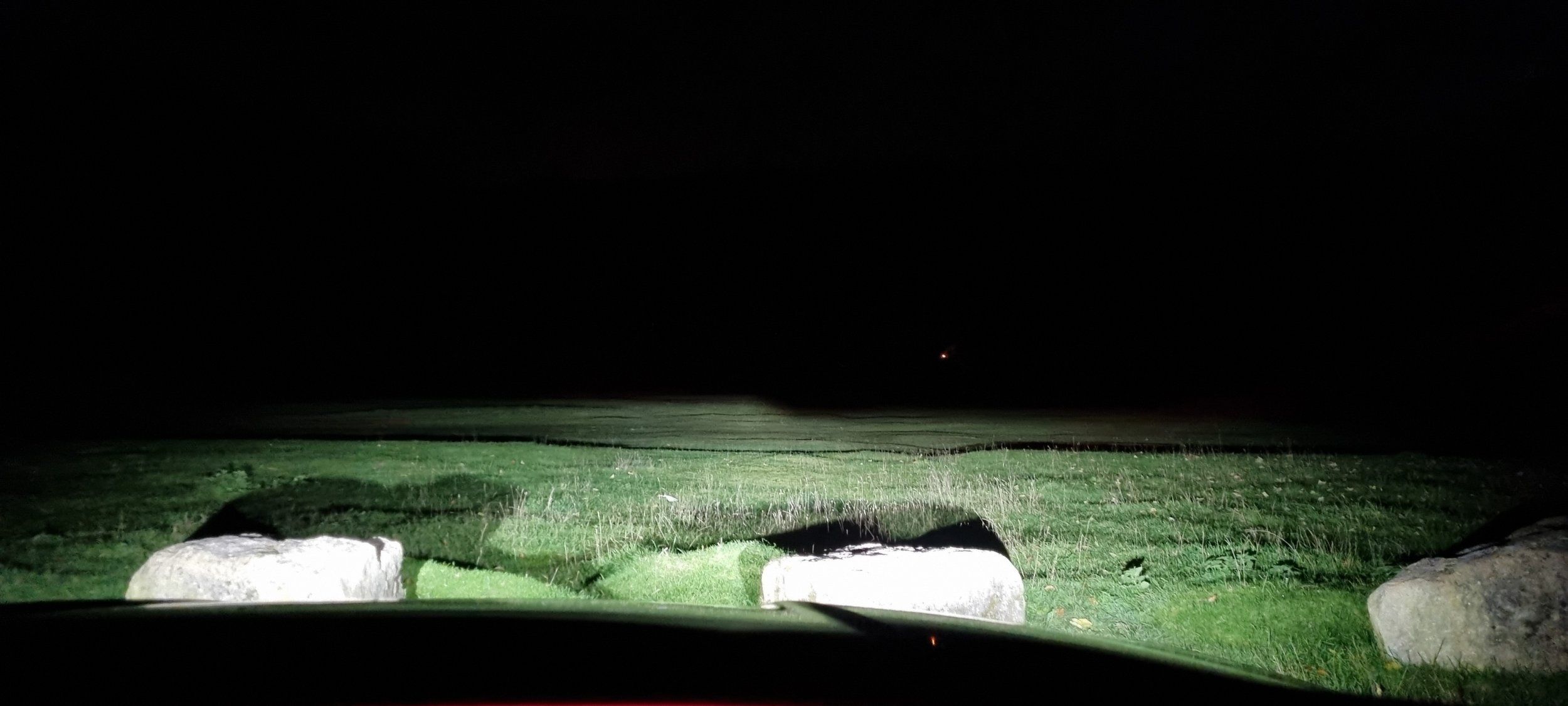

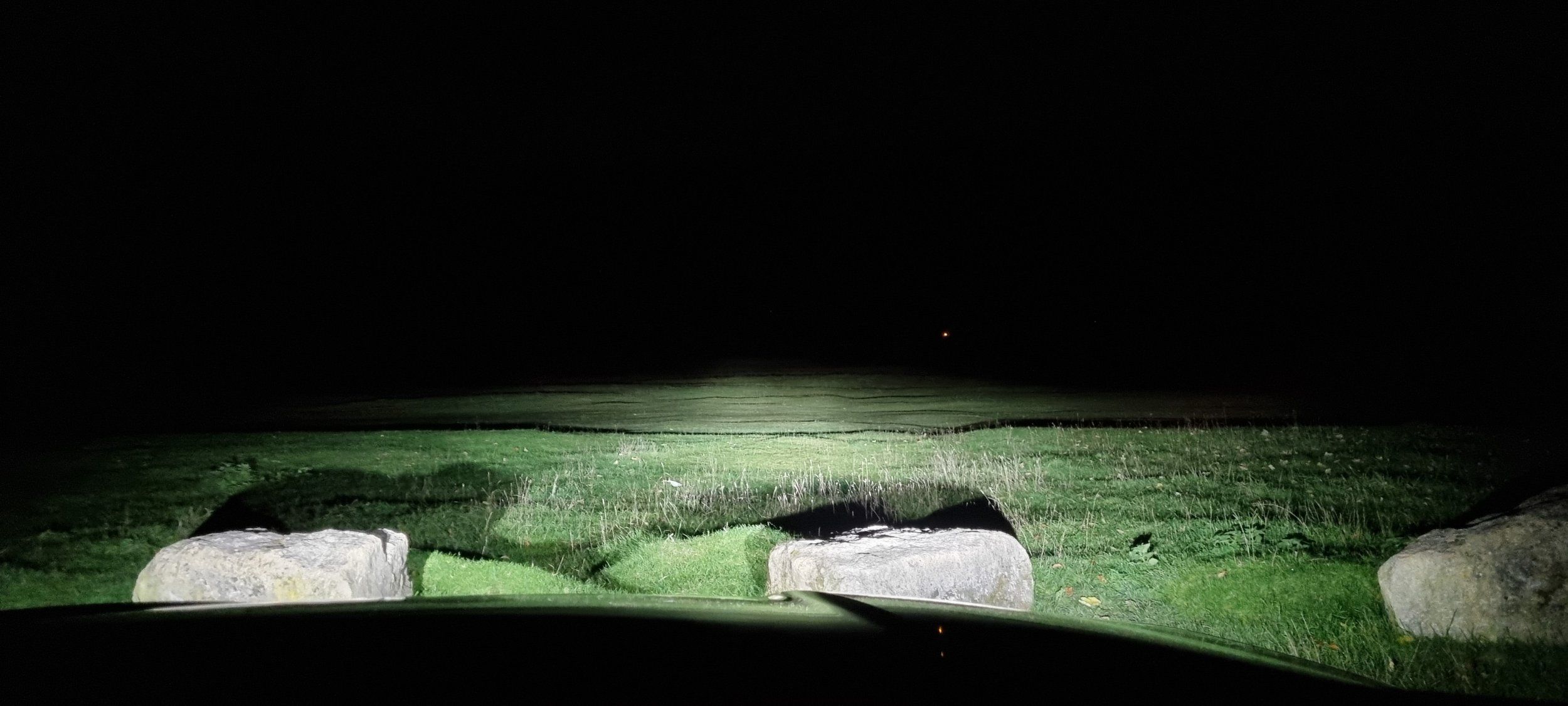

I recently bought a 2022 Seat Leon FR Sport and I've noticed when I turn on my highbeams the projectors do not tilt up like seen in test reviews online. Is this correct as I've spoken to the dealer and they have told me the projectors are static when the high beams are on.
When driving the light does not reach far down the road which is why im wondering if there maybe some sort of issue with my highbeams.
Please see the comparison of both dipped and high beam positions.
Any advise would be greatly appreciated.
Thank you.

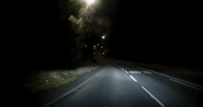

Take the same pictures on a road with trees down the side. You're not going to see much difference with high beams pointed into the darkness.

In the top photo you can see a clear cut off line.
In the bottom photo this opens up showing your full beams.
I would say the full beams are working correctly.
Looks like your dipped beams are really high so the issue may be opposite from what you think it is.
Just a thought

I think the bottom photo shows the extra high beam LED elements, that extinguish on dipped, which throw a tiny bit farther and only right in the middle. The cut off line doesn't appear to move at all between the two pictures?

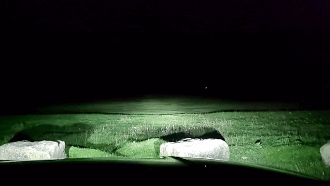

I have a a GIF of the lights turning off and on (couldn't upload the actual video sue to file size).
Thank you

Seem to be working as you would expect.
I still believe the dipped are aimed too high though and thats the issue

That GIF confirms that the projectors are not moving at all for high beam, just the extra LED elements are coming on. Even if the dipped was aimed too high you should still see the projectors raise up.

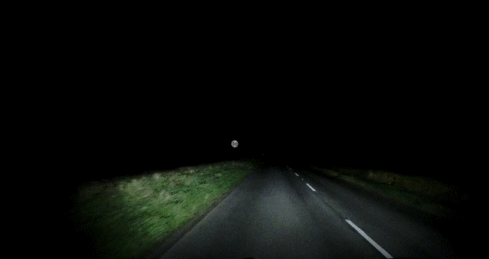

Please see some further videos.
Any advise would greatly appreciated.
Thanks

On mine, I don't get those centre lights coming on, just the tilt. That I've noticed anyway... Need to investigate further now! I wonder have you a different type of lights

You can see how high beam tilts the LED projectors up at 27:10 into this video, also the extra LED elements going on and off, yours are definitely faulty.

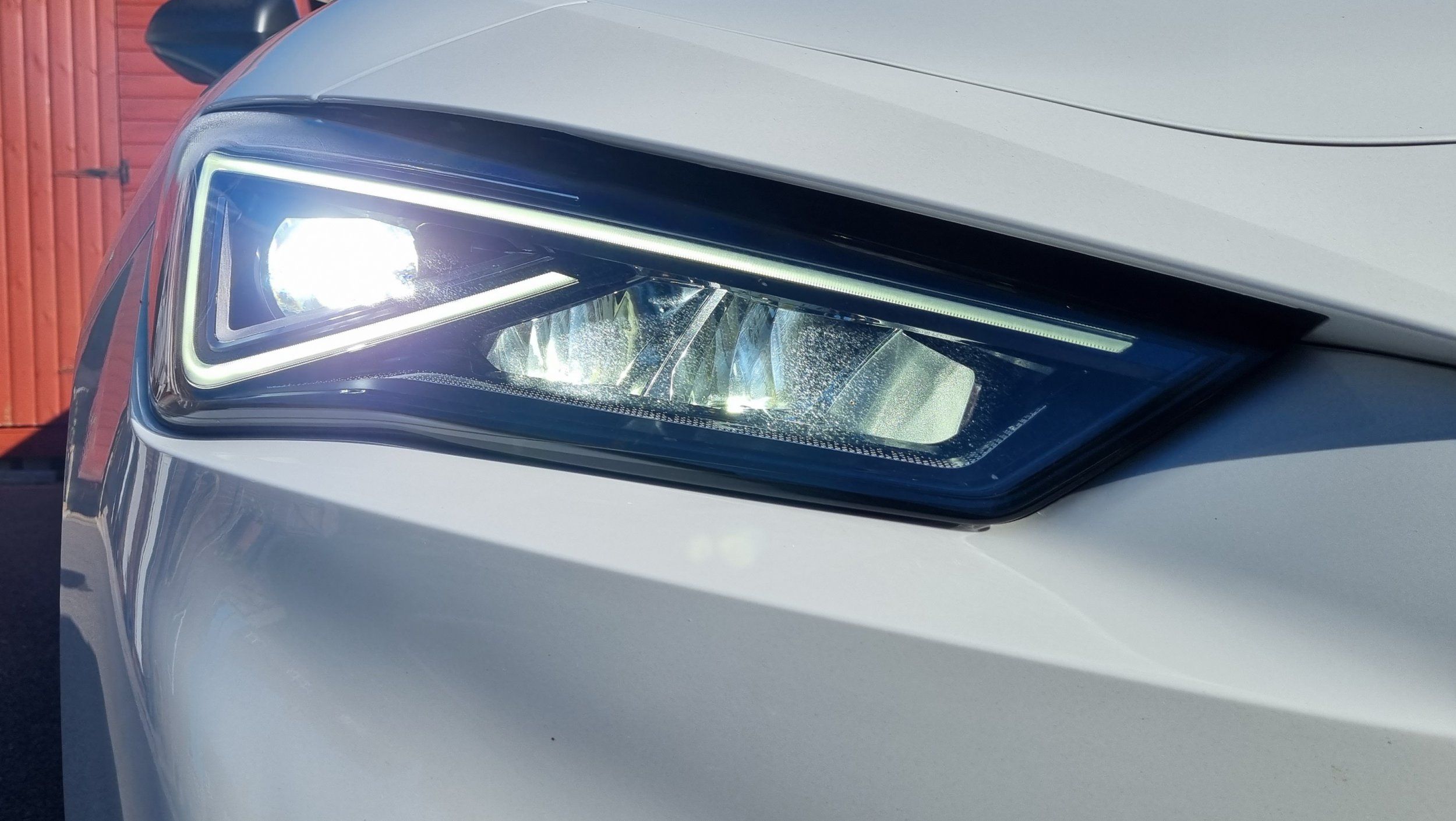

Just to confirm they are the LED Headlights - product code: 5FC941008F.
Please see attached photo.
Thanks
