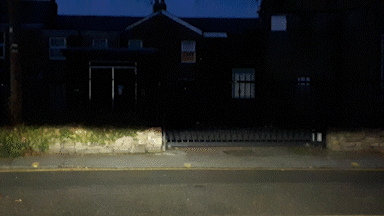

Hi Guys,
Just an update to say that the issue has now been fixed by the dealer. They applied a 'Software Update To ECU Ref: Headlights Issues' which has sorted the issue.
Thanks

Apr 1, 2024
Hey I have the same problem as you had, It worked really fine till someone coded for me to unlock some options and then unfortunally the projectors don’t tilt up anymore, just the extra LED elements are coming on and it doesn’t light up as much as before. The ObdEleven log in is attached.
Thank you.

Hi All,
Just an update that I have taken it back to the dealer and re-brought up the issue which they have now acknowledged there is fault with the Headlights not raising (tilting up) when high beams are activated, and will be investigating this next week.
I'll let everyone know the outcome once they have formally diagnosed the issue.
Thank you everyone for all of your advice.
