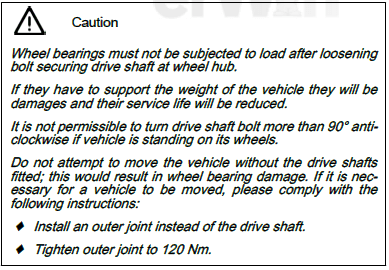

I noticed whilst checking the Seat Manual regarding the large drive shaft bolt:
Quote:
It must be ensured the wheels do not yet touch the floor when the drive shaft is being tightened. Otherwise wheel bearing may be damaged.
- have a second mechanic apply the brakes
- tighten bolt to 200Nm
- lower vehicle onto its wheels
- turn bolt 180degs further.
Also it mentions to remove nut/coupling from anti-roll bar. Maybe this will make it easier to re-assemble?
Reactions: Swaitsy

That's a fair point but very impractical for the average joe. Every video I've seen of people removing or reassembling the wheel bolt has done it with the wheel on the ground.
Your second point is a good one, I've read the same thing. You'll be fighting one less thing when trying to get the ball joint back into the control arm. I, however, am an optimistic idiot and didn't bother 😀.

Did you manage to achieve the +180degs on the drive shaft bolts???
I nearly popped a vein with my massive breaker bar but still couldn't reach 180degs on my angle gauge. My new bolts had serrations under the flange - VS the bolts which came of which were smooth - so I think increased friction is the reason? either way they are not going anywhere!
The bolts with the ribbed / serrated clamping face are 70Nm + 90°
200Nm + 180° is for the bolts without the serrated clamping face
