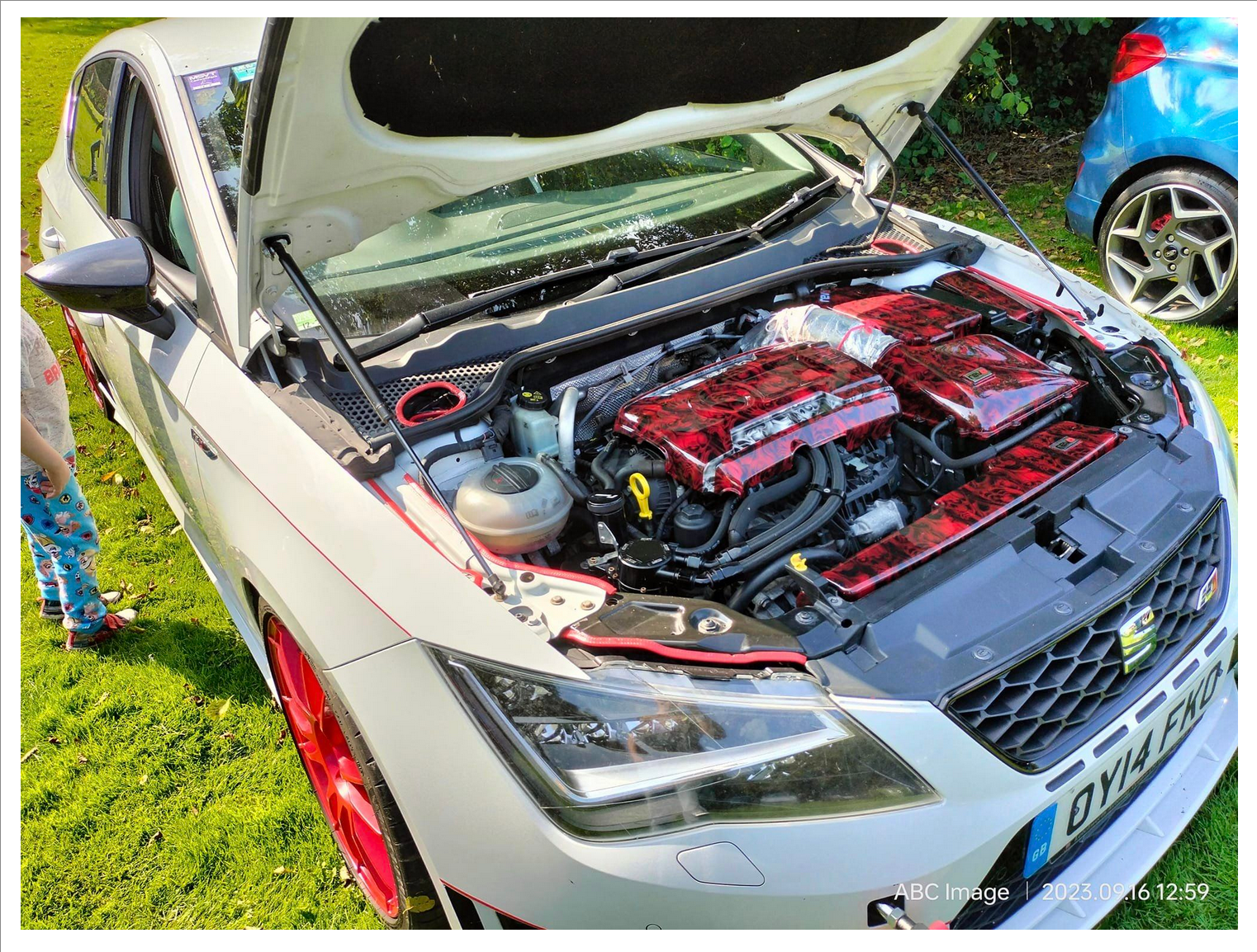

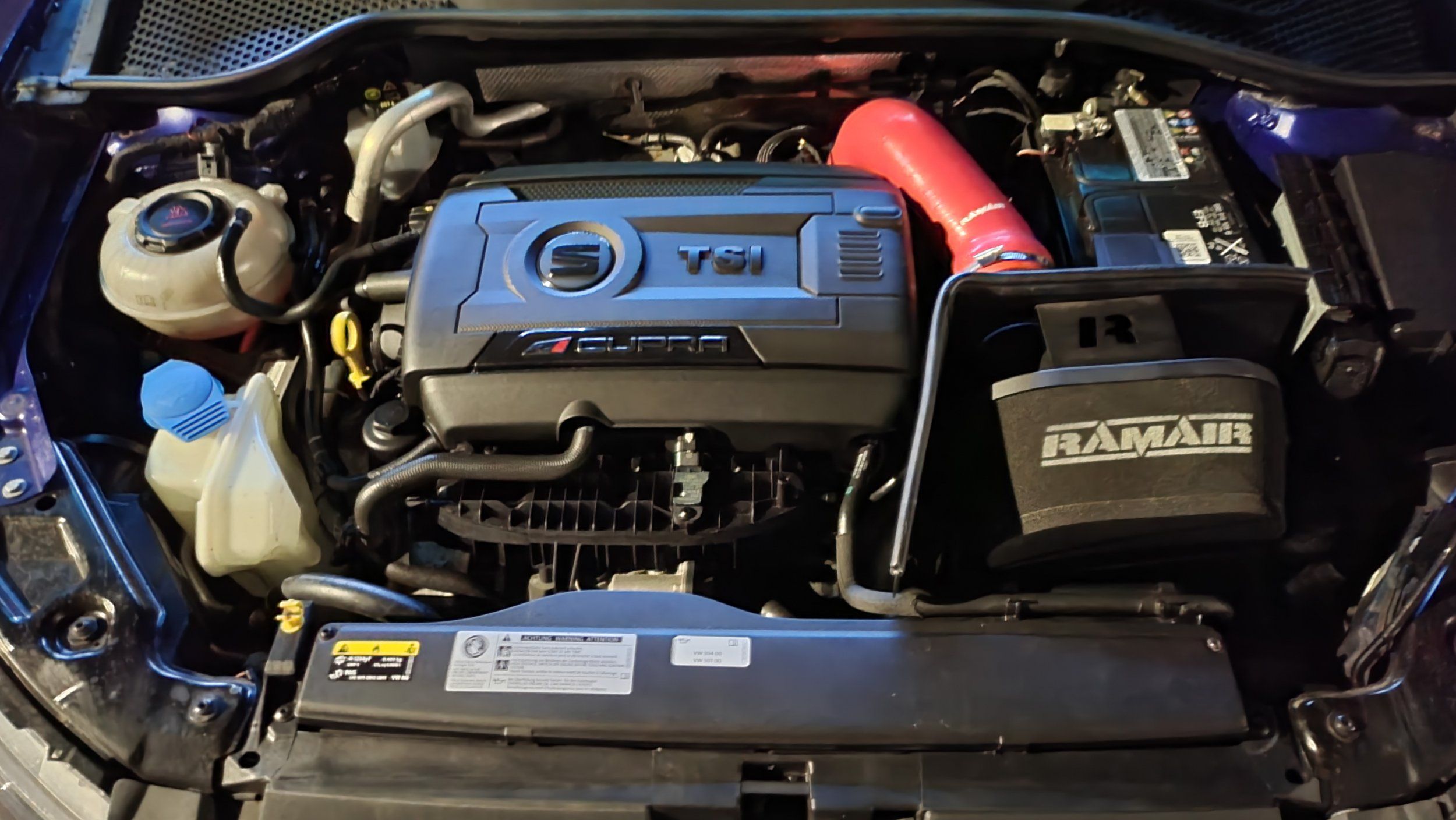

Fitted my replacement fan style heated washer jets, such a huge improvement. While I was under there I got a few fresh engine bay snaps too! 😍

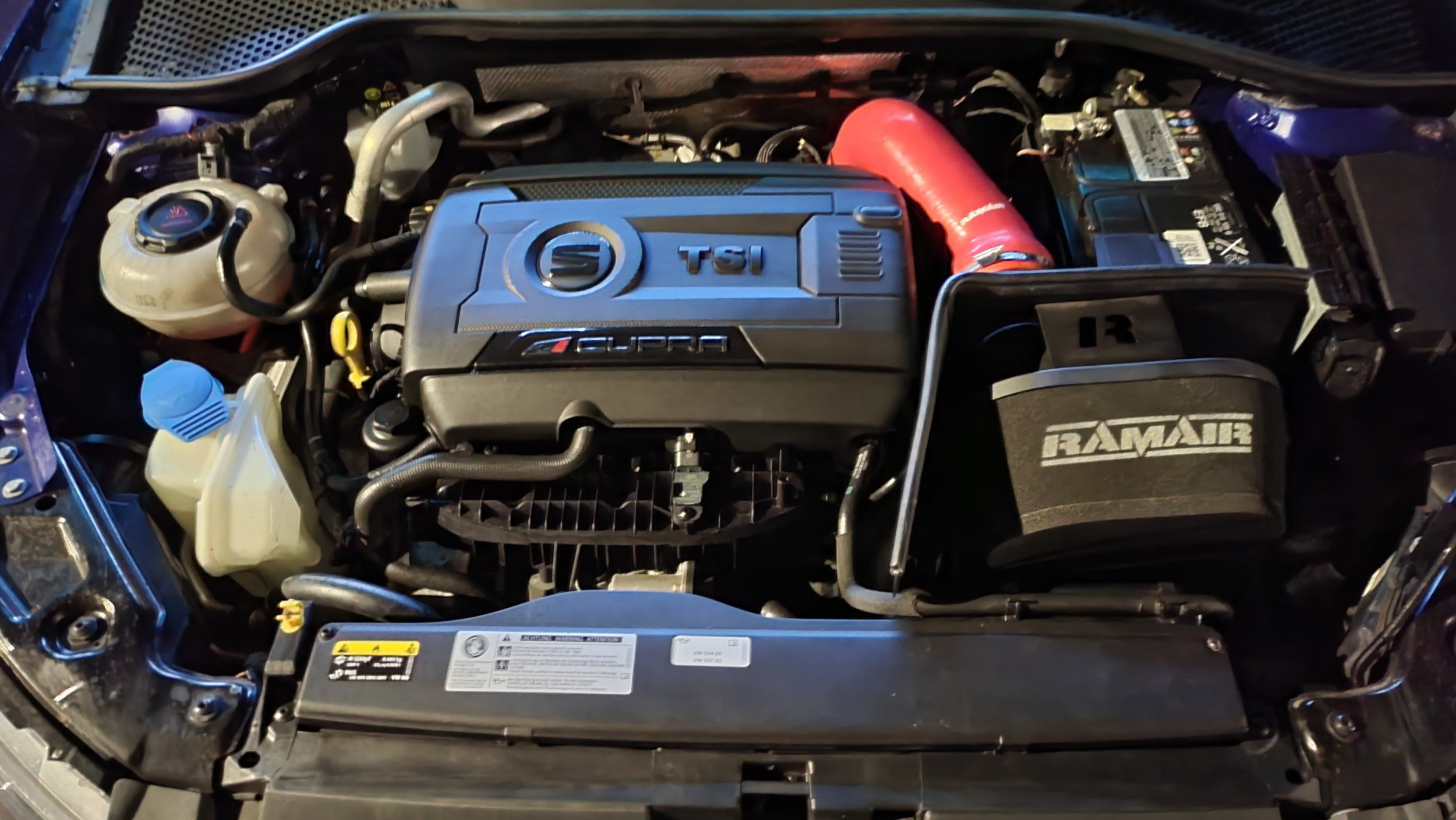

Is Ramair a good brand of induction kits? I was looking at an MST one but a Ramair one is available locally for me and Ive never heard of them.
As soon as I bought the car I was certain I wanted a RamAir cold air intake. Managed to find one with turbo elbow for sale so was perfect for me. I wanted open intake also as the noise from them is awesome. Loves of suck and blow! 😂😂 It's honestly personal preference, I prefer the look and sound of the RamAir but some love enclosed style like R600. I would definitely recommend the one I have.

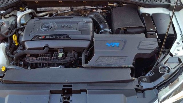

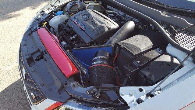

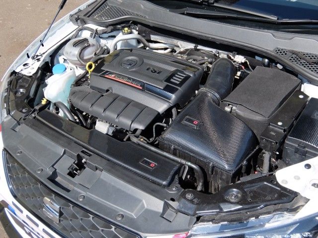

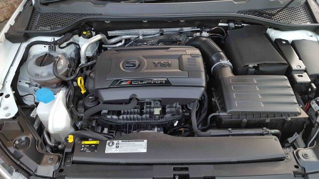

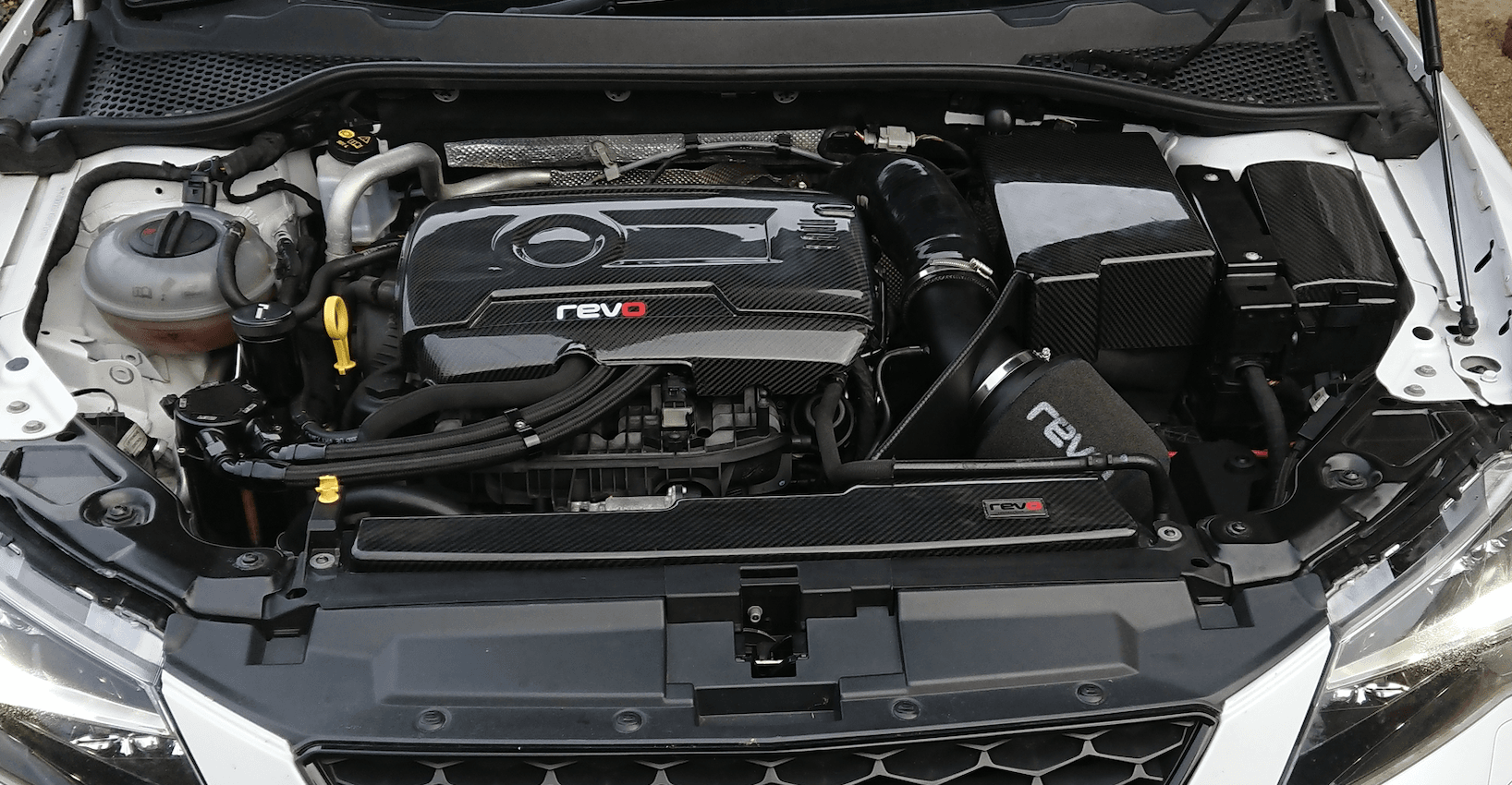

Some examples of the various options
1/ Stock intake
2/ R600
3/ Revo Stage 1 open cone filter
4/ Revo Stage 3 Carbon Fibre airbox (uses stock bottom end)
5/ Revo Stage 3 open cone
6/ Modified Revo kit
Best air filter is still the R600 but no noise although you can just use the open cone version but as with all open cone ones you get great noise but suffer with heat soak, for me tis all a personal choice what you want from the looks/sound and performance

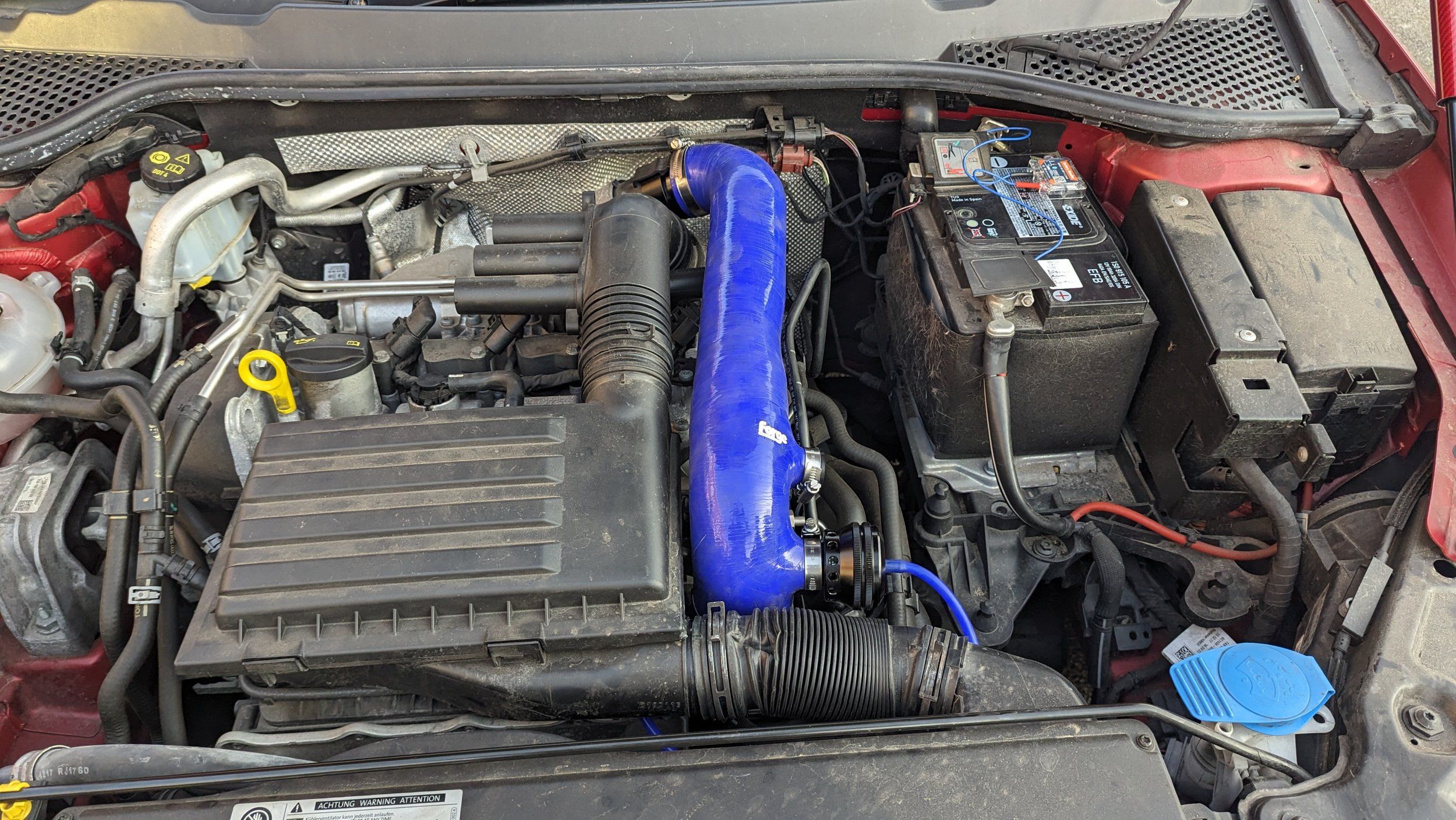

So purchased the MST Intake as it was on offer. Hopefully, it will arrive soon.

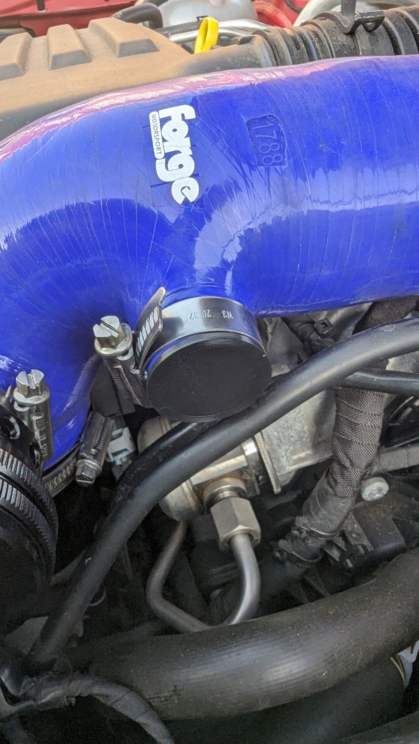

By sheer luck, someone 10 minutes away was selling a dump valve on FB, didn't even know I wanted one till I saw it on there and I thought, why not?
So fit this earlier today.
(Need to give the engine bay a proper clean)
Unfortunately, the blanking plate was missing so 35 mins on the 3D printer, and I had a solid blanking plate.

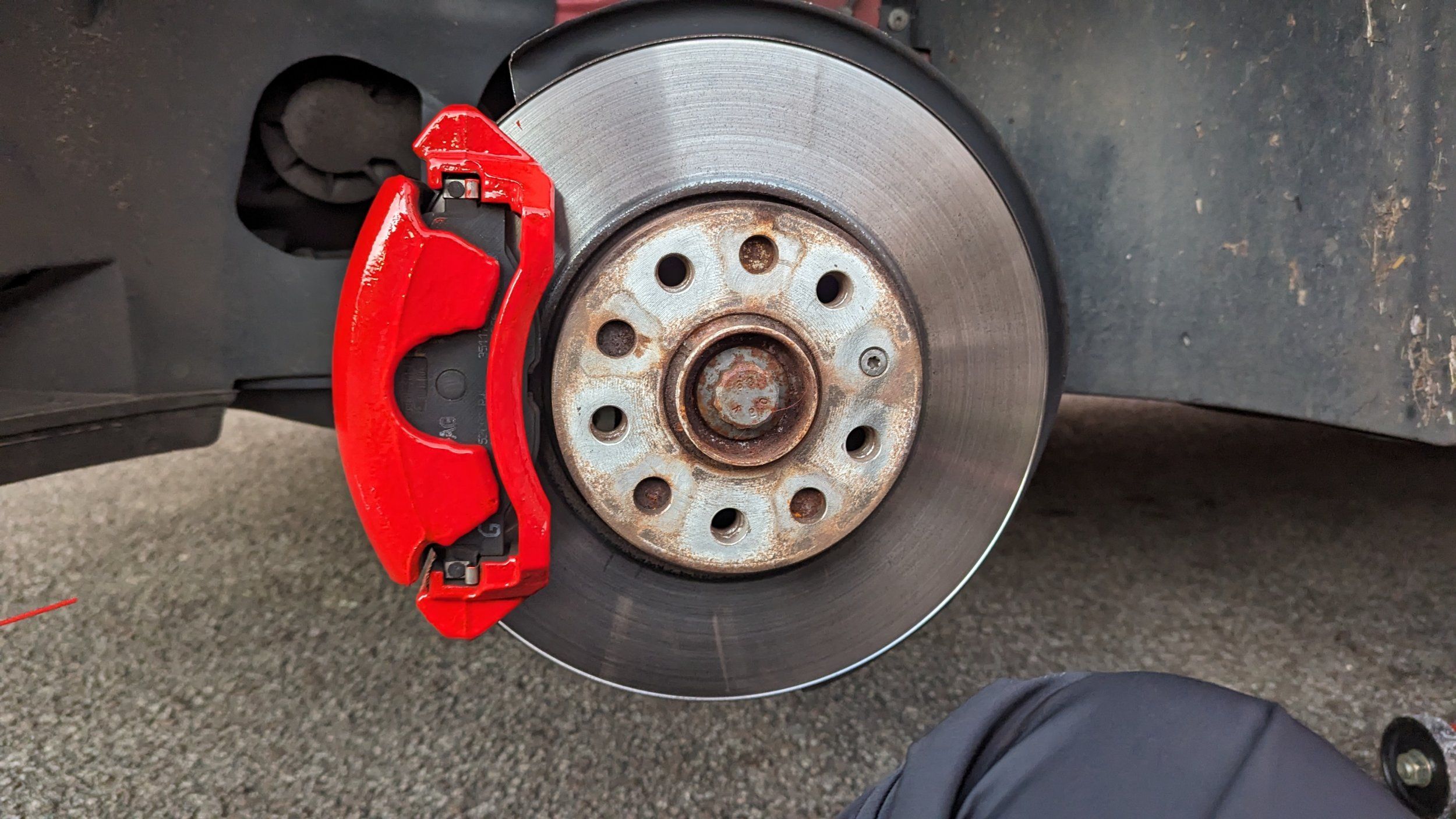

I have some red brake callipers (2nd hand) being delivered to install, but had some red calliper paint spare so gave the old ones a few coats to see how it would look. Not bad IMO.

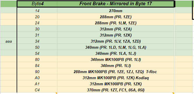

What coding did you do and do you think it actually makes any difference. The reason I ask is I have asked Revo in the past and they said they never did any coding.
The only coding that is different from say a Leon Cupra with regular 340mm front brakes, vs a Sub8 package Cupra with 370mm Brembo's is in the ABS coding from what I've found. I changed byte 4 and 17 (mirror of 4). I used the amazing ABS coding spreadsheet created by multiple ross tech users. Here is the relevant Byte so you can see what I mean.
I can't remember my old coding as mine was an FR with 312mm brakes originally - but I'm now running C4 as Byte 4, and then that mirrored in Byte 17, which is 23.
I couldn't tell you if it felt different as I did the coding at the same time as the hardware swap, but the general consensus is that you get a firmer pedal feel. I'd like to say I would go and try it back to back each coding, but I have so many other bits to do on the car that would be a low priority.
For what its worth, it may have some effect on the ESP / XDS side of things, as we know the car can apply braking pressure to each caliper individually in an out of control spin scenario. Now that I'm running substantially larger front brakes than stock, and small rears, the ESP would certainly need to behave differently to effectively correct a spin (or attempt to!).
I'd say on the safety side of things alone, a company such as Revo should be offering a complete package including relevant coding, considering its something that is absolutely possible to do.
This is my opinion though and should be taken with a pinch of salt, its not like you're telling your ABS coding what brake pads you're running, which can and does also have a dramatic effect on your braking performance!!

Thanks for that,
In my case I am running 380mm disk's and to be fair I spoke with revo and they confirmed they found no need for any coding (and when i look in OBD11 label file it also does not show 380mm) but I have messed around with the straight ahead stabilization and changing the brake booster force settings. Revo view seems to be they found no benefit and to be fair the brakes do stop the car very well.

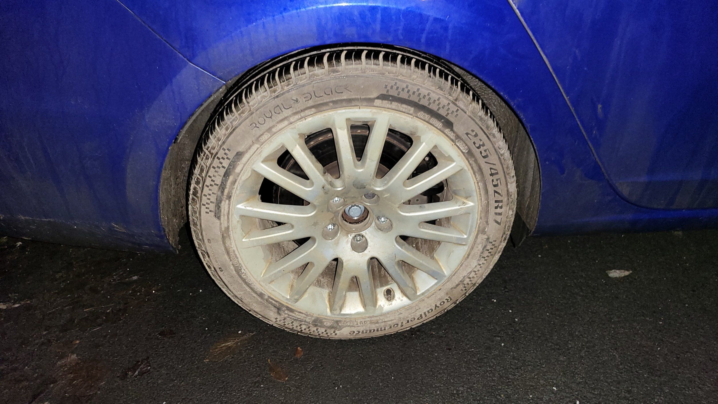

Dropped my wheels off for powder coating. Got loaner wheels overnight! Shoddy old Audi rims 😂
Had a look at the tires while they were getting taken off, and I'm glad I did! Rear passenger side had a flat spot and cracked part up the middle of the tire!! Luckily was able to source a PS4S to arrive tomorrow to replace it! Hopefully that explains the noise which I thought was a wheel bearing.

May I have this coding sheet?
