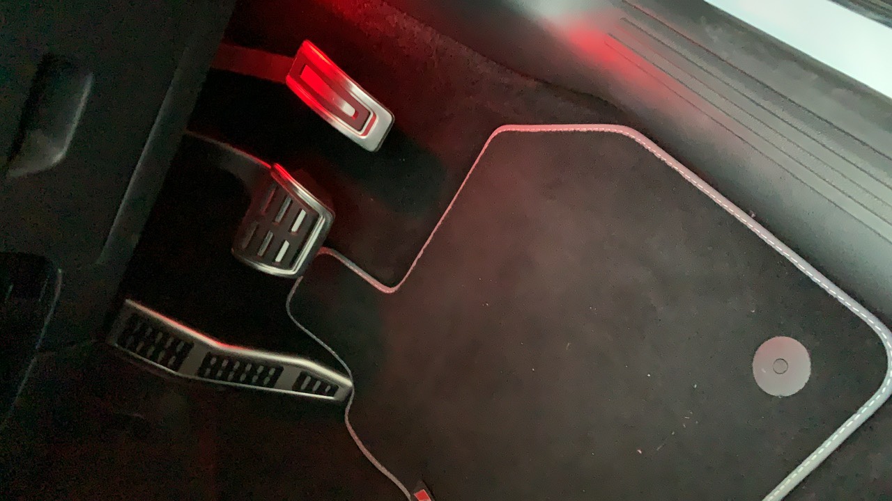

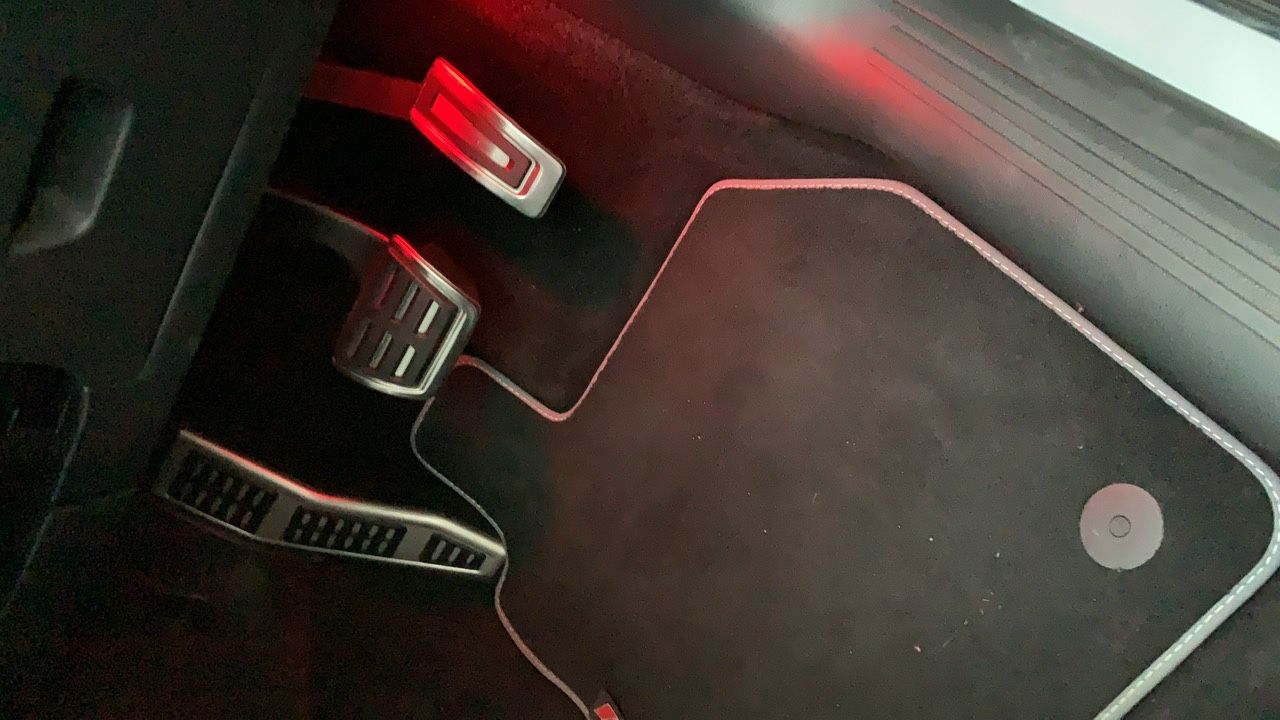

Yeah Ali Express. Wouldn’t buy engine parts from them based on the 2 interior parts I’ve bought, but good enough to put my dirty trainer soles on lol
Have u got a link to it pls?

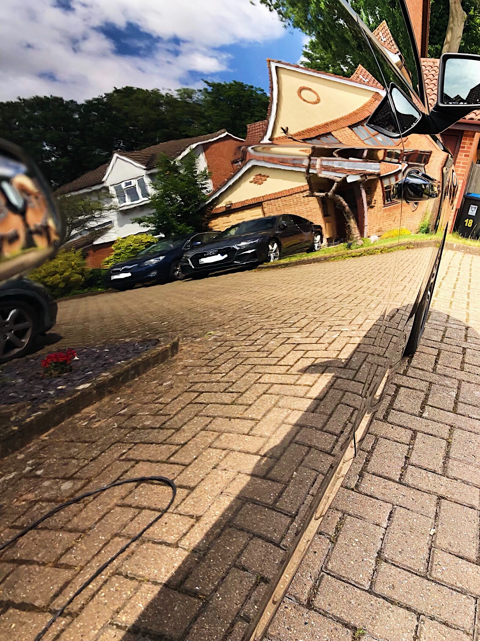

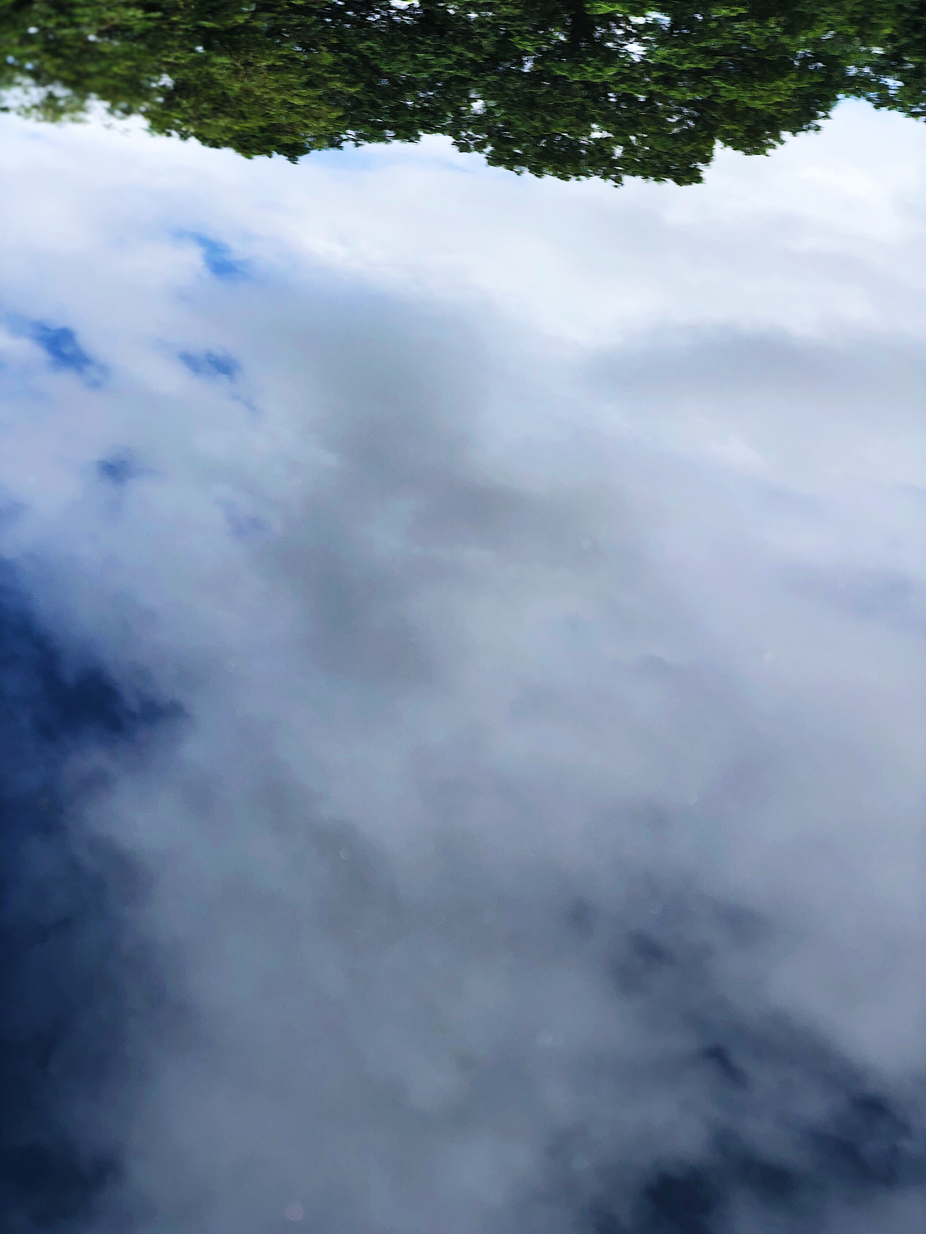

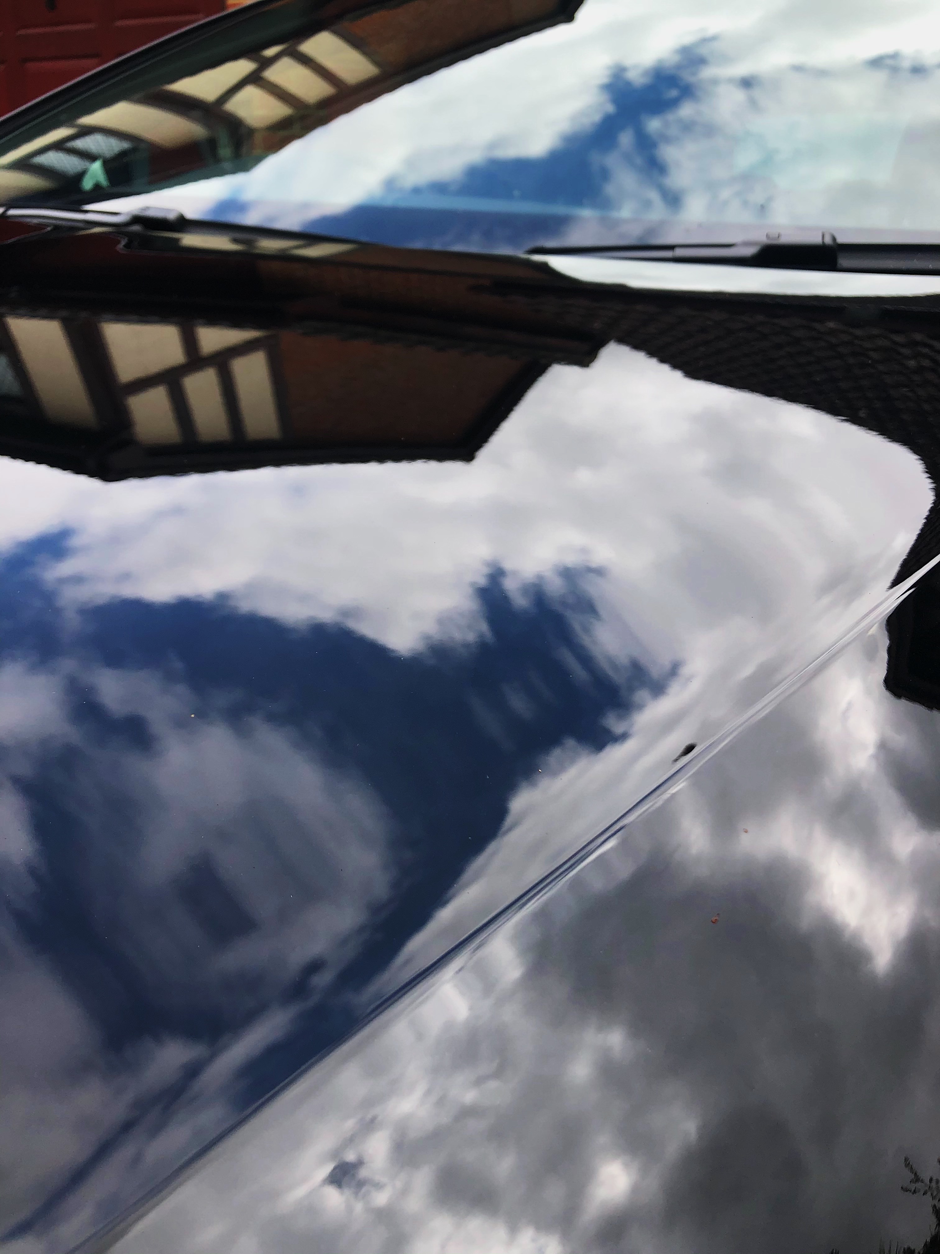

After having a scratch repaired down the drivers side door, there was some holograms left from the buffing..
So instead of letting them having a go again, got my DA out and polished the whole car. Also had to repair swirls inflicted by a ‘rated’ car wash place..
Incredibly pleased with the results and products used. Process went as below;
  1. Pre-rinse and bug/tar remover and wheels sprayed with cleaner
  2. One foam shower
  3. Rinse and second foam shower
  4. Rinse and then two bucket, woollen mitt wash with AG shampoo and conditioner
  5. Rinse, dry and windows/trim sorted
  6. Once over with Auto Finesse Triple Polish (using DA)
  7. Once over with Poor Boys Black hole glaze (using DA)
  8. Wax - Poor Boys Black Hole (using DA)
I realise the Auto Finesse is not considered a real polish. But does have a cutting material. Enough so that an hour with a DA got rid of all marring/swirls and holograms.
Poor boys glaze was to get that wet look, and the wax really made it look like a puddle.
Highly rate all of those products on a black car!
