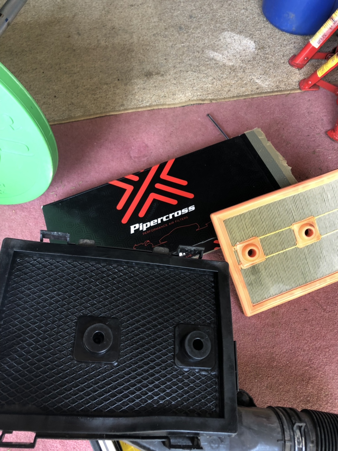

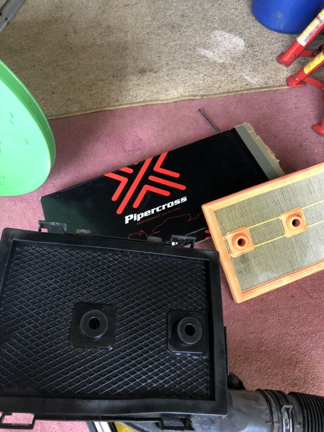

Does it make any difference to sound etc?
Seems fairly easy to fit?
I’ll report back about the sound but on fit it was fiddly but not too difficult once I’d googled it. You have to disconnect the Airbox and ‘pop’ it out it sits on some little ball sockets which hold it in place. To do that you need some large pliers (I used adjustable plumbing ones) to disconnect the air intake feed pipe and the air ‘out’ pipe into the engine (there’s another small pipe I didn’t bother to disconnect as the top of the Airbox stays in the engine bay). Then there are 4 clips around the outside which you need to pry open with a screwdriver. Once you’ve removed the bottom of the box there are two posi screws underneath which hold the filter in place.
Awkward but not too hard.
