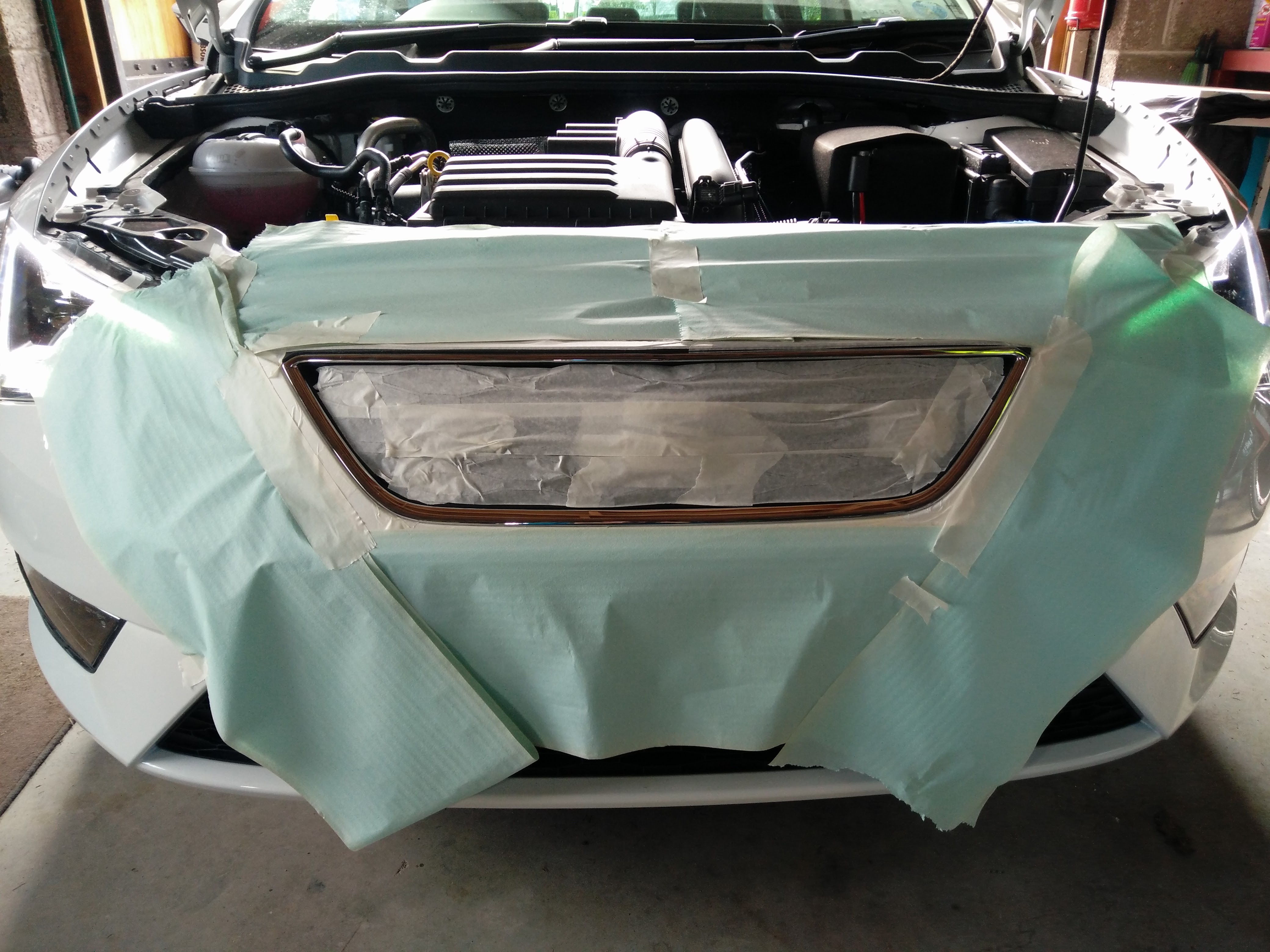

Here's some inspiration for the taping off. I did the above to dip the chrome surround, I left the badge chrome but you could do exactly the same as this and just use a Stanley blade to cut out the badge section and it would leave you nicely protected.
