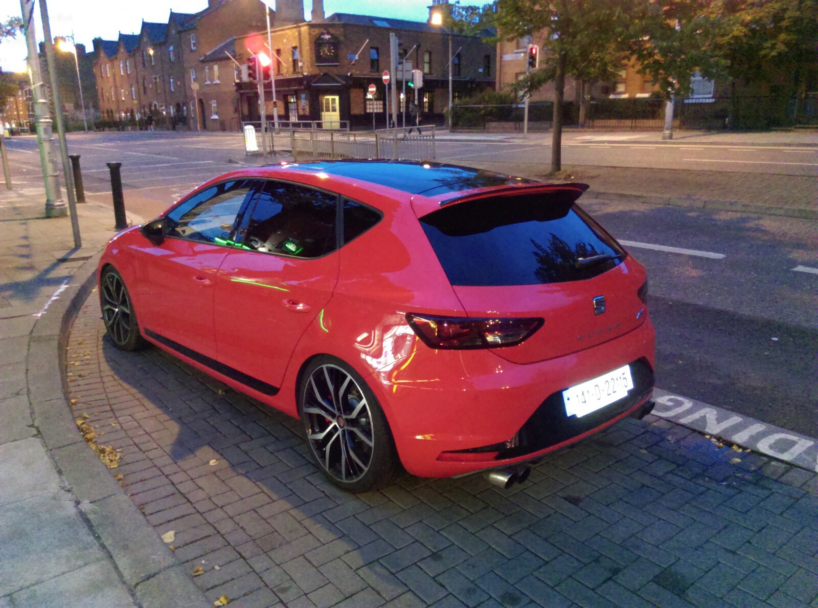

Quick Pic from Friday, rear windows tinted and brake lights tinted also some fresh wrap on plastic trim on rear bumper.

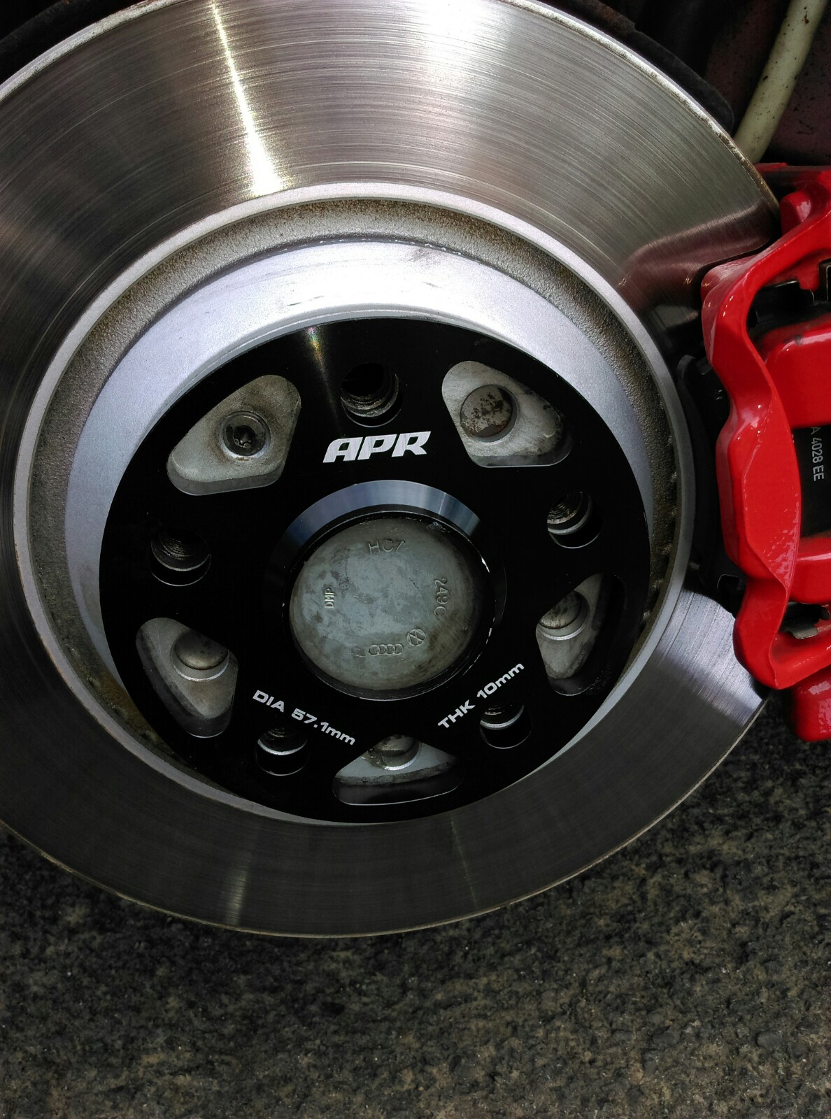

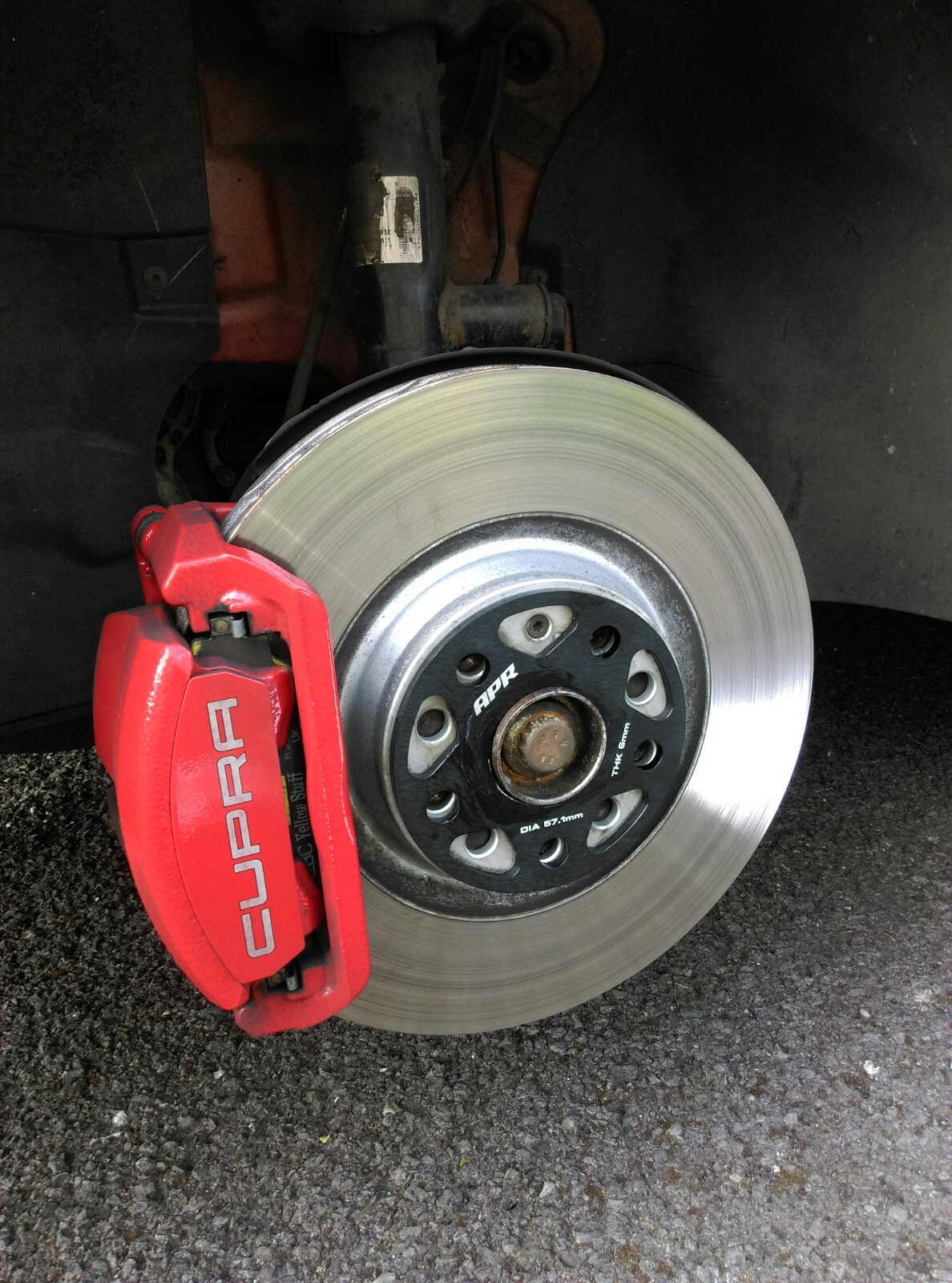

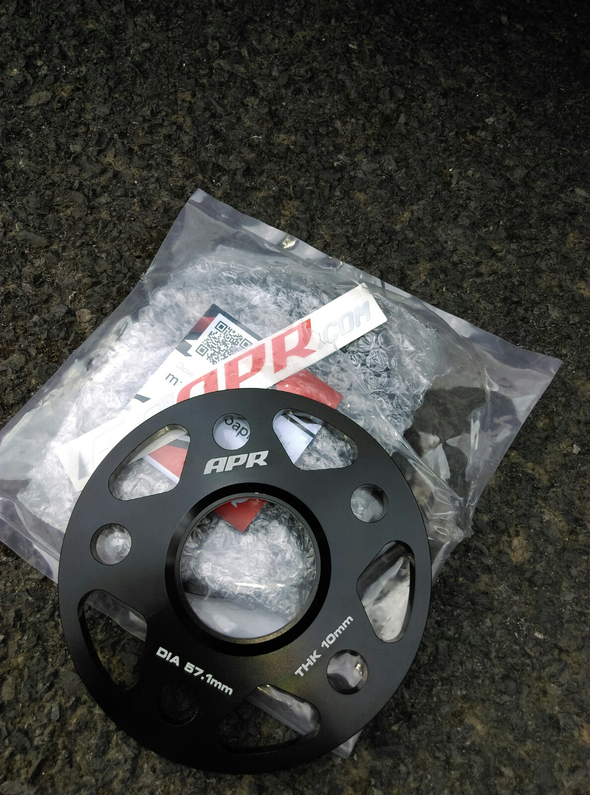

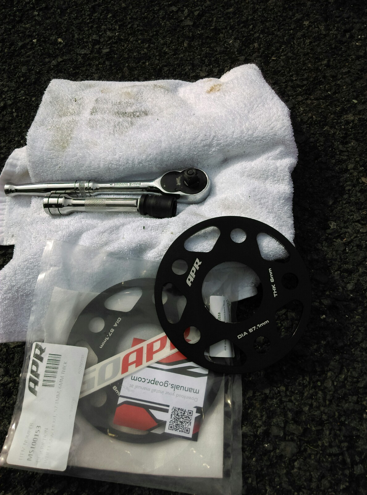

Fitted some APR spacers and longer wheel bolts over the weekend 6mm front 10mm on rear
had some issues with 10mm rubbing strange as I only have H&R Springs nothing to low
lucky I had another set of 6mm spacers so I added them to the rear
6mm all around looks / feels good

Stel94.. sweet ride by the way.. when you say fresh wrap on bumper, is that the plastic piece where the number plate goes ... as I’ve been trying to get that done round my way and the guys are telling me that I’m better of getting it sprayed as the wrap won’t bond so well as it’s not a smooth surface, I think there just trying to get more money out of me.. cheers
Yes that's right, I had they guys take off the bumper remove the plastic and sand then primer it for the wrap to stick properly. I had it wrapped previously but it started to peel on the edges. I would recommend painting it but I could not be without the car for more than a day wrap looks good and for the money its not bad but I think id choose to paint it doesn't have that supper glossy shine
