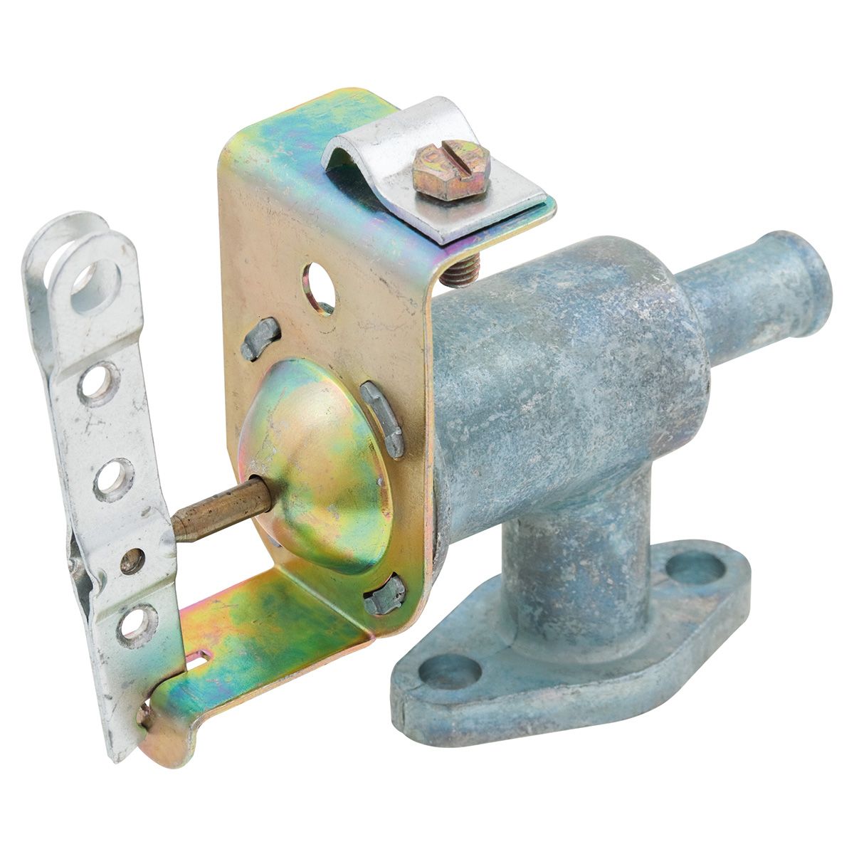

(Set heating to max) Ah the old days, just a piano wire cable was all you needed for heat...
