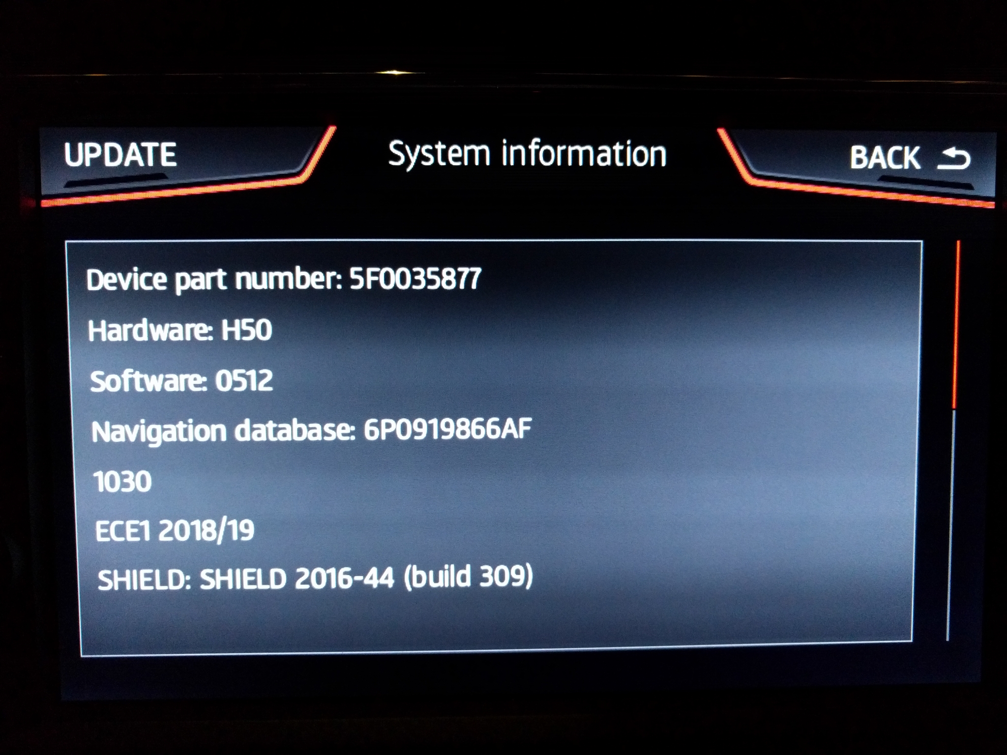

Had a drive in a 2019 290 ST today and noticed that the Virtual Cockpit has different views from my 2018 ST. In addition to the double dials (revs & speed), there is a veiw with a single central rev counter and one with the speed and revs up the sides, and nav view. On mine I've got the double dials and two rather boring views. Is the difference due to software or hardware, if the former then maybe I can get an up grade to the latest version? The infotainment system in the 290 had different hardware version (H50) and device part number (5F0035877), whereas my car is H41 and 5QA035874. The 290s infotainment screen appeared more responsive too.

Interesting. Mines an 18 so registered, and maybe built, before yours. Could I ask what hardware and software versions you running, and the device part number, thanks.

Much obliged. You have the same hardware as the car i drove today. Mine must be an older version and probably unable to have the more recent VC views. Might get the dealership to verify this.

Changes to dash hardware on STs from BW42. Thankfully Seat made them easy to spot thanks to Copper logos!

It was MY2019, so sept onwards.
But it is a hardware change. Needs the virtual cockpit swapping. £600 before any coding and fitting costs.
