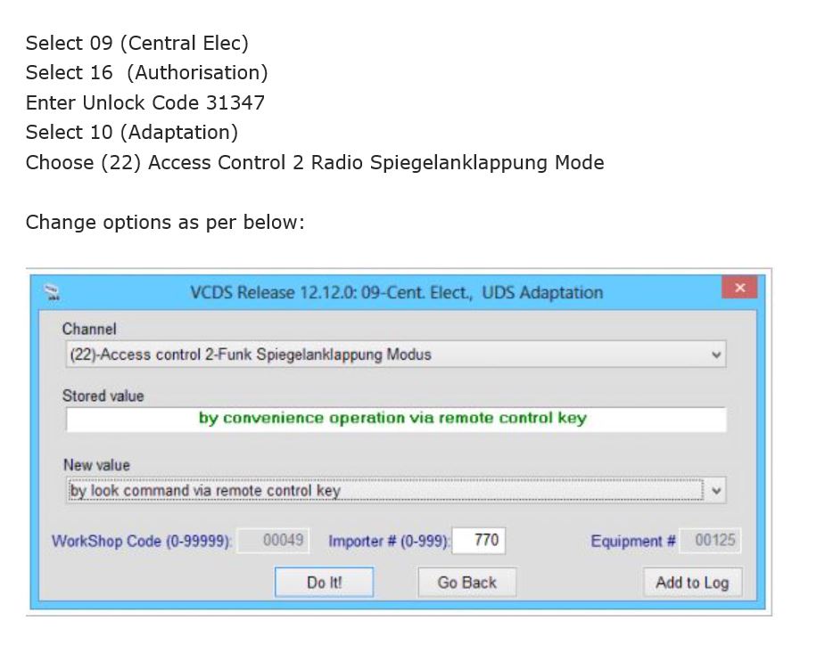

This is how I did mine,
Select 09 (Central Elect)
Select 16 (Authorization)
Enter Unlock Code 31347
Select 10 (Adaptation)
Choose (22) Access Control 2 Radio(Funk) Spiegelanklappung Mode.
(I have a feeling when I did mine it wasn't under (22) I think I had to scroll
down to find the description under a different number).
Change options as below,
Stored value = by convenience operation via remote control key.
New value = by look?(think this is meant to say lock) command via remote control key.
Then Do it!

so exactly "by look?" with ?
