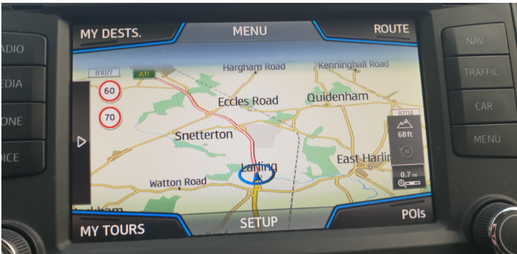

As with previous updates, all went as expected when using DiscoverMedia2_EU_DL2_1120_V10. Still have 'broken' saved Destinations and Favourites that need recreating..... When I went on a 60MPH road, instead of seeing one speed symbol of '60', I saw two, a '50 and a '60'. When I then went onto a dual carriageway, it showed '60' and '70'. When I then went into a 40MPH, it showed only one '40'. Very odd! Has anyone else experienced this?
Yes, I downloaded the same file and have exactly the same new feature: two different speed symbols for some roads, but just the one symbol for others - it is indeed very odd! I wonder if this is related just to the '1120' download or if it's also happening in the '1115' versions too?
I get an overlay abroad of kph on the mph but not that that's on the Plus. I'll investigate a bit.
I'm wondering (have had 1/2 bottle of wine)... that feature you are seeing on the screen is the bad weather speeds you see in other countries that use them, but data has got scrambled in its use in the UK so you are seeing garbage instead since they shouldn't be used in the UK. That's my theory of what you are seeing. You'd have to see what people are saying on the continent about it and VW / Skoda sites in the UK.

Trailer towing I configure that as off in the unit. Something to check, could be that rather than lorry / car :).
Include trailer : Calculate the route and arrival time
for the vehicle with a trailer.
One test that you can do to try to replicate it for anybody who has it or wants to check, is to put the unit in "demo mode". That's in advanted settings.
Demo mode : When Demo mode is activated and
route guidance is started, virtual guidance to the entered destination can be initiated.
Define demo mode starting point : if demo mode is activated, a fictitious starting point for virtual route
guidance can be defined when the vehicle is sta-
tionary.
Was going to try that with the Dunkirk - Calais road which has twin dry / wet speeds to see whether the screen displays that on the High version. The manual is lacking on how it displays wet / dry speeds. I recall the icon has a wavy line on it. Demo mode is how I check that I'm getting the bong after uploading speed cameras.

Thanks, I'll check those settings. it's got to be something to do with trailer speeds as it goes down to a single '40' symbol when you enter a 40MPH zone.
