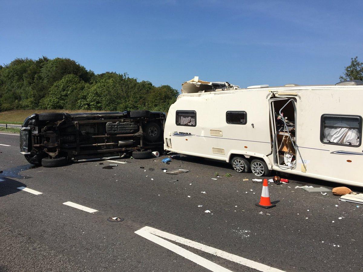

A large 4x4 is no guarantee of safety, anyone towing over the recommended 85% ratio (even if still within the car limits) needs to be very cautious and experienced.
From my local paper just this morning, a large Toyota 4x4 was flipped into the opposite carriageway by its caravan.
