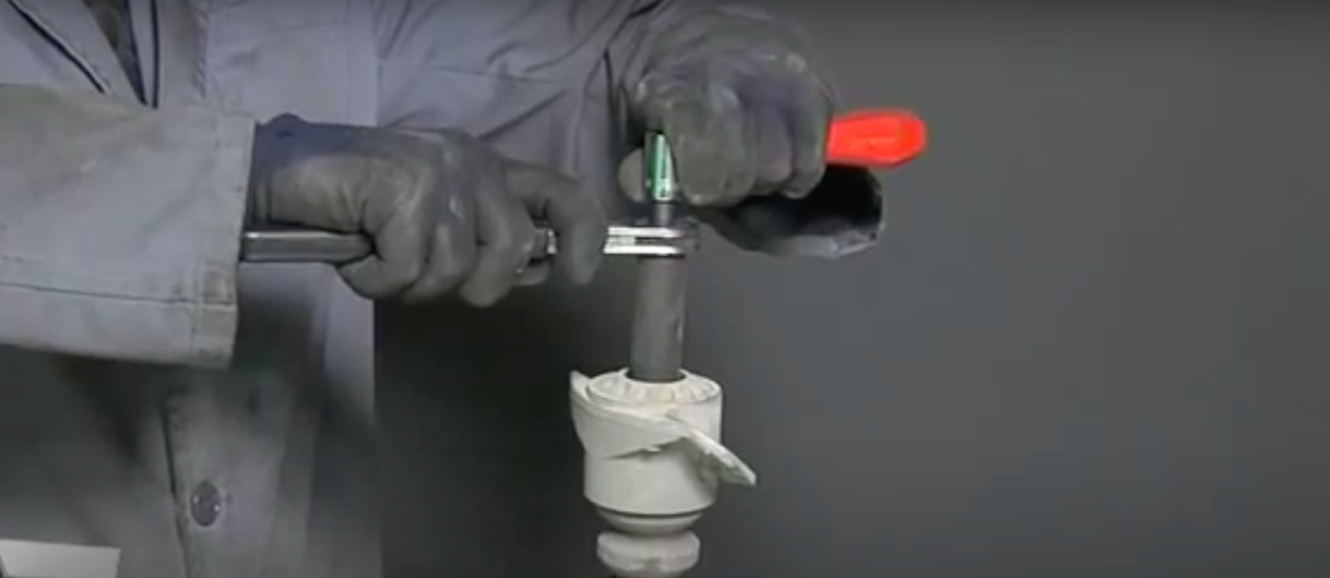

i was rotating my wheel the other day and noticed one of my rear shocks/ dampers was leaking, of to motor factors to get a new set
so i can get them out and all easy enough
its just getting the old bits of on to the new one
so from watching youtube, what's the setup here, what do i need?
thanks stehepn

You can do with a spanner and a set of mole grips. You just need to be able to stop the centre bit spinning while you undo the nut.
I still have one to do, so I will try and get some pics today, its really easy.

Here you go,
Take the plastic cap off and this is what you get...
The take a 16mm ring spanner and place over the nut, take the mole grips and lock carefully into the flat side of the top of the shock.
Turn lefty loosey... job done.
Fitting the new one is just the reverse of this.
When loosening just make sure you have a gap in between the grips and the spanner so the nut can move, once it’s loose it come off with fingers.

amazing thank you for taking the time to do that for me
your a star.
thank you

seen that tool on ebay, but didnt know what it was for the job
after seeing the above photo i get it now
halfords do anything for it ?
