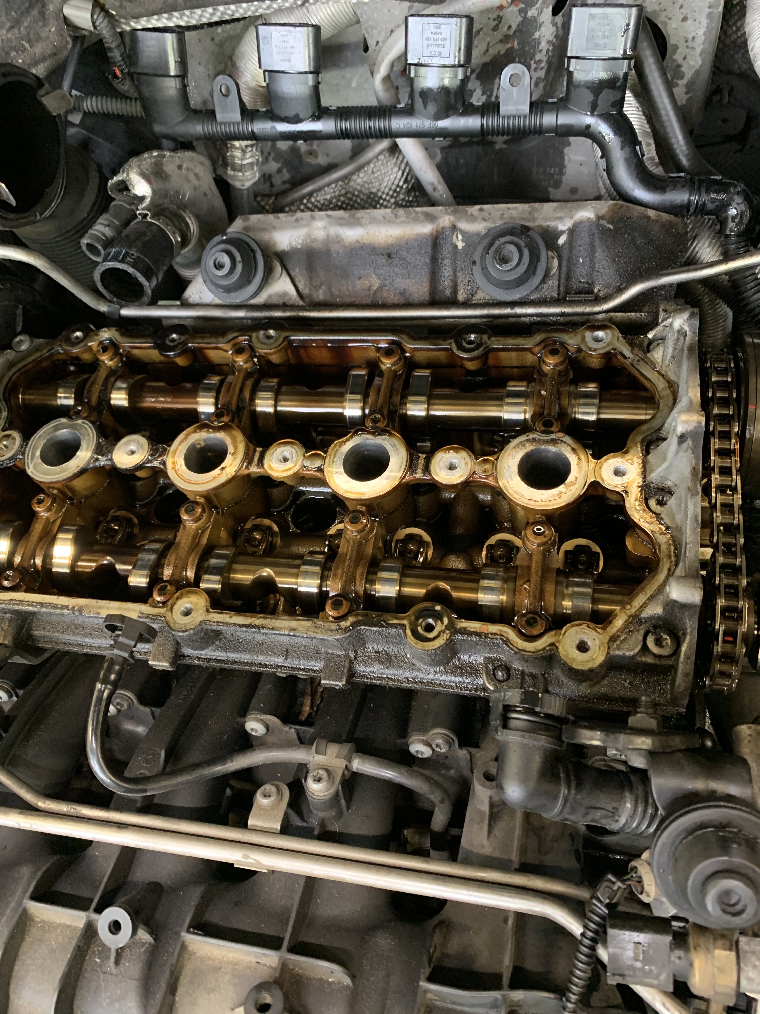

63581417-3864-478C-A011-223BC7A7A93F.jpeg 43FC9632-BA46-4E6A-B959-5E3AA3738FB9.jpeg 60C4C230-D27E-4C17-B6B4-5020028AA2F7.jpeg 6F8468A9-6F86-4AE5-94D3-CB9A7B9E42F5.jpeg 9AD9E83B-FEAB-4B33-ABA4-13BA49FE8198.jpeg 3D165EDE-616A-4FB6-B28D-2235CB7E0BF7.jpeg Hi here is my 2008 Leon cupra 1p 2.0tfsi I got it from my mate who’s had it for over 5 years as his daily. My friend was ready to scrap this car due to it needing so much work and he’s upgraded it for a 4X4 when I got it the Leon was tapping which I called the death rattle it was leaking oil from everywhere and was the worth example of what I’d class as my dream daily driver. I know it’s not flash and anything to shout about it but it was mine and paid for.

On your very first pic of the chain\tensioner you know there should be a chain slider on top of the plunger? I'm sure you did? Just checking!

Hi Matt that’s the old failed tensioner just to show the death rattle I had. Lol the top had broken off and fallen to the side. Definitely doesn’t look like that after I’d finished haha.
