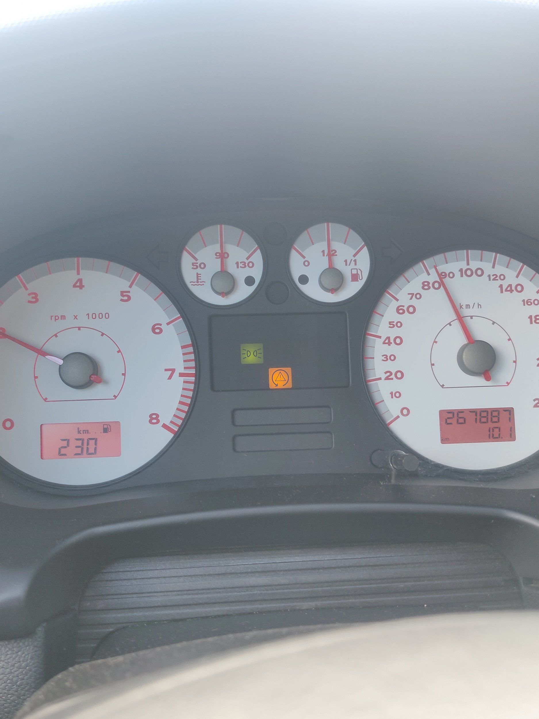

yesterday after going fast, w.o tcs it still stays on. tried disconnecting battery if it were to be just a faulty button. what else could it indicate than faulty maf? i've got brand new bosch maf like a month ago and got rid of the light then.

You need to scan it for codes mate. Could be MAF again or something else. Without fault codes you're just guessing.
Does your check engine light work or has someone covered/removed it? It's unusual to just get a tcs light without either a engine or ABS light as well.

no fault codes, just one for decat

it resets if i disconnect the battery, turns on same second when i start moving
Oh right, not the switch then.
I agree with what andy says, could be related to the abs as they share the same wheel sensors. Does the ABS light come on and go out again as it should? Lot's of times people put tape over the lights.

yes it lights up when i turn the key goes off when i start the car, i'll have a look on the brakes tomorrow abs rings etc
Yeah it's a weird one. The two common causes for the traction light is MAF and wheel speed sensors, however the first usually brings up an engine light, and the second an ABS light. Judging by the fact it only happens when you move, then i'd definitely say wheel speed sensors.

where is this located at
Item number 6
