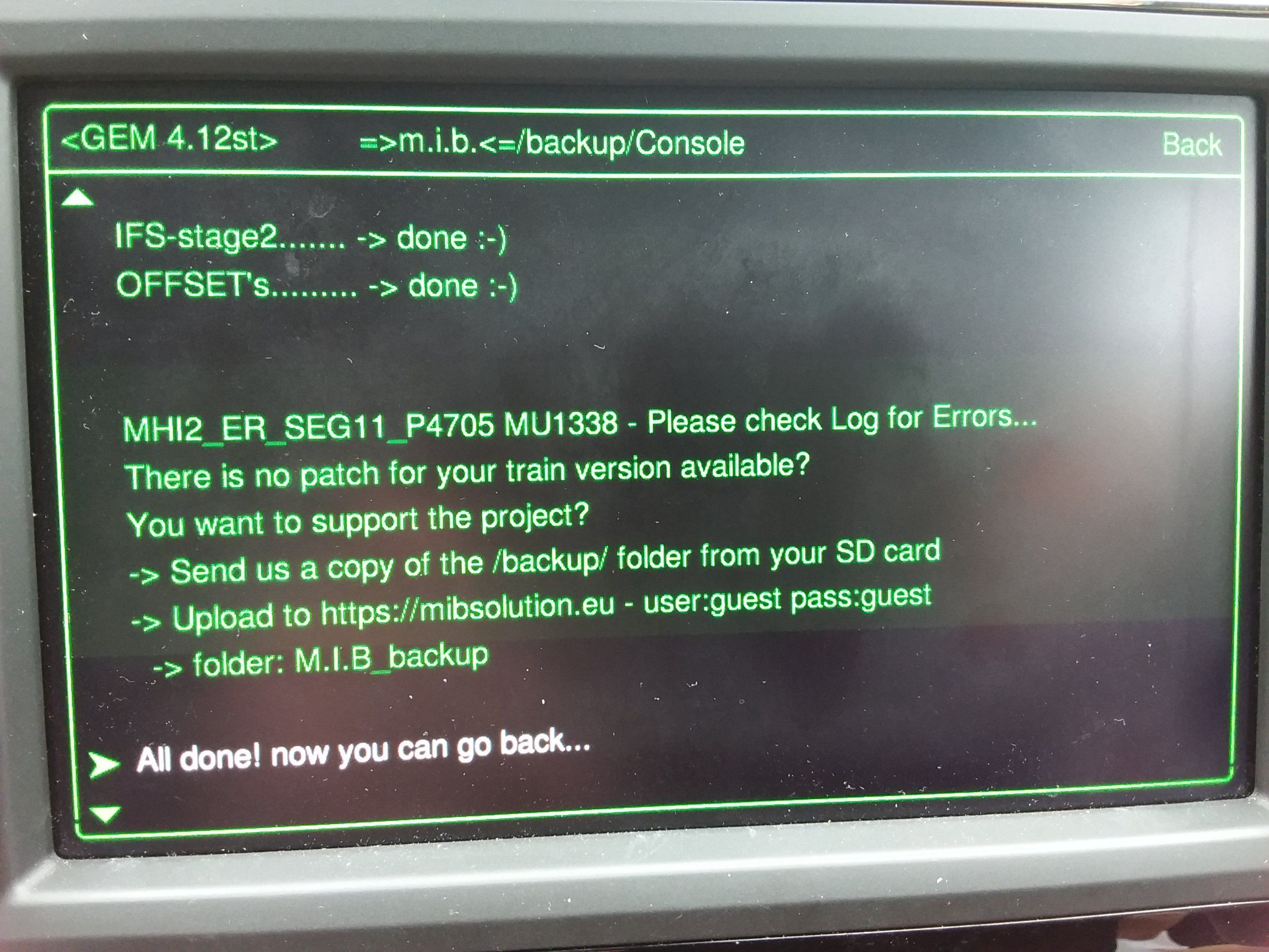

I'm being advised to stick with my current firmware 1338 with the patch by @jpmedia rather than jump to 1447. I'm happy with 1338 just doesn't run with 190 and I would like the lifetime FeCs on the Seat front + Skoda. I think the advise comes due to it being already retrofitted adjusted and your mibroot alarms bells you got me worried about (e.g.. disturbed sleep). I'm assuming that what I am given will slot in and leave the Mibroot question unaffected since its outside of the domain it's in. Will that be apparent from the backup I've supplied ?.
On the positive side Mib Tool installed OK, backed up and invited to upload since it wasn't in the database.

Ok yes fully working and I've uploaded to Mibsolutions as directed since a copy didn't exist and @jpmedia is going to do his or her or non what's it on it.
So far looking good.

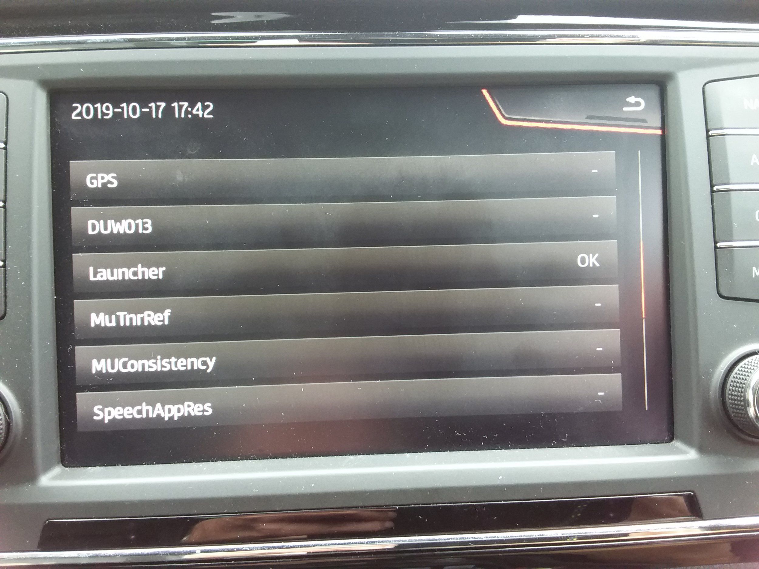

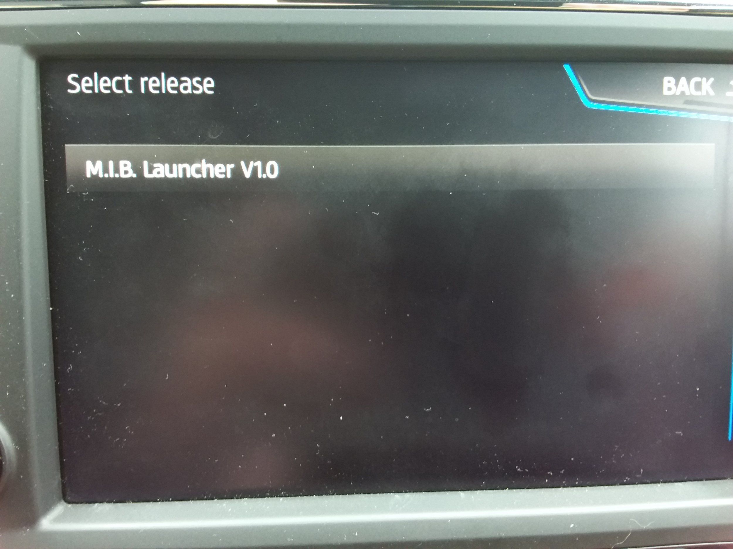

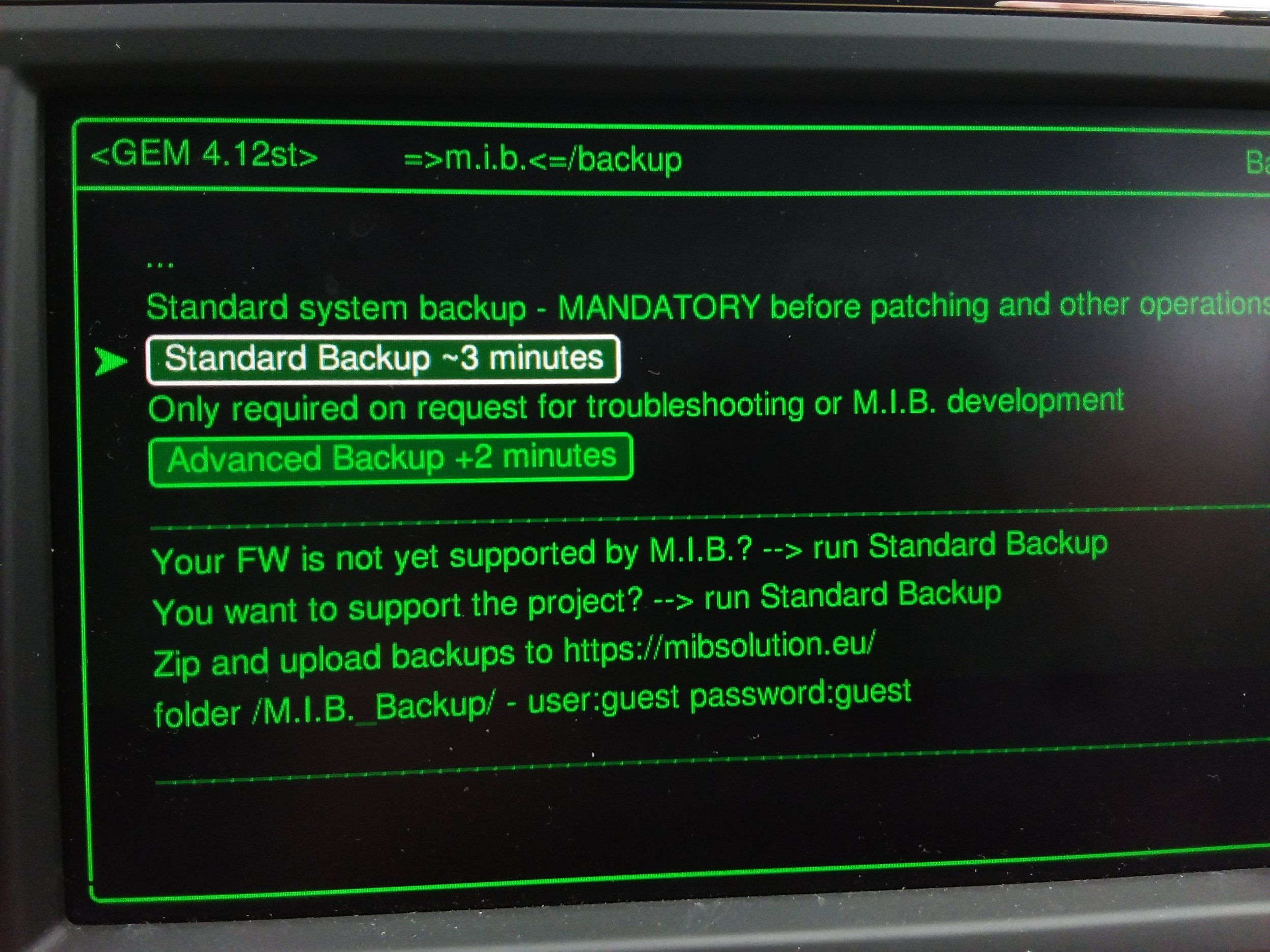

Put some key screens for peoples info from Mib Tools. Did it with the engine running.

A M.I.B Backup is not easily applied back to a unit. It aids more to understand issues and have all the „tools“ to fix an issue.
I really do not understand, what you are so afraid of .
M.I.B is used by a great number of users over the last months. And has a big support community. It is also fully transparent in what it does - just check the scripts.

See photo above. GEM 4.12st

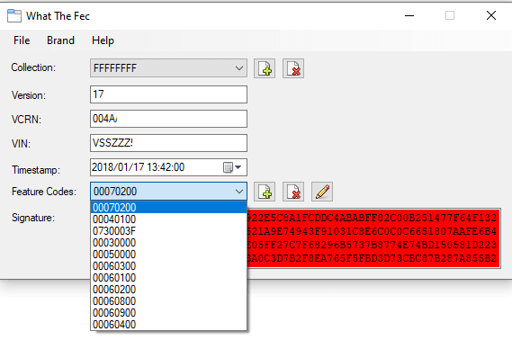

Do I need What the FeC for that. My router software objected to the linked website for that. I tried to download but Trend software went into action, so didn't bother.
Is that just a case of editing it in, saving etc. I might be able to manage that. Option 5 of MIB tool I guess is the import once you have it and work it into that directory but that's written for a patched import.
Ok I can see where you edit the list but will it not import the map files because the Seat part number 4 is missing so it needs your clever additional processing in those modules you have released. So don't reckon it's as easy as you say unless that import option in itself frees up the software for looking for part number 4.
Mind you I'll wait for @jpmedia kind assistance since he's waiting for my advanced back up this afternoon. Don't want to mess him about. Plug and play is what I want :). Don't want to trigger the TSR issue again as the old retrofitter did. Why I'm careful.
