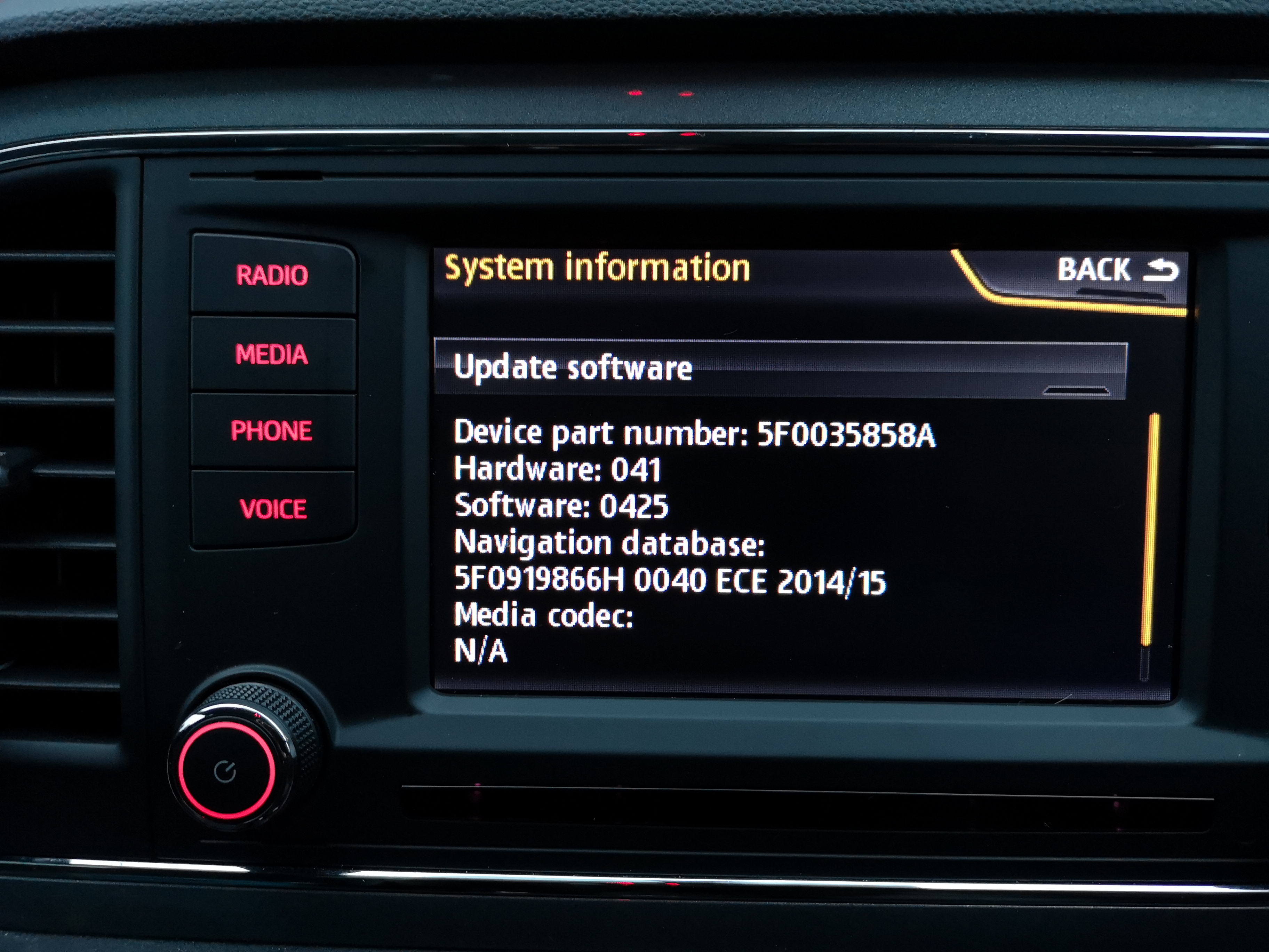

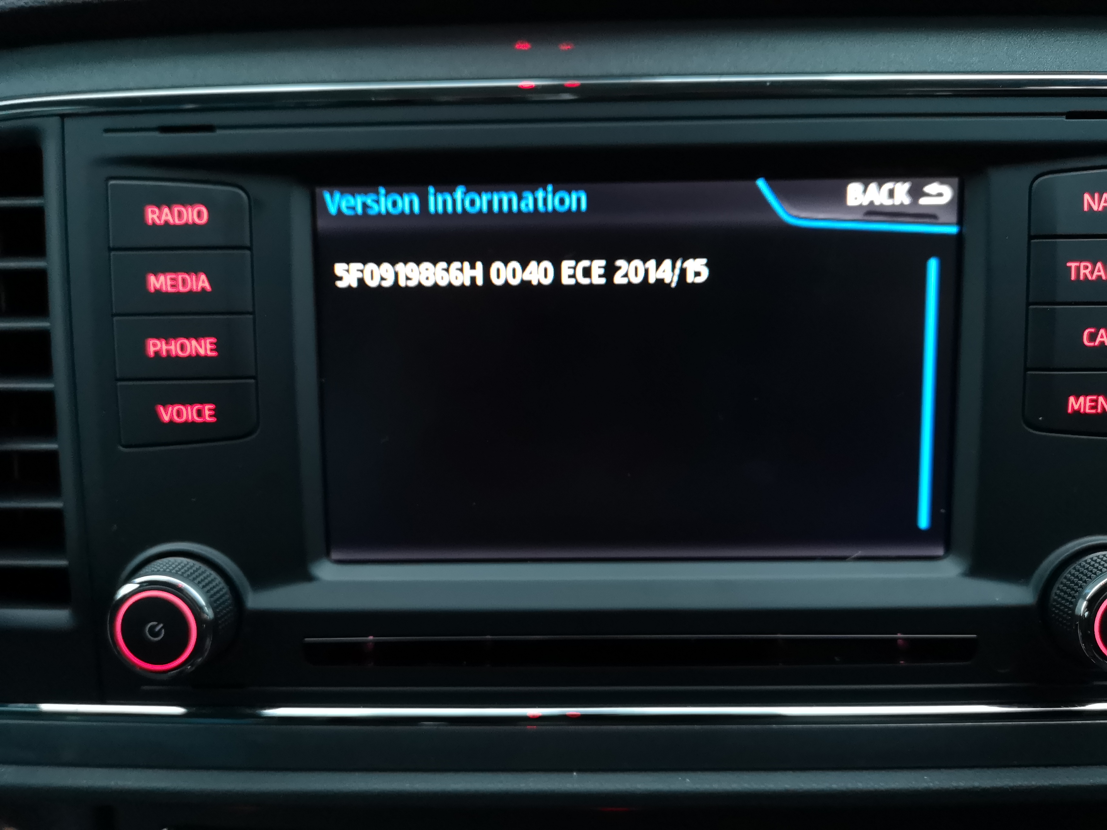

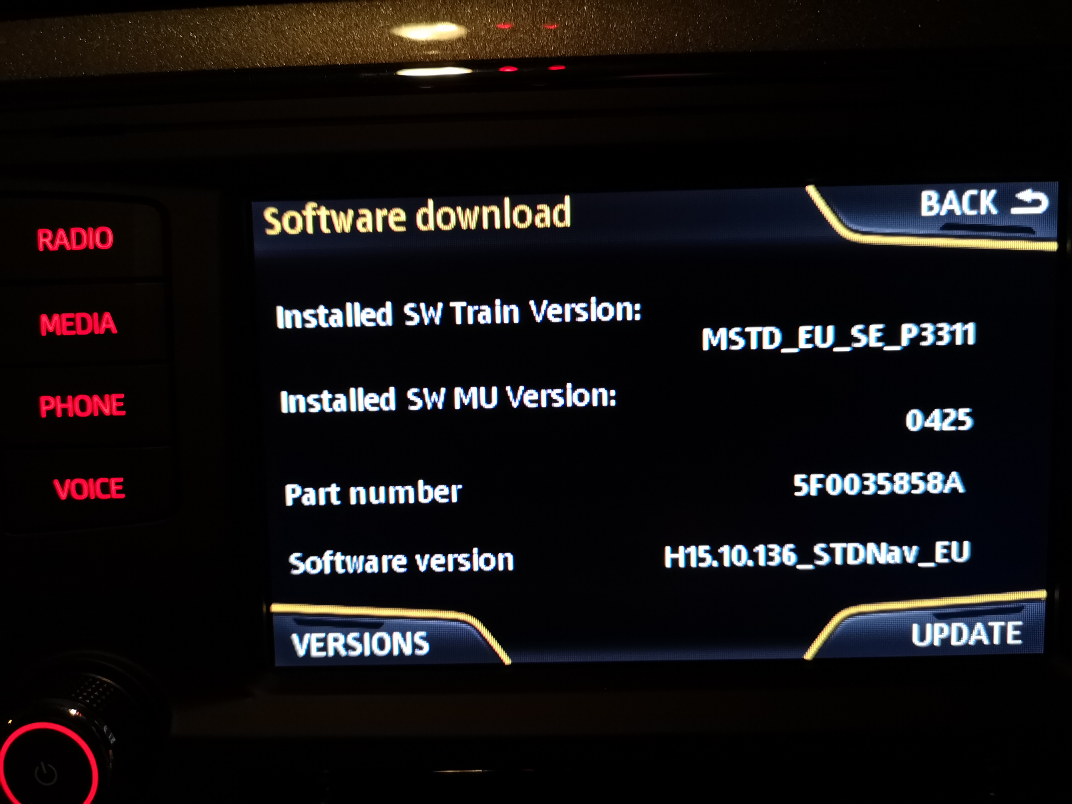

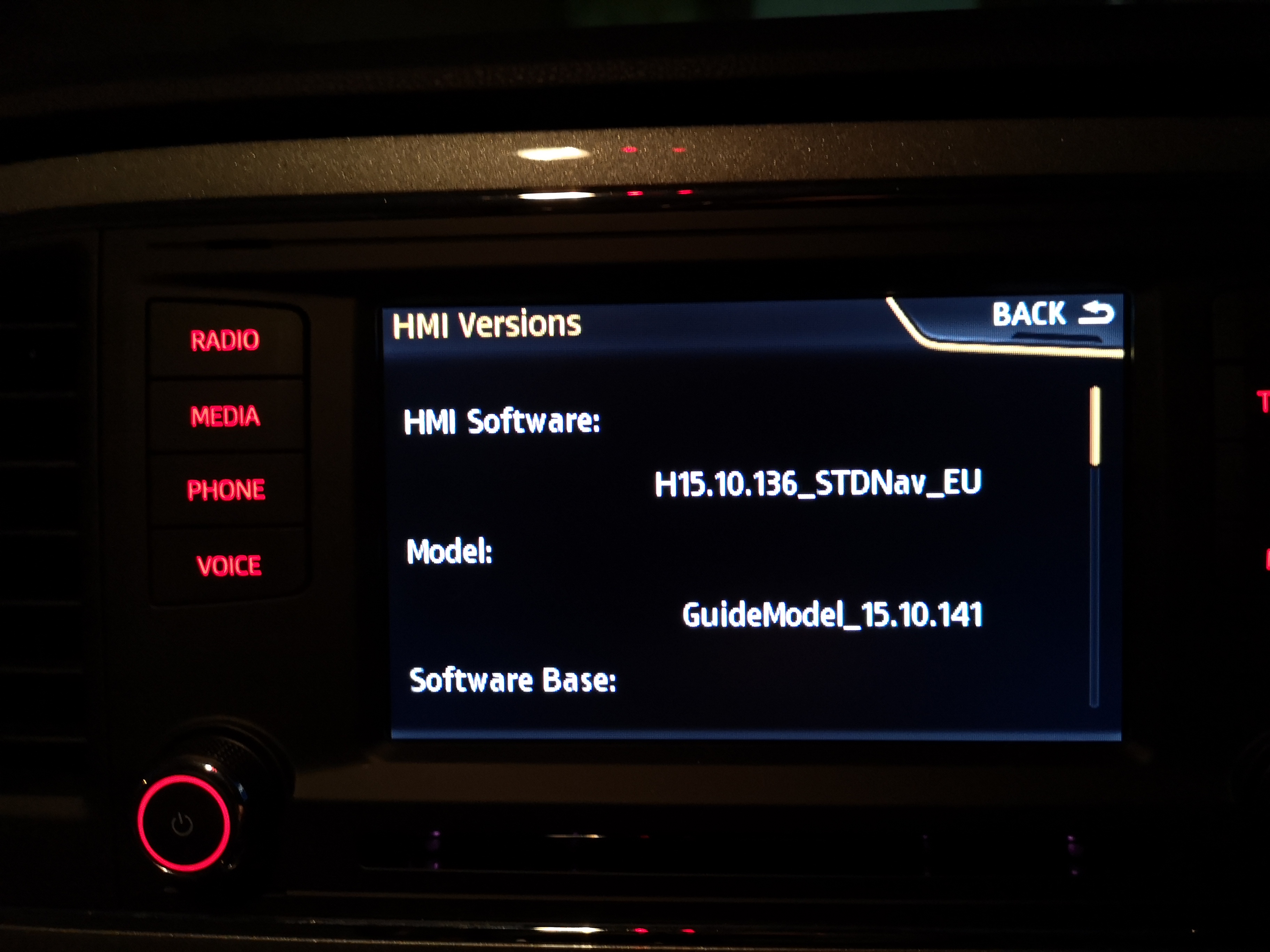

Hi, got my FR today, no idea which stereo it has and I can't see an option for full link? Took a few pics of the info. Any help would be great.

So what is mine then? The manual just says seat media system plus/ navi system
Select the Navigation screen then Setup - scroll down to Version info this will give you some details, try to post a pic.
Press Menu, settings, scroll down to System Info, this will show device part number, Hardware and software versions. Try to post a pic.

Going by the age of your maps I would say that you don't have the option of Full Link available as it's a pre mid 2015 car. Also I think you have the MIB1 unit.
With those map dates your car was probably built late 2014.
