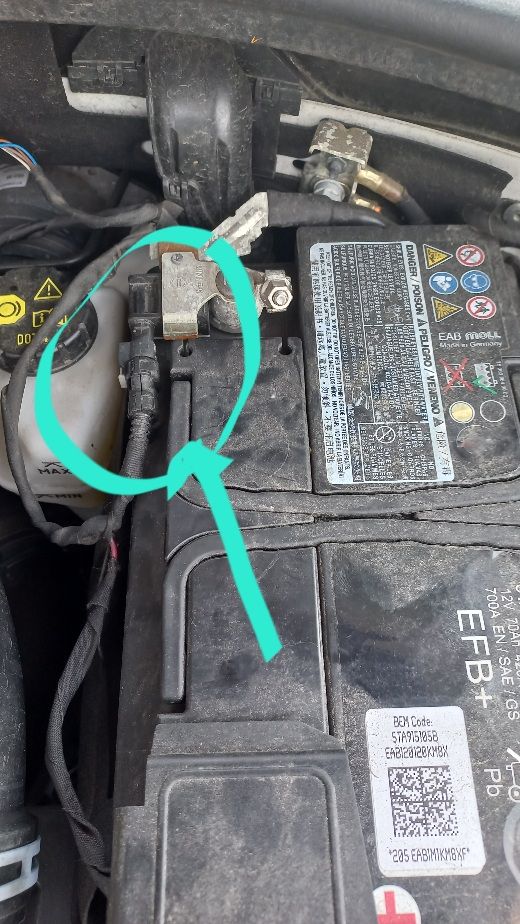

Anyways - we gone a little bit offtopic and to get this back on track I found out on other forum that you can actually unplug one cable near the battery to disable ss. Well not only ss. It also disables battery management module J367 and you will loose information about charge, discharge etc. Battery will still charge and sometimes you will get a warning on dashboard about ss but nothing will happen and after next start it will be gone so nothing to worry about.
Perhaps @East Yorkshire Retrofits could explain this a little bit better than me coz I'm not technical.
All I'm going to say about this is please don't do it ??
It's not worth ruining your battery and having an assortment of fault codes just to avoid start/ stop - especially when the cars are transmitting that fault data to seat (imagine a potential warranty claim).
Learn to live with it, or get a memory module for it. It can also be permanently disabled with a remap
