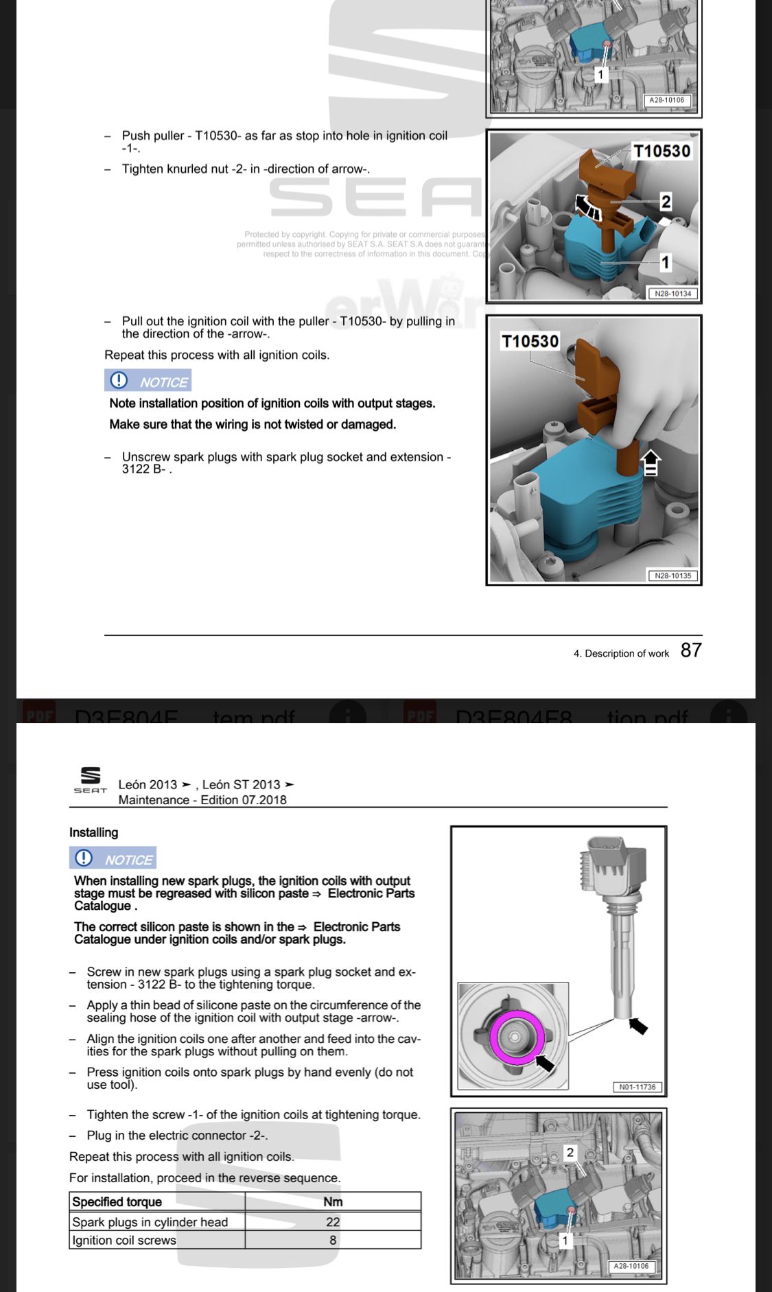

Workshop manual links are here:
Look for the ‘Maintenance’ manual and the Spark Plug Renewal section.
22 Nm for spark plugs to cylinder head.
8 Nm for ignition coil screws.
There is no figure for the gap, as the OEM plugs are assumed to be pre-gapped. There are a number of figures quoted on the net from 0.7-0.9mm with higher output engines having the lower figures. The NGK catalogue gives no figure for Seat Leon - might be worth looking for other VAG marques with same engine (note: this is also 2016 catalogue!!!):
The maintenance and engine EA211 manual states that it is easier to remove ignition coils from a warm engine due to greases applied during installation, and that silicone grease has to be reapplied to the hose on the ignition coil when refitting.

Sorry typo - silicon paste!
