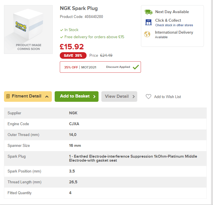

Hi All,
Im looking to change my sparks plug as Im going to carry out a full service on my car. I was wondering If I was to buy NGK ones from Euro car parts. Would I just need to buy one or multiple? Not sure how many is needed. As it's a 4 cylinder car Im guessing 4? So order 4x NGK ones from euro? Hope im making sense:LOL:
