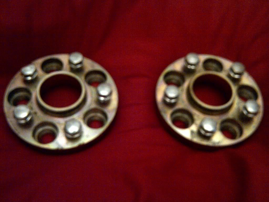

These are the company I used for both sets. They advertise 15nm but sent 20mm on 1st order so I'm guessing they have different sizes. Great seller though & they come with bolts

I thought it was unsafe to run anything over 15mm with longer bolts and that it's the ones that bolt to the hub then seperate bolts then go into the spacer that's needed.

I havent heard anything like that? Only part I know of is you need hub centric spacers for anything over 5mm. Can't see why longer bolts are an issue?!?
I've had no trouble with them!!
I'd agree with this TBH ... running longer bolts is a pain in ass anyway...

I have 15mm on front & 10mm on rear but I wouldn't go any bigger with longer bolts, I would tend to fit the ones mentioned above that bolt to the hub then the wheel is bolted to the spacer

Ok I've found a set of bolt on type 20mm spacers but I need to know about the actual bolts lol.
These ones bolt to the hub them I use my bolts to fix the wheel to the spacer, that's correct isn't it or do I need special bolts???

Can't read that thread mate... But yes get ones that bolt to hub and wheels bolt to spacer... Also means keep locking nuts!

Thats what i'm waiting on, the guys telling me the bore size. I'm right on saying it has to be the same 57.1mm bore size on the inside and outside of the spacer???
