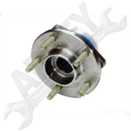

Make sure their Hubcentric, and that they bolt onto the hub and you bolt the wheel to the spacer.
If their just non hubcentrics steer well clear
and if their ones you bolt THROUGH then you need longer bolts over 4-5mm to be safe!
