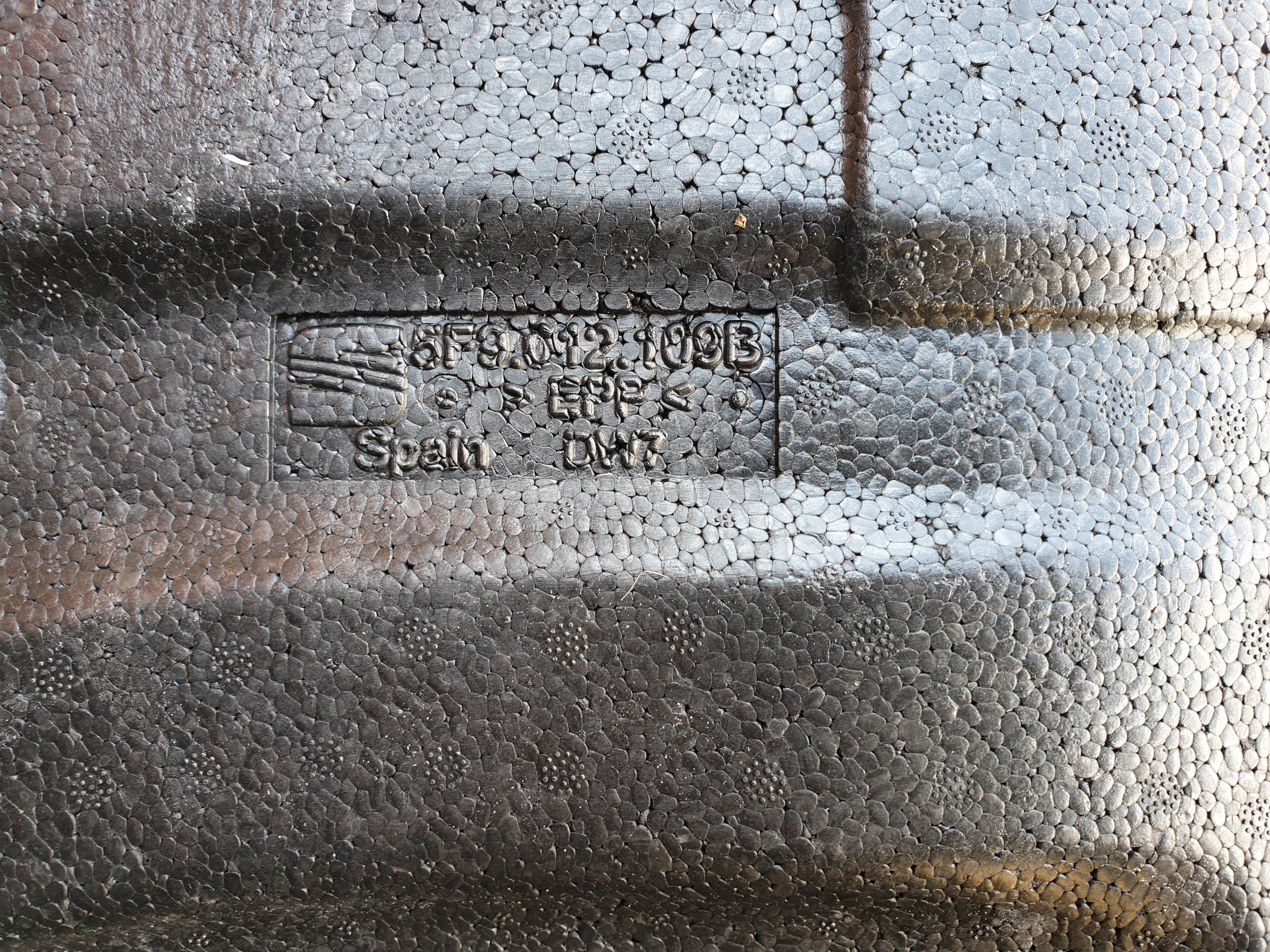

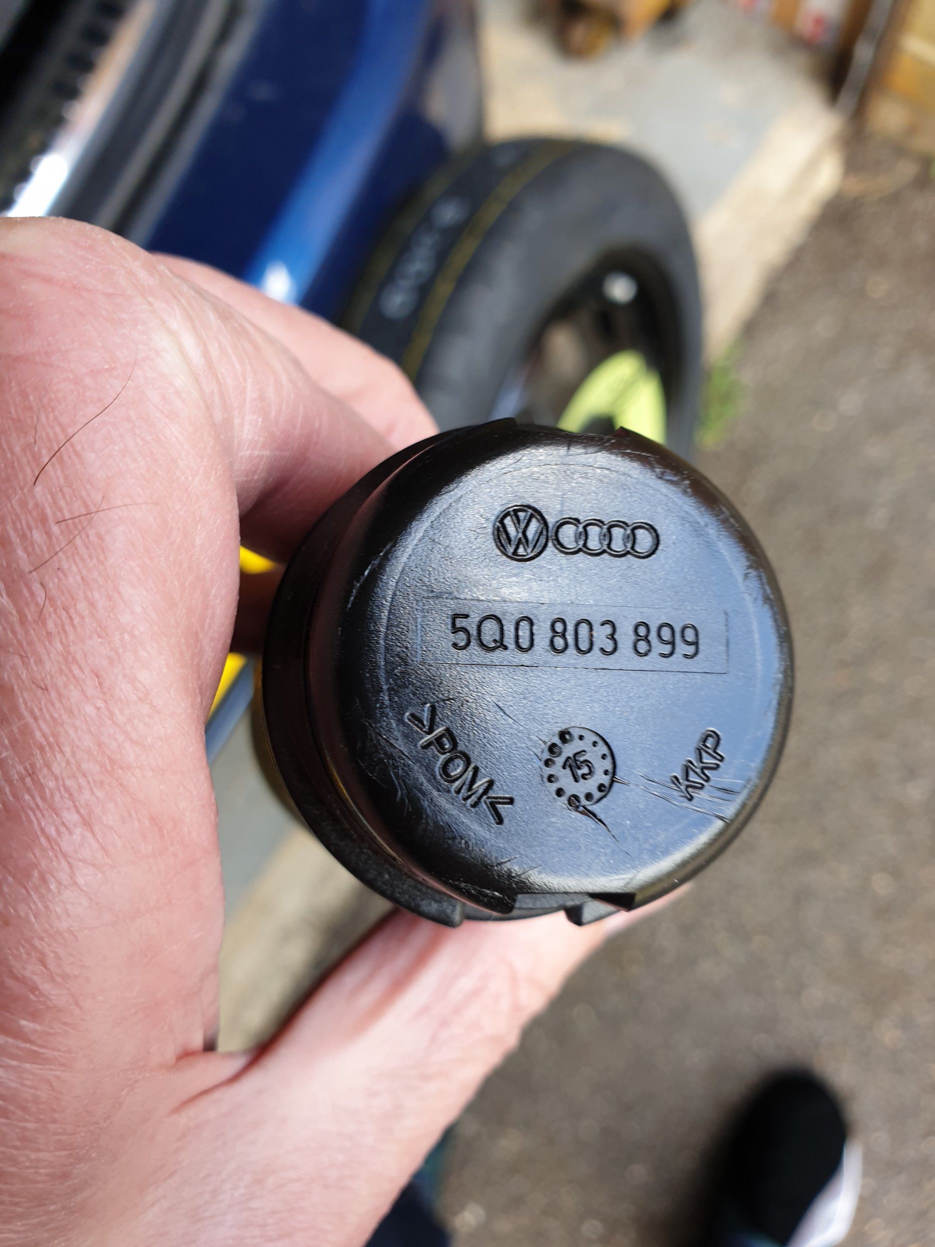

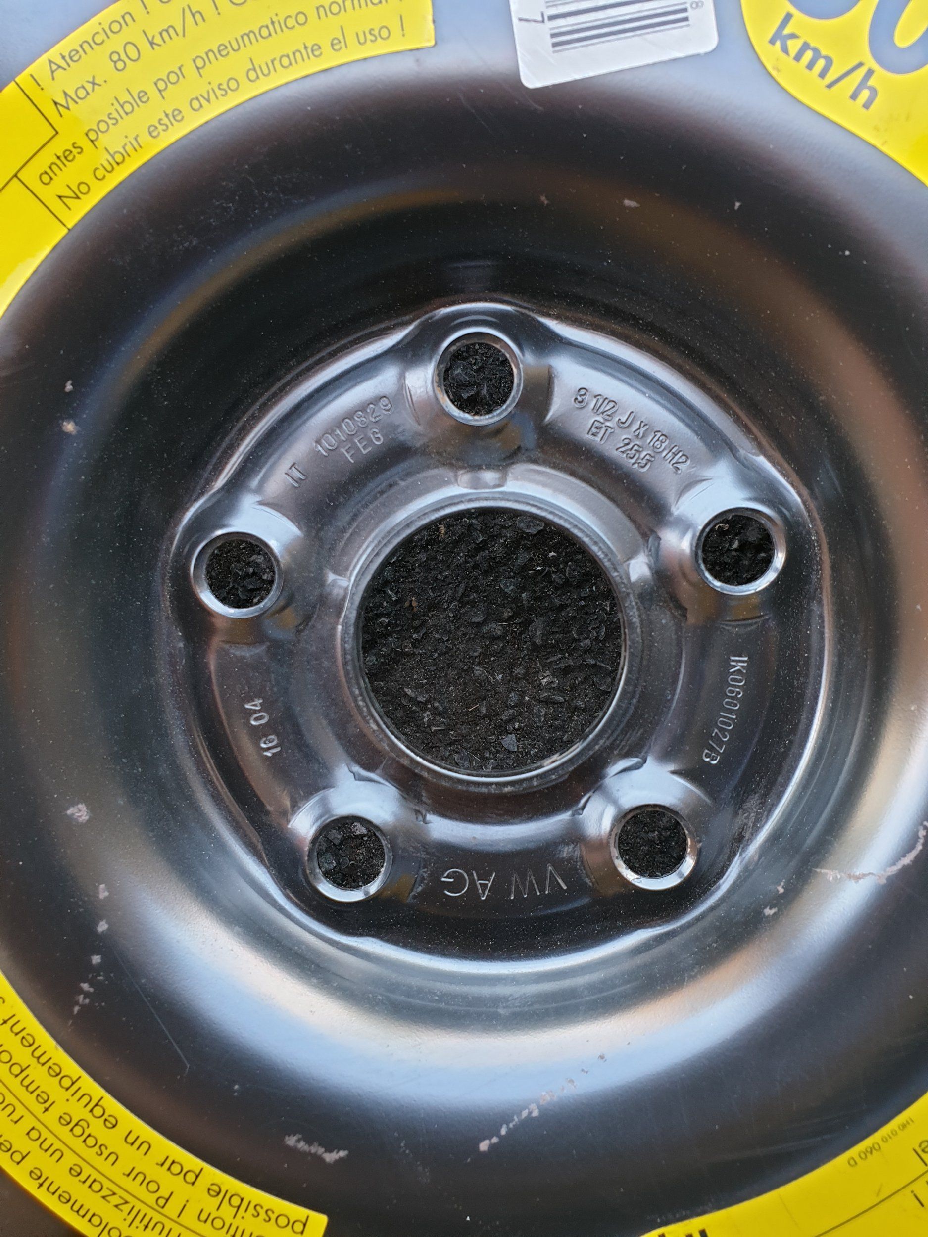

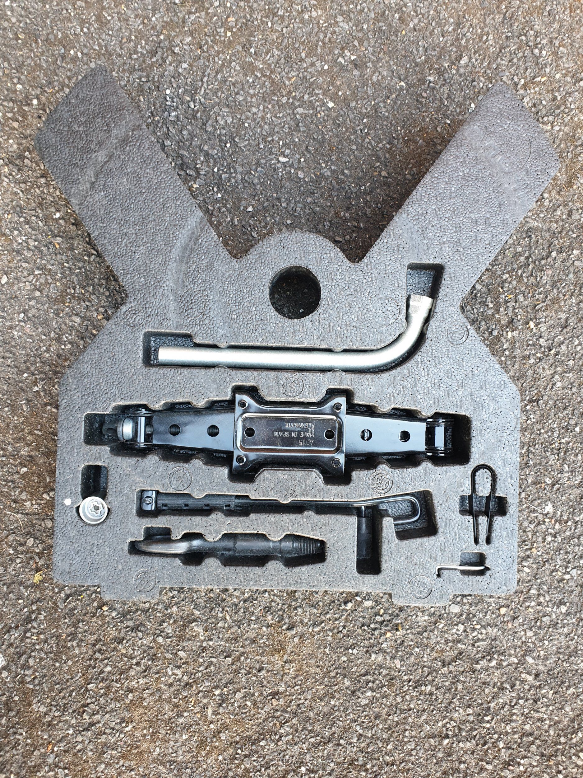

This is what you need for an ST, https://www.ebay.co.uk/itm/SEAT-Leon-Estate-ST-18-Spare-Wheel-Tool-Kit/252603788863?_trkparms=aid=111001&algo=REC.SEED&ao=1&asc=20160908105057&meid=6e00649a90e741e3b969da79bbaccea2&pid=100675&rk=1&rkt=15&mehot=none&sd=274452294637&itm=252603788863&pmt=1&noa=1&pg=2380057&_trksid=p2380057.c100675.m4236&_trkparms=pageci:56c96d18-da3e-11ea-9784-fa4d7d58a703|parentrq:d34207481730ad397e690d75ffffb654|iid:1
The 18" space saver is much closer to the rolling radius of the 17" wheels than the 16" space saver, also if you wanted to fit Seat Sound then you would need the 18" space saver to fit the subwoofer into. 20200522_130444.jpg20200513_144505.jpg20200513_144429.jpg20200513_144757.jpg
