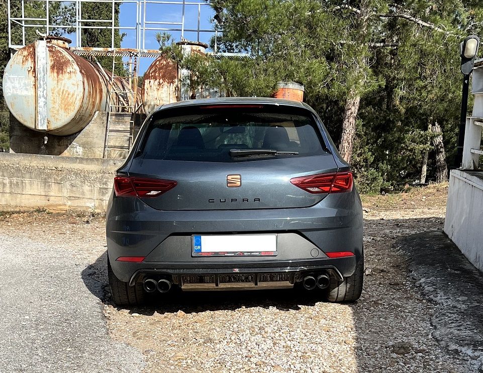

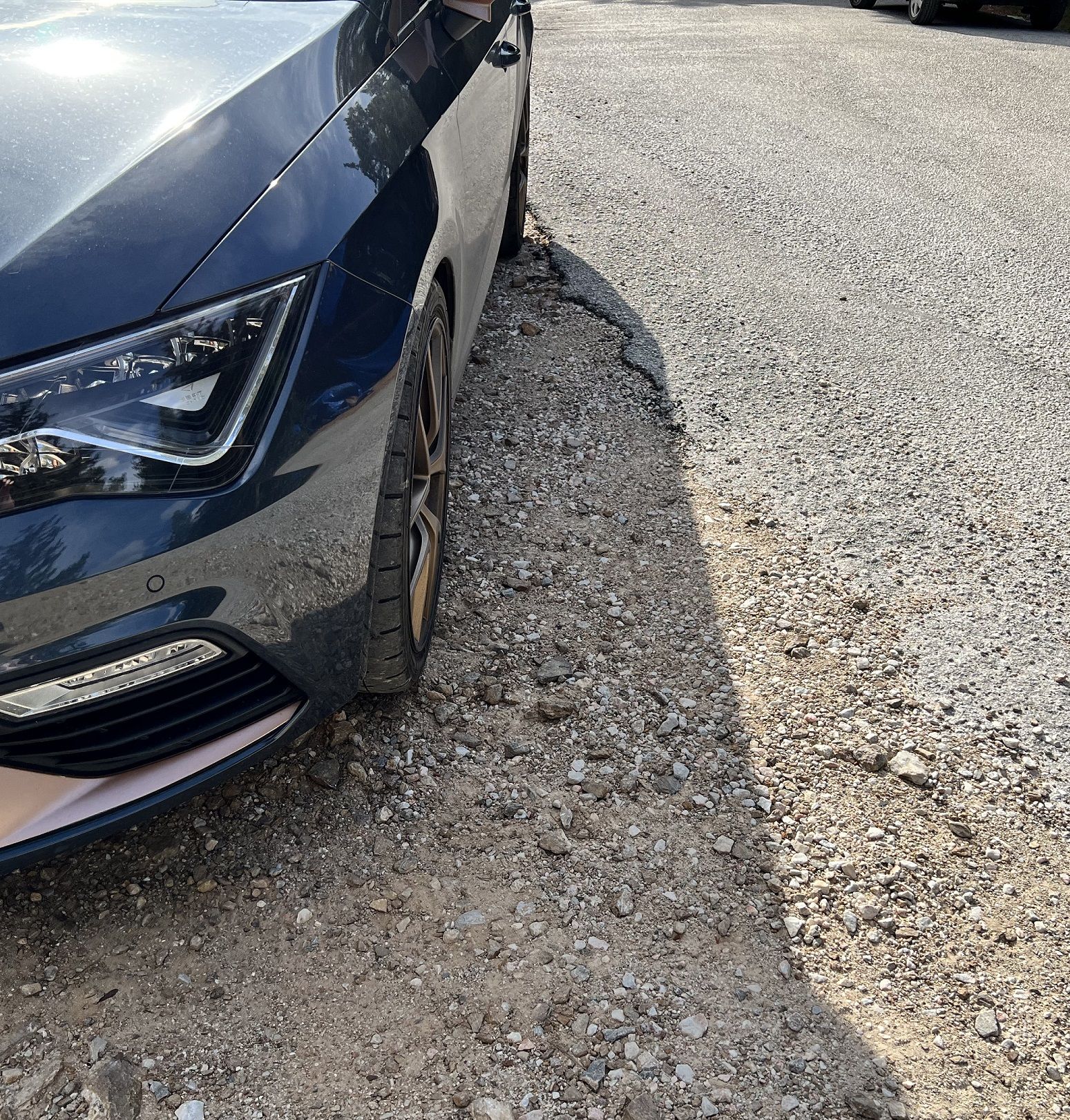

My current wheel setup is 8.5*19 ET45 wheels with 245/35 tires. Car isn't lowered or has spacers. At first it rubbed like crazy on these little plastic arch things, and I don't mean when falling in a pot hole or anything but any time the road wasn't a smooth as a racetrack. Since I had them removed it still rubs but rarely.
