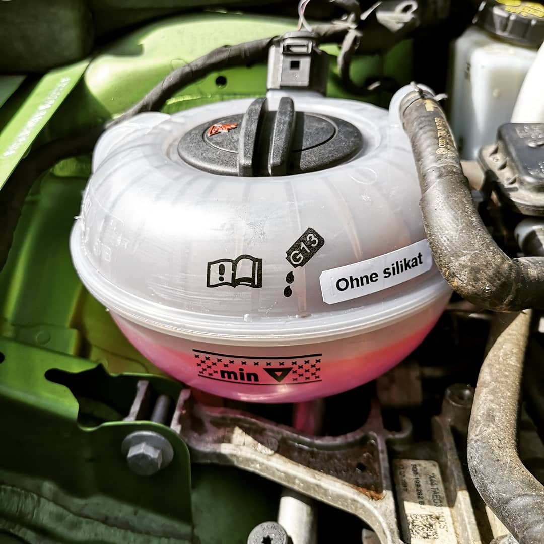

silica grain in the header tank

I thought that someone had confirmed that at some point in time, these bags started to get replaced with a better form of container for the silicate granules - I thing that I read that in this forum, as to what exactly that means to those without "mit silikat" or just the original bags that might just break open, I can't say, just another variable to add into the increasing slight confusion - with still no good trustworthy "resource" quality statement available.
Using facts from Halfords or ECP to select a version of VW Group equivalent coolant is at best very risky, if collectively "we" can't get a good grip on this, they certainly will not.
Edit:- I'd expect Halfords and ECP just to correctly suggest which by build date, or very roughly by reg date, version of G11, G12, G12+, G12++, G13 VW Group could/should have used at initial factory fill. I'd doubt if G12evo is on many aftermarket suppliers lists yet, but will get quoted by the supplier of the base coolant that VW Group uses.
So I understand that it’s supposed to be g13 in my car? However it’s a pink colour which I believe should be purple? Any idea if I need to top it up a pink colour OAT for Halfords or ECP might be alright?

I’ve rang a local Seat Garage and they basically just said either pink or purple OAT are the same thing so just wack whatever in, if you’ve got pink in then use that, apparently the purple is more of a VW thing to maybe get some more money, so if you buy off the shelf then pink will be fine, apparently Seat often use this themselves anyway, which is probably why mine is pink
Joshua Oakes
Apr 30, 2020
62
16
My coolant bag is out, no signs of excessive wear so I’m going to assume no compromise already, didn’t drain tank or change, just pulled it out with some long nose plyers

I replaced my expansion tank on Saturday to eliminate the silicate bag. The bag on mine wasn't removable, the tank is double walled and the bag is between them but it was only £30 delivered so no real biggy. I'm just going to get my coolant changed and then do it every three years or so if I still have the car.
Mind you, the system is pretty efficient at drawing the coolant from the tank and circulating it back into the engine so by emptying the tank every couple of trips and refilling with new coolant mix, you'd get a decent turn over of coolant that way. I might do that just until I polish off my 1.5L bottle of G13 concentrate.

Just to add some more info to the mix I bought a 1.5L bottle of Febi-Bilstein G13 concentrate (G13 is supposed to be purple) and it's a very luminous bright pink :unsure:.

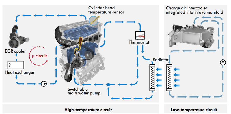

@Woody_72 thanks for that, when the heater matrix gets swapped i will get mine removed. Any idea why a blocked heater matrix causes coolant to be purged from the header tank?
In a nutshell - when your car does a DPF regen the DPF gets super hot (600+ degrees C), as well as the EGR. The EGR cooler uses the heater matrix circuit to cool it down afterwards and because that is blocked it basically boils the coolant and that escapes via the overflow/high pressure release under the header tank cap.
The EA288 has 3 cooling systems and the DPF/EGR run off the smaller heater matrix ("exchanger") system.

@Brian Gordon-Stables that is a great explanation i fully understand now (y).
Mmm, when I was reading up on all the G' coolants I read that G12 & G12+ were pink and G12++ & G13 were purple... Could I have had G13 in my system all along?
But manual does state it should be purple..!
Woody_72
May 10, 2020
502
253
Northwest England
Confusing isn't it ?. Depending on the brand of your coolant it may well be G13. G12, G12+ and G13 are compatible anyway (in terms of doing no actual harm, it's better to use one or the other ideally) so no harm either way.
