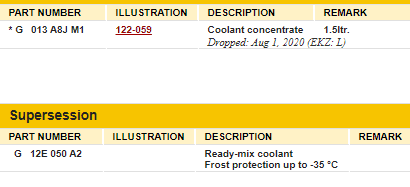

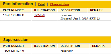

Yes - G12Evo (TL 774-L ~ G65) is VAG's latest coolant - replacing G13 (TL 774 J ~ GG40)
5Q0121407G is MIT (with) Silicate
5Q0121407M is WITHOUT Silicate
So this switch in header tanks to without silicate repository also correlates with the change from G13 to G12Evo coolant! maybe G12Evo has more silicates in it? I can't find a spec sheet for this.
I can't find info about any service schedule regarding changing your coolant on pre 2019 or post 2019 - just to check level and top-up if required!
Reading between the lines! I would suggest it is best to use G12Evo coolant if you switch to a header tank WITHOUT silicate repository.

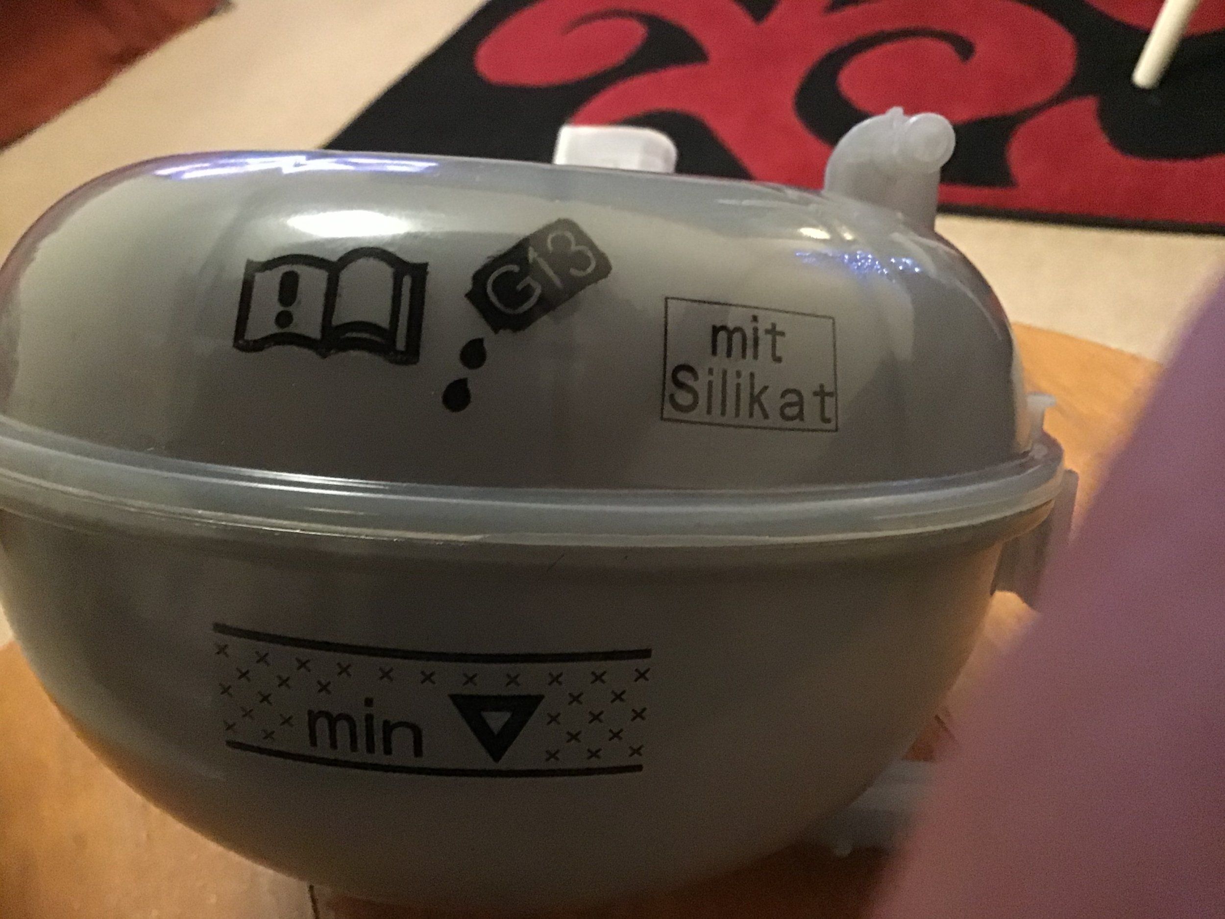

Parts arrived today from Germany but the expansion tank has the silica bag inside..... do I try and take it apart and remove the bag or just fit it as is?
I'd leave it in, unless it's easy to get out. I doubt the bag will fail in the next couple of years and you can always swap it out for one without a bag in a few months if you want piece of mind.

I think that you, if you are concerned, need to ask to ask your dealer why this tank with "mit silikat" is being fitted now that G12evo is being used as a coolant.
SuperV8
May 30, 2019
1,723
823
Agree - but the latest version of the tank (M suffix) is without silicate bag - what is the part number of this tank? Is it after market of original equipment?
Dangerousdean
Nov 29, 2020
7
These are the part number for the expansion tank and heater matrix

Mine just got changed at SEAT main dealer to non silicate tank, will get part number tomorrow and update
Dangerousdean
Nov 29, 2020
7
£60 from autodoc in Germany took nearly a week but I think it’s going to be worth it, that was for both matrix and bottle
