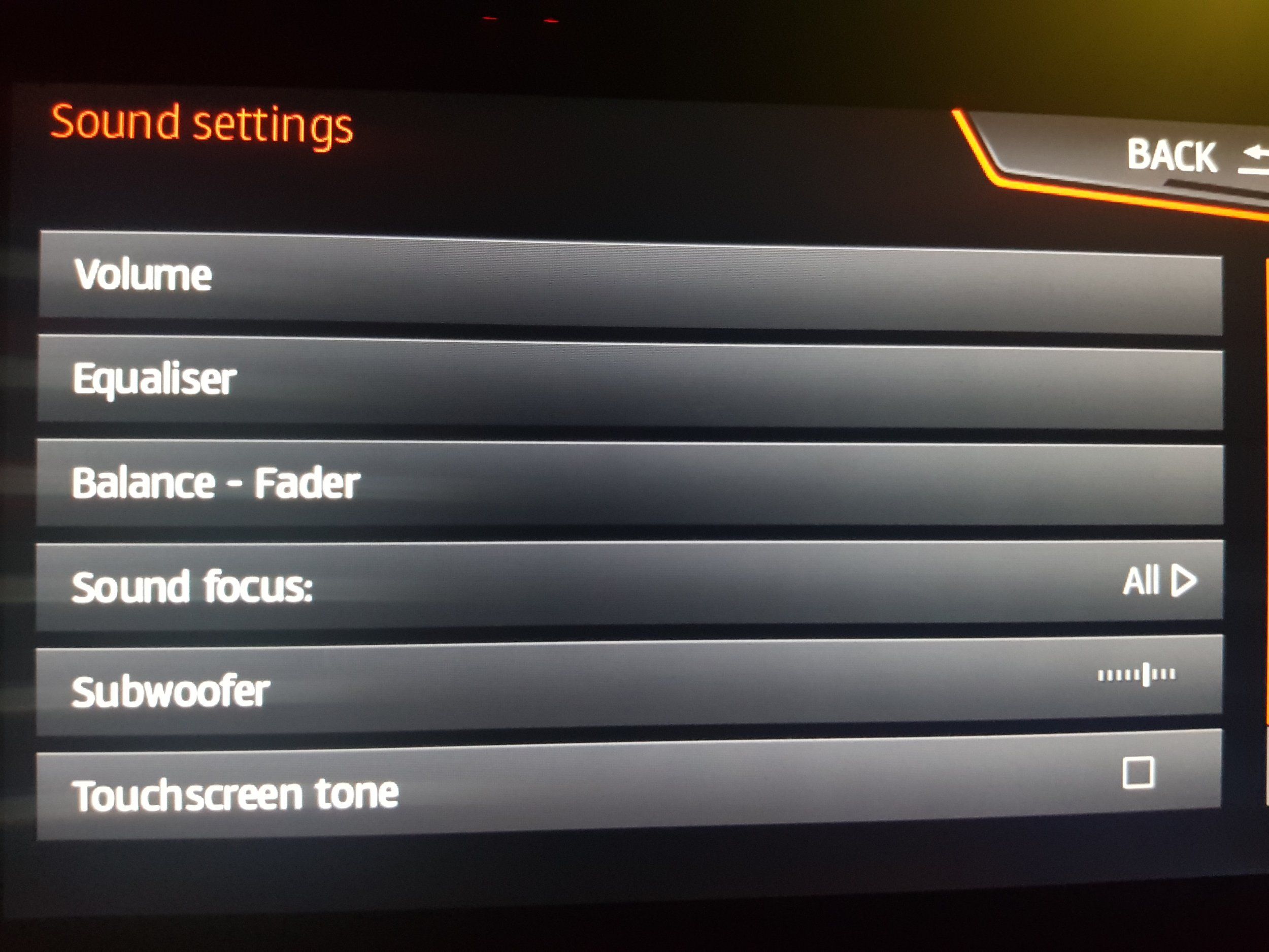

No it won't sound better
It removes low frequencies from the door speakers to send to the subwoofer. If the subwoofer isn't there - neither will the low frequencies be :(
You could likely take the high level output destined for the subwoofer and feed an amp with it if it has a high level input, or convert it for an amp without

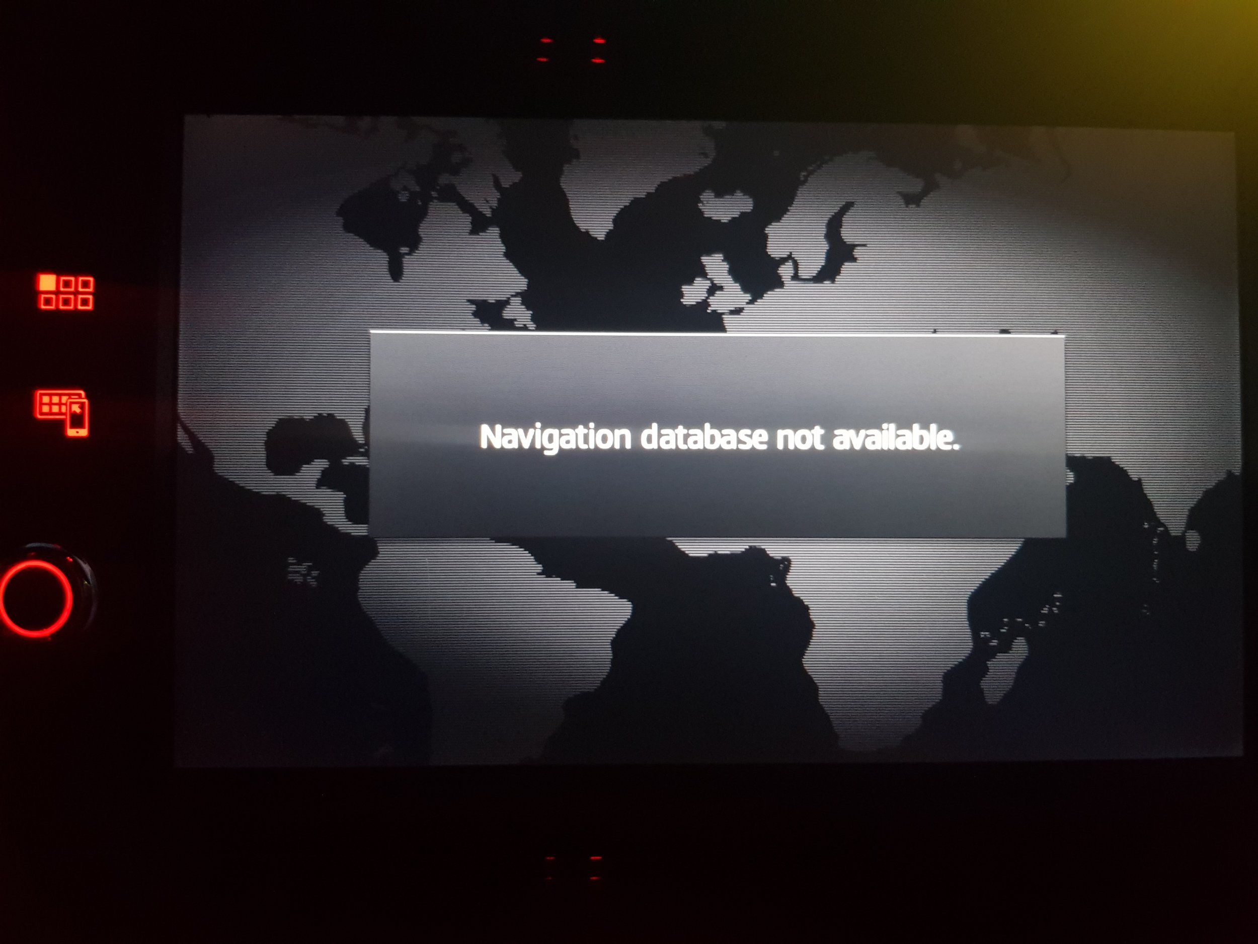

I retrofit fitted this without the sub, and i am using mib 2 upgraded, not sure what version but its the preh radio, component protection removed and coded to the car but satnav needs activating, how much would be for your help ?
If you've had component protection removed then all of the features should have been disabled. So how come you only need nav activating?
Also seat sound without the sub? 😕
I had 5F0 035 858A i assume is mib 1 , had satnav and dab, i upgraded to 5QA 035 874,
£80 for Component protection removed and he coded it to the car but could not activate satnav, he did say coded seat sound, i bought the sub but didn't fit it because i want the satnav active first.
DAB, Bluetooth,vehicle settings, works but voice control, satnav no are not avaiable he could not activate it, he used odis to remove protection, i am using the 8inch screen he sold me £130
I'll message you

The sound system i am not sure yet as i didn't connect the sub yet as don't have cable, was going to order one from ebay but delivery is over a month, seller is away and it shows delayed plus coming from china, not sure where to get the cable.
