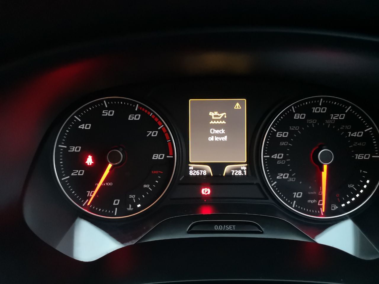

Hello,
I have this Seat Leon Estate and had this warning message on the dashboard 'Check oil level' since last year which I got my garage to take a look.
I picked this issue up again as I want to resolve ahead of selling the car so got the garage to do an oil service (changing the oil and filter) and the oil level and pressure sensor and still kept getting this warning message every time I start the car. The oil was topped up and using the dip stick measured and still getting the same error.
The garage seems to think it is linked with the ECU as they checked everything and nothing else came up on the fault codes to suggest it could be linked with any of the oil sensor issues.
Can anyone suggest any ideas on what to do next as I want to sell the car and do not want to spend too much money in resolving this issue.
Thanks
Check the video at the link below, it may seem irrelevant but it seems helpful for a similar situation.
