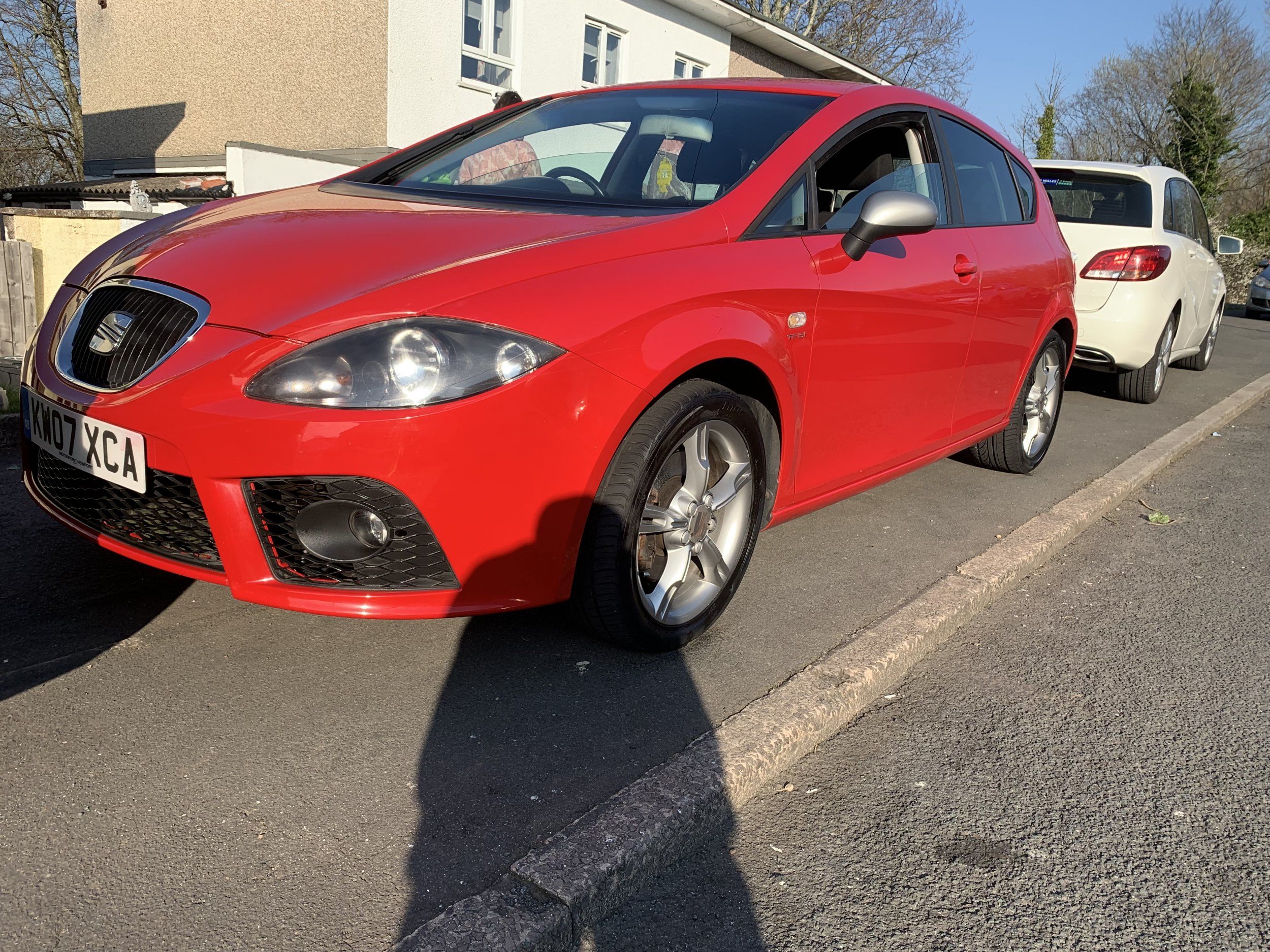

Sounds like you’ve got a good one low millage and 1 owner sounds like a keeper. Have you got any photos of it?

To be fair it’s in really good condition and although it’s down in the years it’s really clean and seems to have been well looked after. It’s completely standard at the moment, I’ve not got any good pics but I’ll take some tomorrow if I’m home before it’s dark tomorrow and put some up.

There’s my car, completely standard for now.
