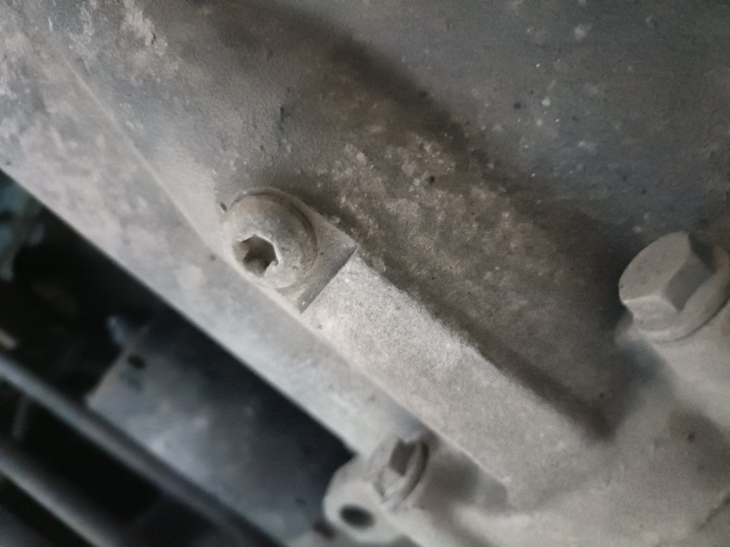

Hi, I'm trying to change the oil on a MK1 Leon, used 17mm hex on the side, is this the drain or fill bit? Confused where to empty and fill

Drain at the bottom, fill at the front(when the car is set at level, as soon as the fluid runs out the opening, it is filled to the required level)

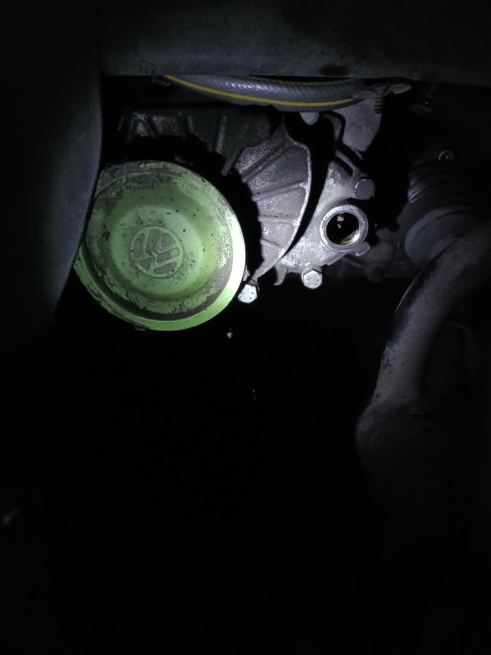

I can't find a hex 17mm at the bottom though, picture below of the bottom, can only find the one on the side where I've removed the bolt

Sorry, I assumed you had an 02J box, but apparently you have the old style box..
Check out this vid, starting from 3 minutes:
