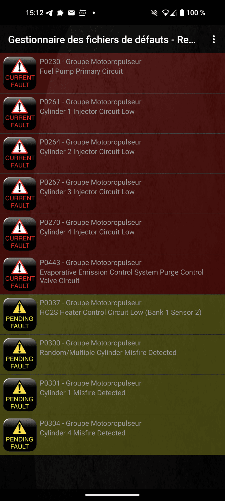

OBD Scanner gives me this time another (what seems to be) more serious issue:
P0261, P0264, P0267 and P0270 issue which are "Injector Circuit low" on my 4 cylinders. (eventually a P0443 that seems to be no related).

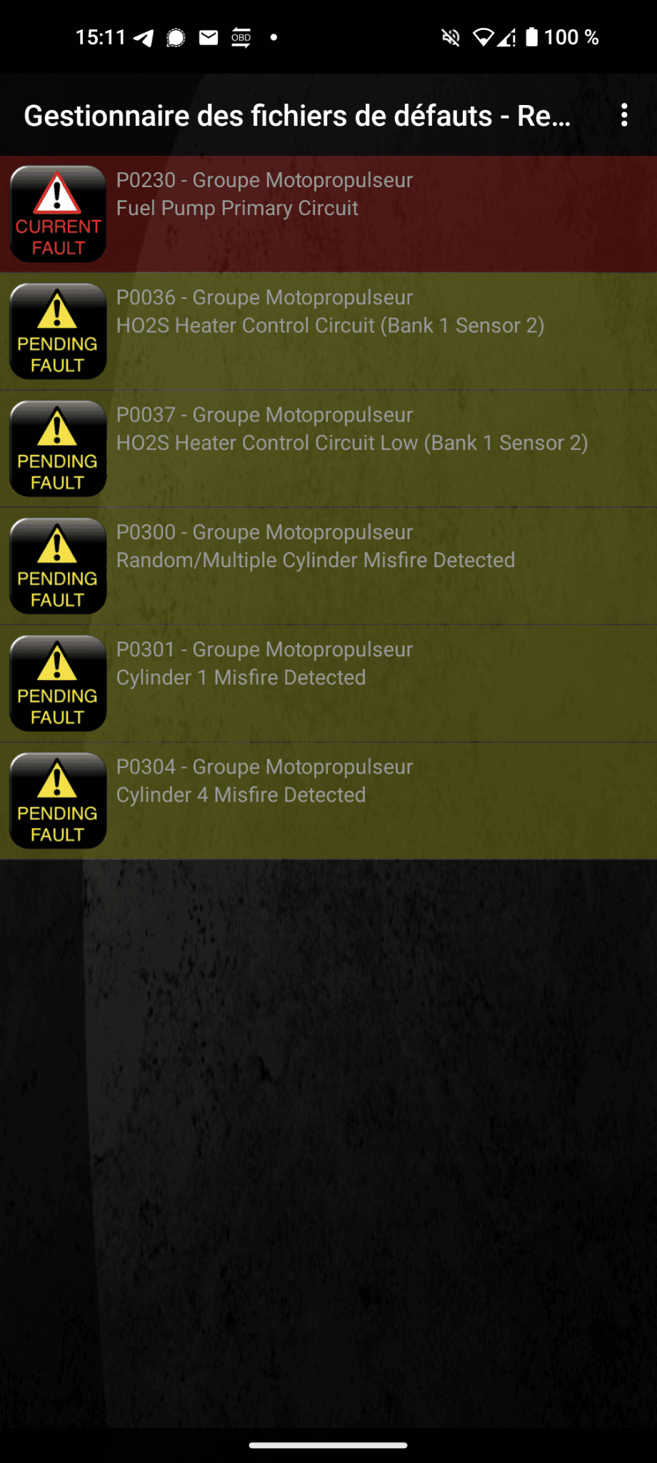

Start my car no issue, OBD tool gives me this while engine is ON (this P0230 appeared since a month):
After 30 seconds, engine turns off by itself.
Then I'm unable to start car again.
OBD then again gets back to usual error code that I had:

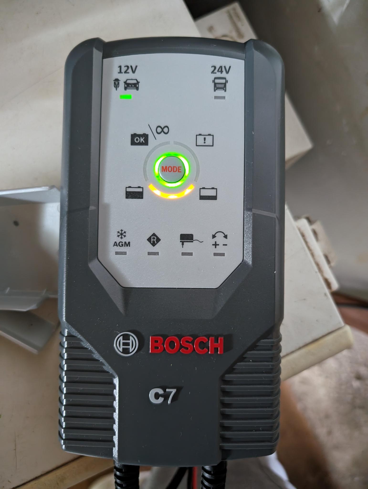

I remove battery put it back on charger. It says again that battery is flat, that I have to charge it. Within 5 minutes here are the results when battery is on charge with my C7 charger. It actually surprise me it goes that fast, it seems strange.

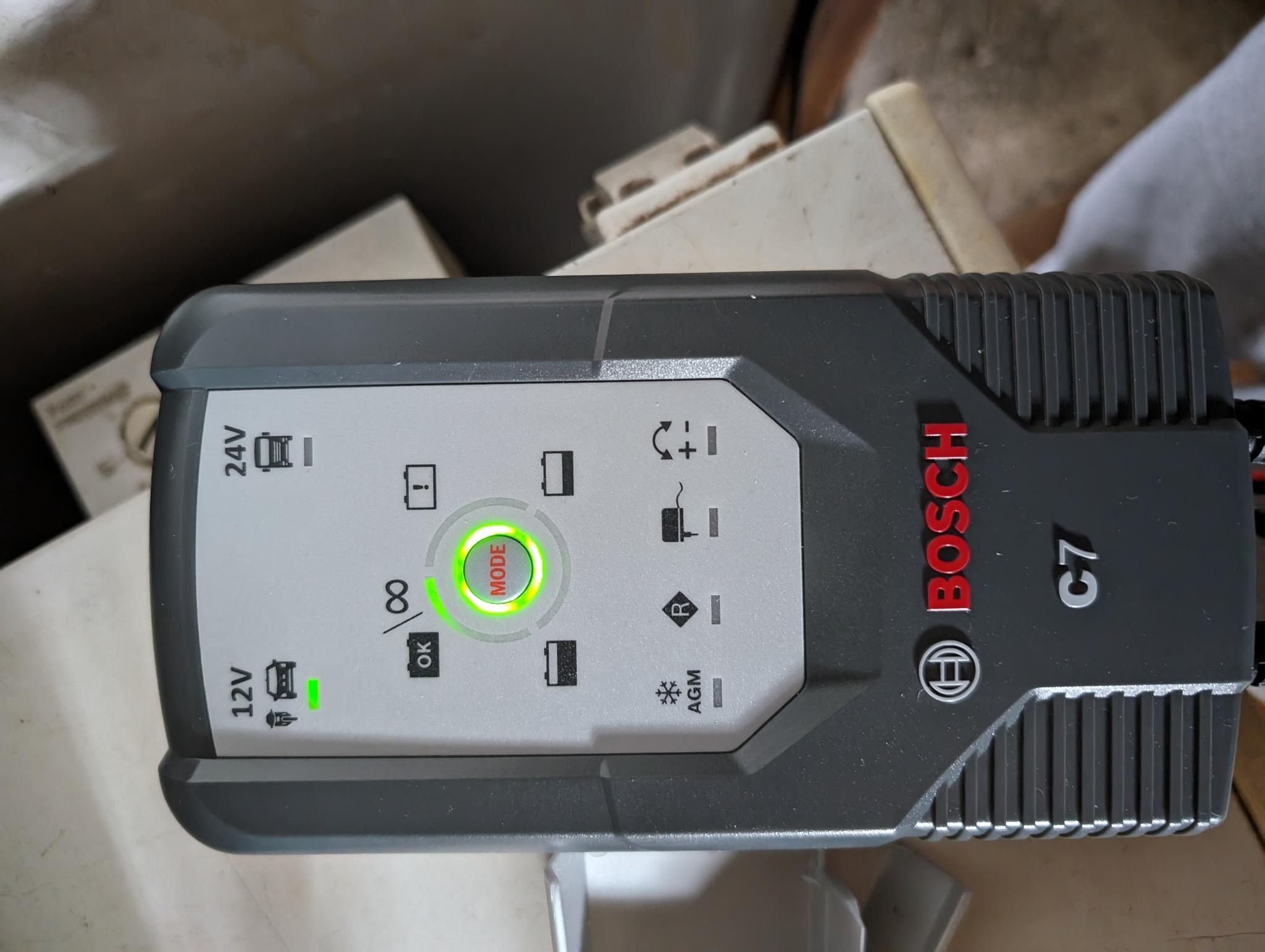

Then after 10-15 minutes battery is seen as full, and charger gets to "trickle charge mode":
For information, I used mode 1 here, and here the description manual of how the C7 charger performs the charging : https://www.modesdemploi.fr/bosch/c7/mode-d-emploi?p=22
Here the lights meaning : https://www.modesdemploi.fr/bosch/c7/mode-d-emploi?p=24

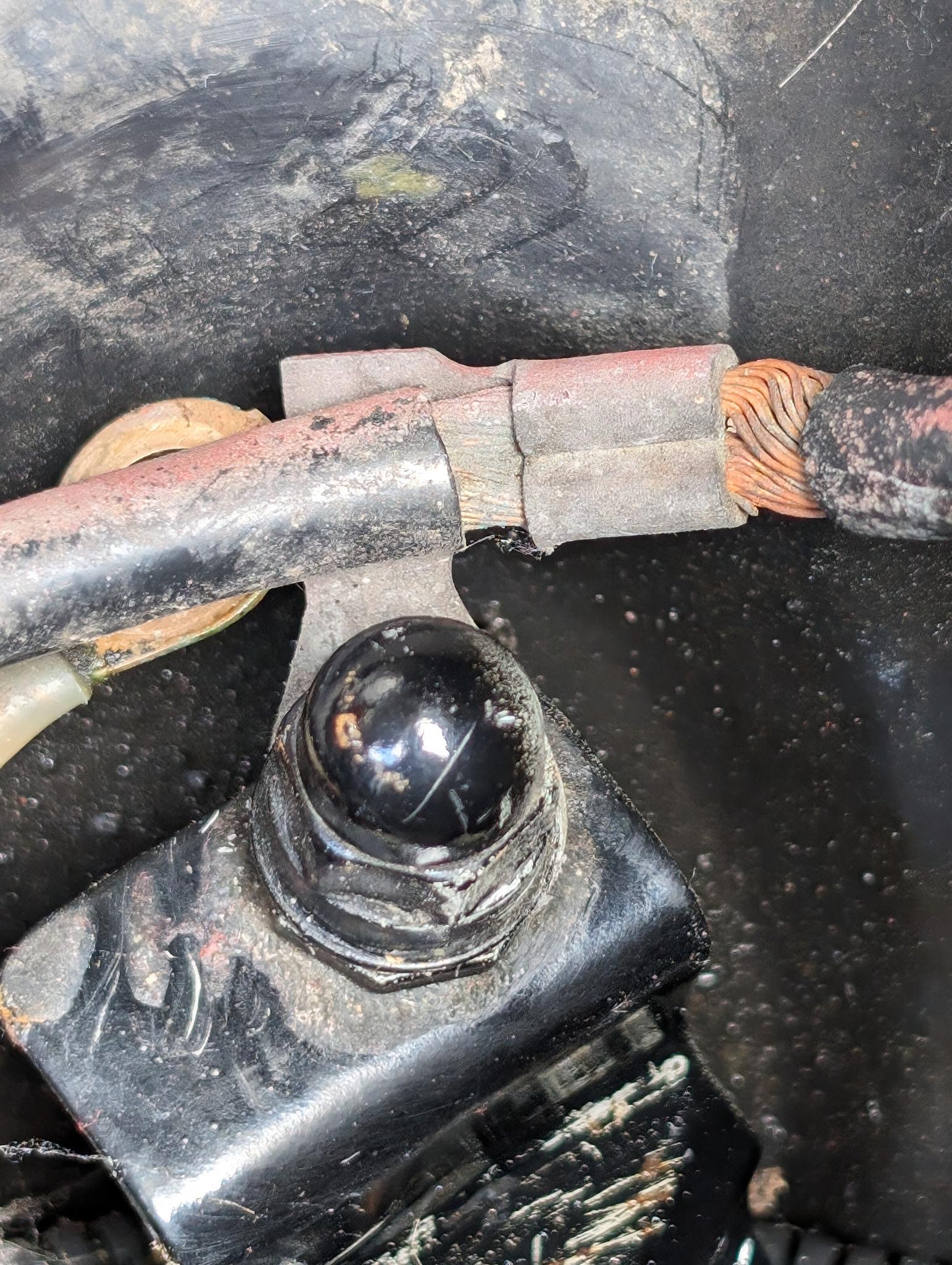

I clean the body ground that goes from battery negative, it didn't have rust or anything, only a bit of oil/grease. this right wire goes straight to battery negative :

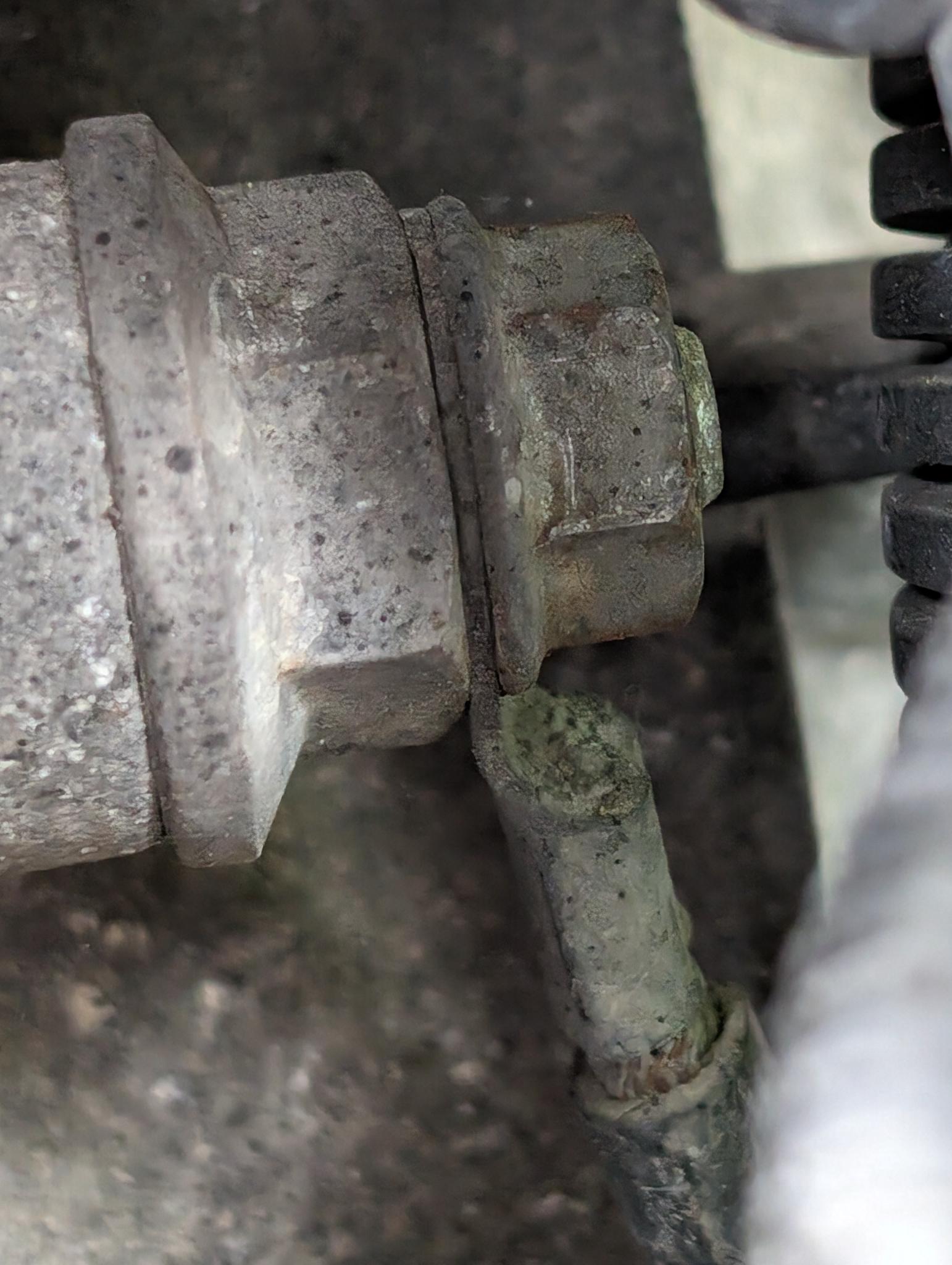

Check the main ground/earth wire which runs between the engine block and the body of the car
Seems to be the exact same wire on my car, battery negative <=> body car <=> engine block, this wire goes straight to this "left wire" shown on the pic upper.
Cleaned it, looked already nice also to me(this pic was taken before cleaning it)

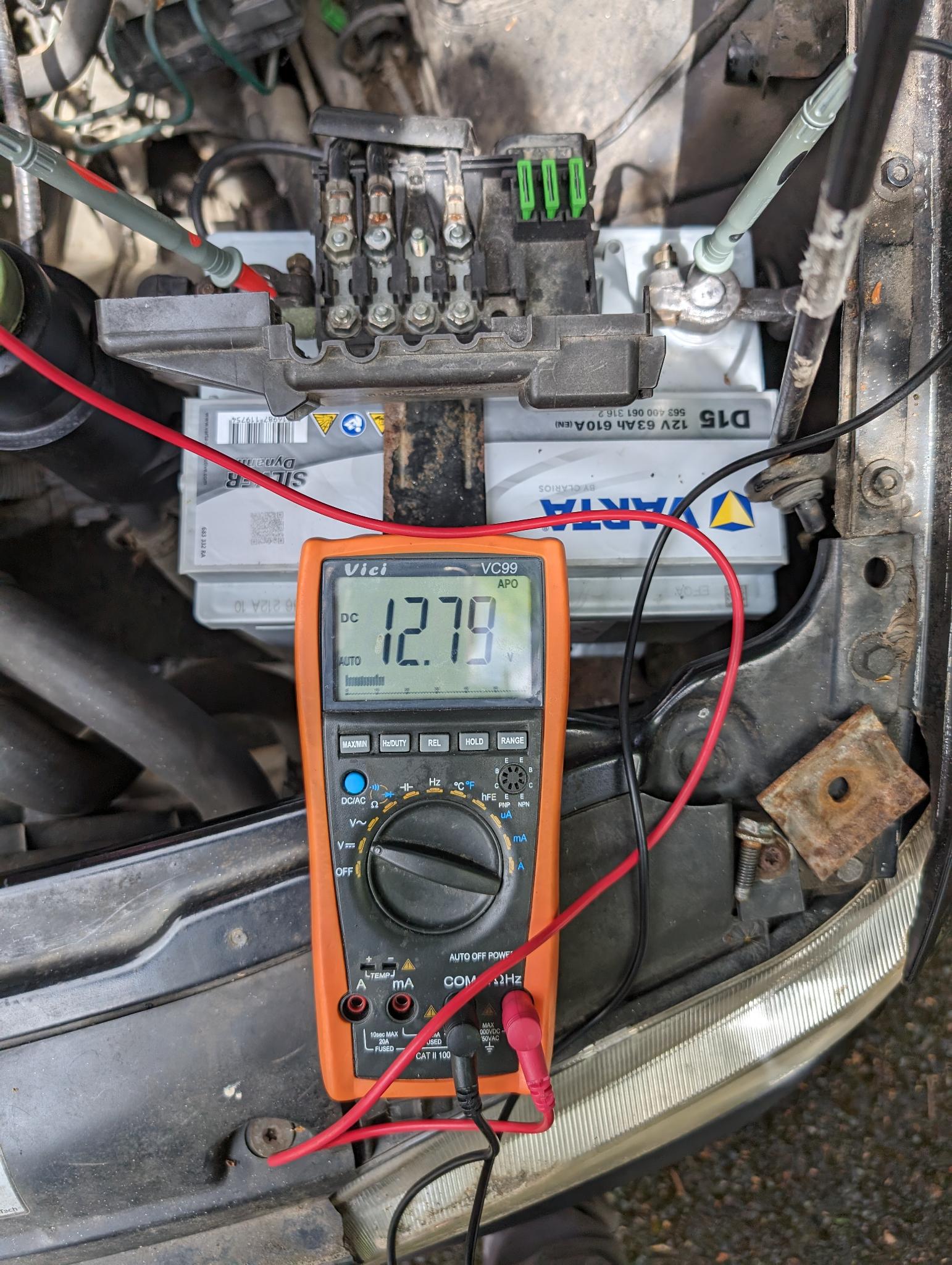

After another full charge of battery, I put it back in place. I check if there is current leakage => Nop, only about 0.3mA when everything is off, that seems normal.
I plug other end of battery. Voltage is at a steady 12.80V.
I put ignition on, battery slowly drops to 12.47V (in 1-2 minutes), until I start engine of the car. Voltage drops to 10.47V then goes back within 5 seconds to 12.25V. The oil light lights up. I have this issue since a while(2 years), a sensor probably sending wrong values to the car. I'm just under the maximum level.

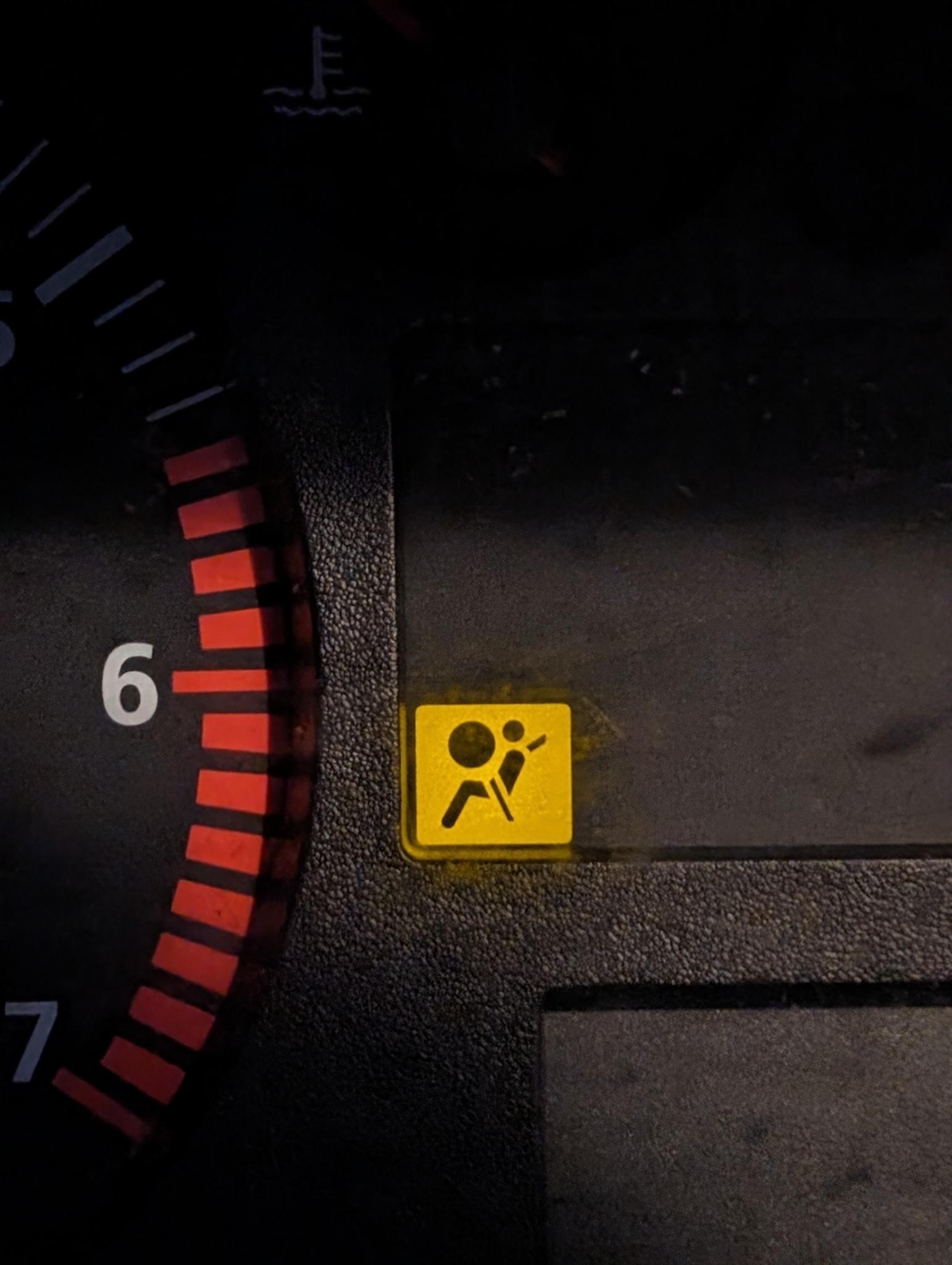

I went back to my car to check again what could be wrong. As it's late in the evening I immediately saw the "Airbag warning" lights on my dashboard. Always. Even when car is closed and no key got inserted. Voltage of my battery is now at 12.55V when no key is inserted.
I remove negative side of my battery, did the current test again, exactly 0.33mA and the airbag warning light gets on again.I'm gonna check in this direction.
No error code on my cheap OBD scanner got me in this way though...So maybe the light just showed up recently ? Or I wasn't being careful in daylight, and my OBD scanner can't deal with this airbag error code so it doesn't even shows them.
Could it be just that as engine have troubles starting, this light shows up after some attempts without success ?
I checked quickly I couldn't see any airbag fuse at the emplacement of the fuse box I was checking. So I can't for now turn it off and see how car reacts. I removed negative lead on my battery for the night. Investigation will keep going tomorrow :)

If the battery is going flat and you are connecting and reconnecting the it, then it's normal for an airbag to come on. It's probably just a code for low voltage. I'm not sure why it would be illuminated without the key in the ignition though. That seems weird. When you have enough on/off cycles without any faults, it will usually clear itself.

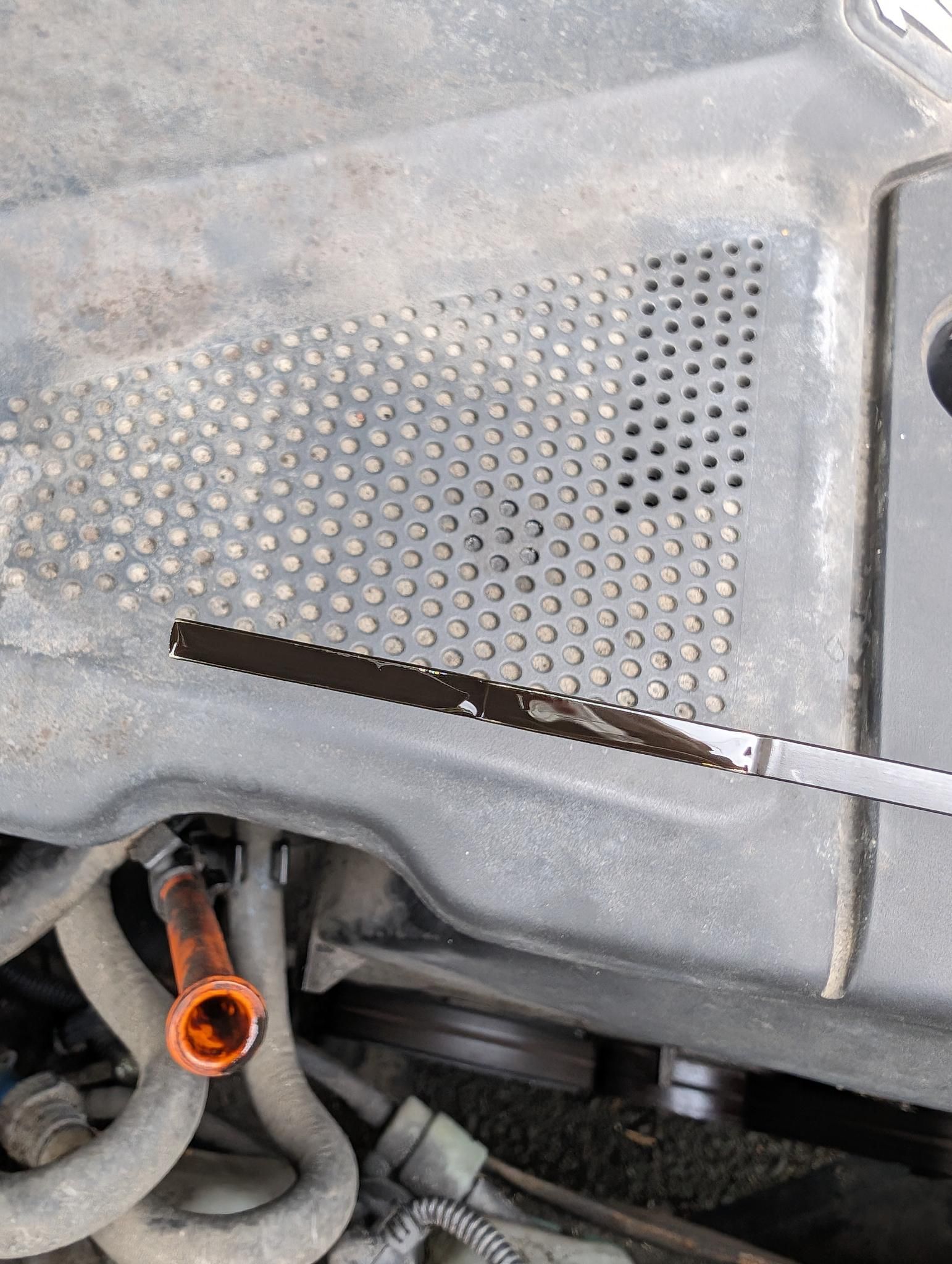

As for the oil light that is usually oil pressure not oil level, you need to get that sorted. If that's been on for 2 years then it must be a faulty sensor, or if you didn't have oil pressure it would have been long dead. If it's not starting then i would check you have fuel pressure and spark

No airbag light this morning you were probably right :) Then question would be, why with a battery at 12.55V this light would turn on as low voltage condition as it seems I was never in condition of ?
