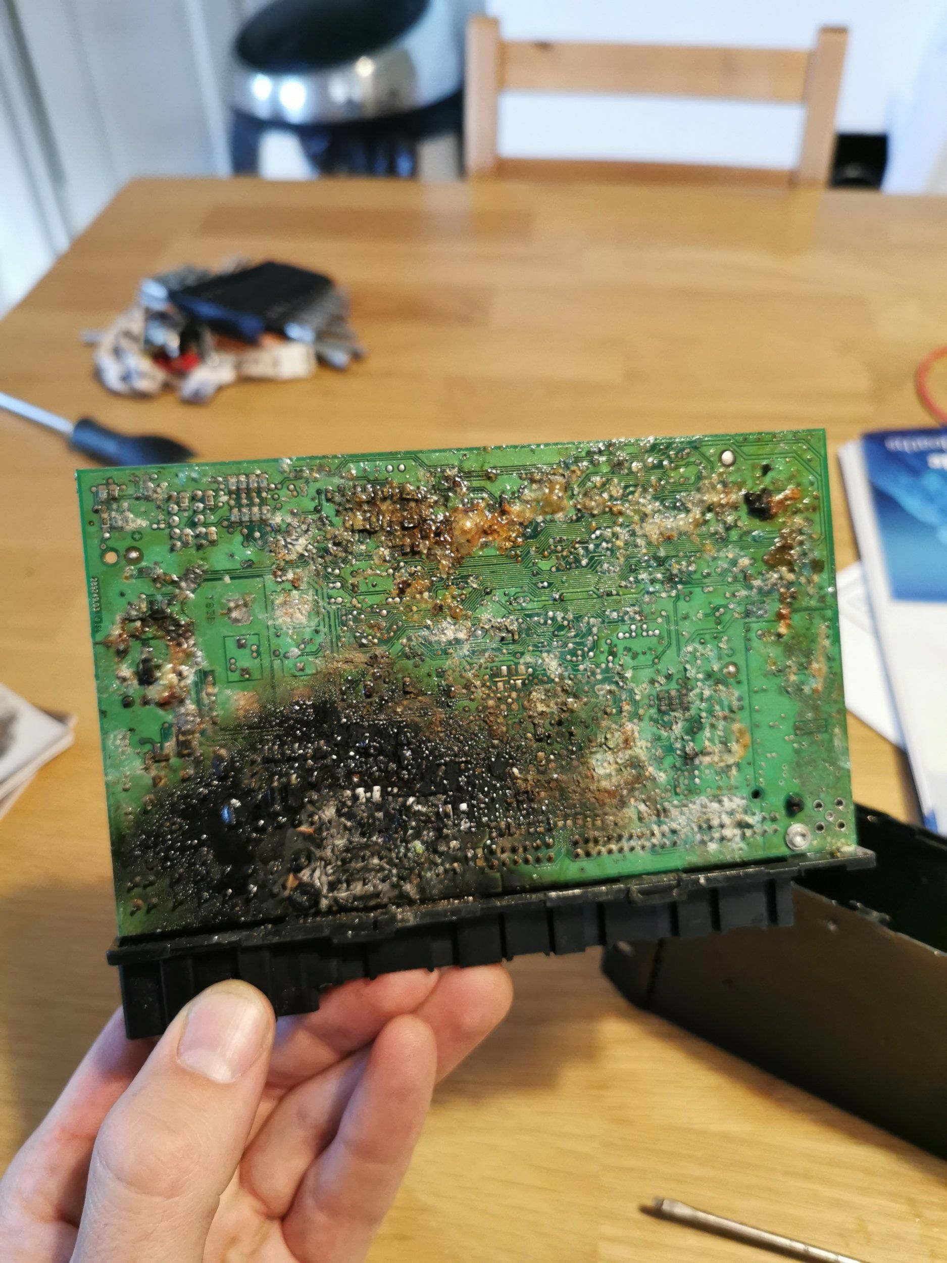

Hi all, I've been scouring the forums for an answer to my issue and whilst there are threads for some of my Exeo's individual symptoms I need help deciphering what could be causing all of my issues at once. I'll summarise the issues at the end in a TL;DR.
Basically I went away for 5 days and left my car parked my parents private drive as its a safer spot to leave it than where I live. No issues with it when I left it there. My mum drove it once whilst I was away as well with no issues.
Then, one night it woke them up with an alarm going off and all of the interior lights on. They apparently couldn't get the alarm to stop sounding or the lights to turn off even from the key in the ignition. Eventually the alarm stopped but the lights stayed on, my Dad locked the car and hoped they would go off by themselves. When he got up in the morning they were off. (Turns out the alarm sounding wasn't the normal alarm but something to do with the alarm backup batteries? as we worked out later.)
Now when I went to pick the car up after my trip it wouldn't start and no lights or anything worked and it wouldn't unlock from the key fob. The boot also wouldn't open.
So I hooked it up to a trickle charger and left it overnight. When I went back this morning it still wouldn't start and the trickle charger showed an error. So just to check it hadn't been knocked by a cat or something I reconnected it and left it most of today.
When I went back the charger was far from finished from charging the battery but the car started, I had lots to do so I figured it would charge up from driving and then I can put it back on later if needs be. I noticed the boot still wouldn't open, but also now that the none of the electric window controls worked (on any door) though the wing mirror controls worked. The dash was also showing the bonnet being open even though it was closed, and also that the passenger door was open when the drivers door was open?! After stopping and starting the engine a few times it started to show the correct door as open, but still showed the bonnet as open. So I decided to drive it and see if it sorts itself out, however before I've even gone 50 meters I notice all of the lights inside the car are coming on, fading out, coming on, fading out, and then finally stopped at a weird half-glow. The dash still shows the bonnet as open so I think right I can't drive this car and park it back on the drive.
So I think maybe the boot mechanism being broken is causing the lights to all come on and off, so I google it and find someone saying that it might need lubricating. So I open the boot from the inside and try the Seat-logo handle and its obviously not doing anything to mechanism. Except randomly maybe 30s later I hear something inside the mechanism move, but the lock itself doesn't lock/unlock. So I take it off and lubricate it and see if it works by hand and it all seems to work fine. So I figure the electrical part of the locking mechanism might be broken (the Seat logo part) so I disconnect it to see if the issues go away. They don't.
So at this point I figure I'll leave it there, charge the battery more and try and find a replacement of the Seat Logo part of the boot locking system and see if thats the issue - if it isn't I'll return the part. And literally as I'm walking away from the car thats back on the trickle charger, a strange alarm starts sounds, one I haven't heard before. Its not making the lights flash and its clearly coming from the boot area. Putting the key in the ignition and turning it doesn't stop it and all the lights are on inside. My dad tells me that thats the alarm he heard during the night. After googling this I found someone say that this can be caused by the batteries inside the alarm itself running out or something, so I set about taking the alarm out so it doesn't wake my parents up again and so I can replace them if I need to.
