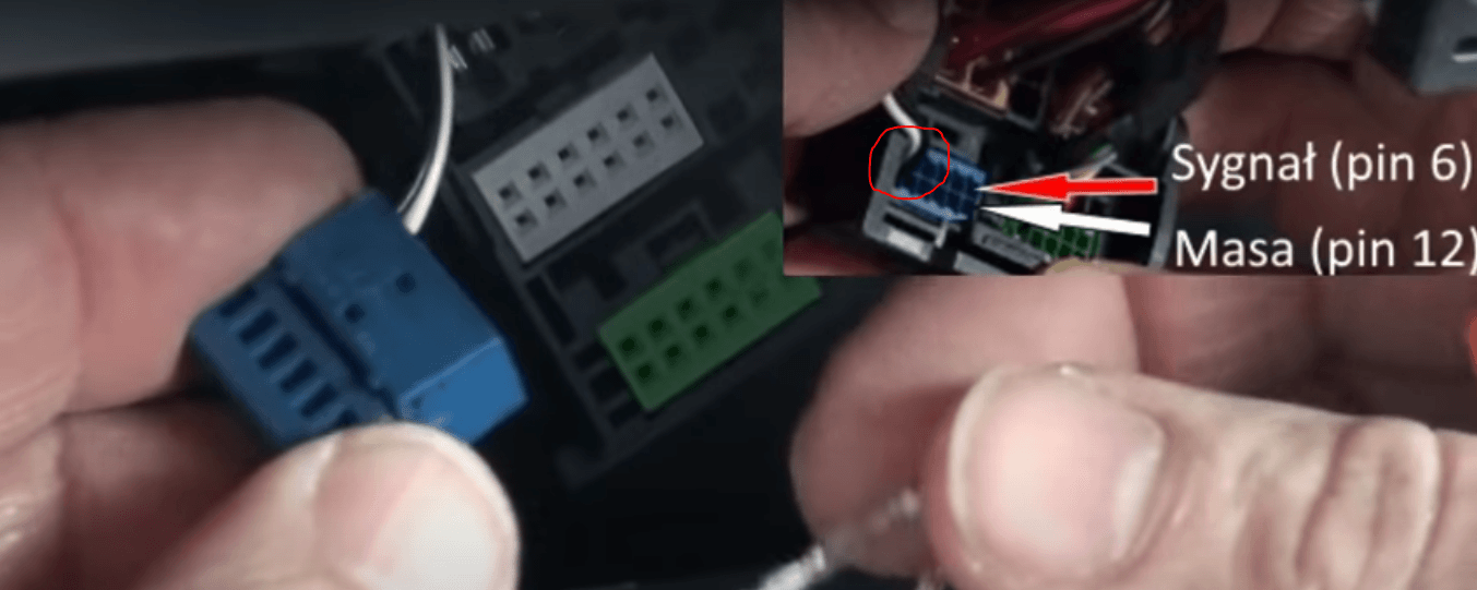

svenik
Sep 27, 2020
22
then i assume, there will be constant voltage and the cam will be always on (cam has alsom som LEDs) isnt it better to connect only to reversing light wires?
btw whats are the 2 existing cables (red circle) used for in the blue connector inside quadlock?

svenik
Sep 27, 2020
22
Hello all, i have an issue with the rvc installation, can anyone help?
i have leon st 2015 (media system plus 5.8 screen without navi + rear sensors)
So i added the pins to 12 and 6 into that blue connector...
I have the parking pilot enabled for rear sensor,s so i activated the rear camera using Carista app.
I have atm just the cheap cam from ali to try it : https://www.aliexpress.com/item/328...earchweb0_0,searchweb201602_,searchweb201603_
And now when i put it into reverse parking pilot is enabled with RVC but the picture is BLACK ( i tried the cam on TV works fine)
in car i have powered it using 12v adapter from cigarette lighter
what is the problem? can be that the pins for signal in blue connector have no contact? Or just the 5f0035824A unit is not supported for RVC?
