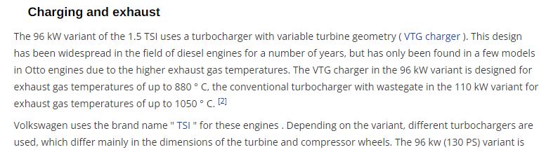

My engine has be detuned from factory stock I’ve been told, which should produce 180bhp instead of currently “130” BHP; is this usually the case during production?
Don't know who told you this but it's false.
There are two versions of the 1.5tsi EA211evo engine with with either 130ps (96kW) or 150ps (110kW). There is NOT a 180 version.
Also the 150 version is substantially mechanically different to the 130 turbo & compression ratio to name 2x important differences;
VTG turbo vs waste gate turbo and 12.5:1 CR for the 96 kW variant and 10.5:1 for the 110 kW variant.
There are absolutely some cars which have mechanically identical engines with different power ecu tunes - Volvo D3/D4, Transporter T5, etc but this 1.5 TSI is NOT one.
I would be 'cautious' with who you pick to tune your TSI.

That sounds like sales patter to me.
As I said the 1.5TSI has never been offered in a 180 tune by VAG, and as I also mentioned the 130 & 150 are really very different.
The 130 has a very high compression ratio for a turbo charged petrol engine, VTG turbo (first for a mass produced car! 911 turbo uses VTG!!) and also runs the miller cycle rather than the usual otto cycle.
not saying it can't be tuned - but if they tuner doesn't know this walk away!

No idea on the max safe power for this engine. That is for the tuning company to develop/test/guarantee/warrant?
Do your research on this engine's unique characteristics from the links I shared and ask more detailed questions rather than just what's the max power.
what exhaust gas temps do they see? are they within the safe temps for the VTG - much lower than a standard wastegate turbo!
what boost pressure? and is that safe for the very high 12.5:1CR to avoid knock and timing retard?
what warranty do they have if the new map destroys your VTG turbo due to high temps?

All engines are capable of more. I’m sure your car would be capable of 200+ hp, for a few minutes. Then something would get very hot and probably fail, and given previous posts about the fancy variable geometry turbo on the 130hp engine, that’s gonna be pricey if it does go bang. Worth it?
Your engine was designed for efficiency and not for high power applications. I’m sure there are other reputable tuners out there, but seeing as none of the tuners I would consider using offer a tune for your particular engine, I’d be skeptical of most smaller tuning companies who offer, (sorry!) because they just don’t have the budget or equipment to test tunes for engines to a satisfactory level of reliability, which on a relatively new car of significant value, has to be a priority, right?
