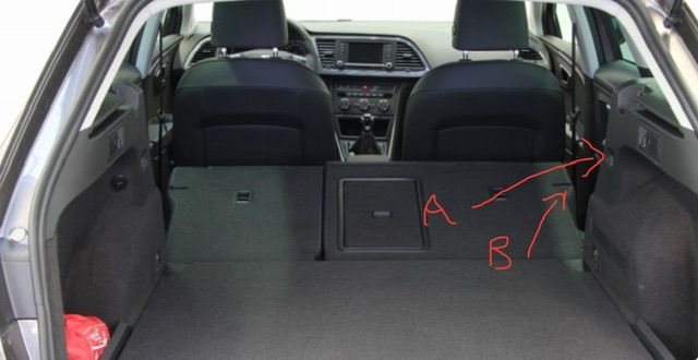

Are you sure the source of the rattling noise is actually from the rear doors? Locating the source of unwanted interior noises can be notoriously difficult, especially if you’re trying to do it yourself while driving. A common source of unwanted cabin noise in many VAG cars that’s reported on many forums is the rear seat backrest latching mechanism. Because of its proximity to the rear doors, if that’s the source of the rattling noise in your car it’s possible it sounds as if it’s coming from the doors.
I had this issue with a mk6 VW Golf I owned some years ago and an effective DIY fix is to wrap some anti-squeak / anti-rattle tape (or even electrical insulating tape) around the metal loop that the rear seat backrest latches onto when in the upright position; the tape removes any free play between the two parts of the latching mechanism so stops unwanted rattling noises - that’s assuming the latching mechanism is the source of your problem. The loop and latch are at positions ‘A’ and ‘B’ in the picture below (it’s a mk3 Leon ST in the picture, but the latching mechanism should be the same in other Seat / Cupra - and other VAG cars). If the tape wears away over time through repeated raising and lowering of the rear seat backrest, then it’s quick, cheap and easy to replace.
Please update this discussion topic for the benefit of other forum members if / when you try this fix.

Thanks for the advice, took the car out with backseats down, so no contact in the rear seats latching mechanism, the rattle was still there, so my guess its not that.
My perception is the pillar that holds the seatbelt, perhaps the rattle is from elsewhere, any other suggestion would be greatly appreciated.
